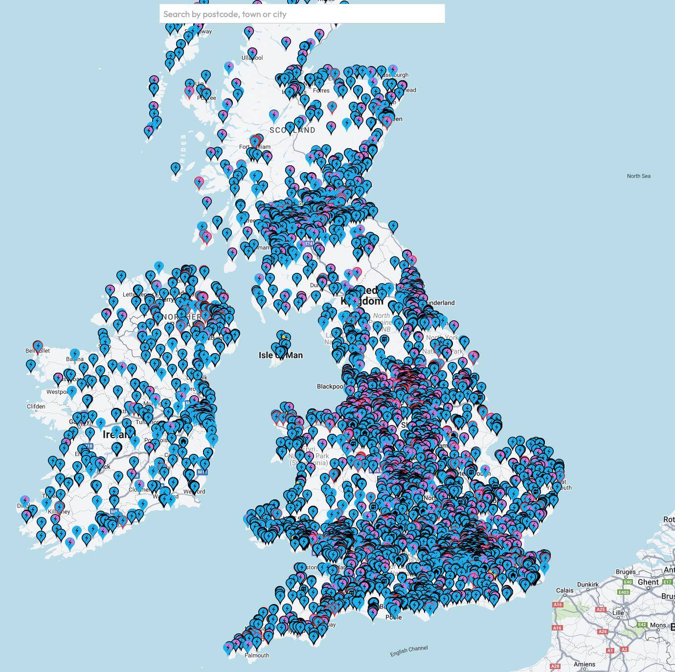

Appreciate this is not the US, but here is a snapshot of the public 22KW points in the UK.
One thing I have found useful is situations where there is a CCS/Type2/Chademo charge point. Often someone will be plugged in to the DC connector, but because I have the 22KW AC option, I can still get a good chunk of charge if I am going to be at the destination for a few hours.
