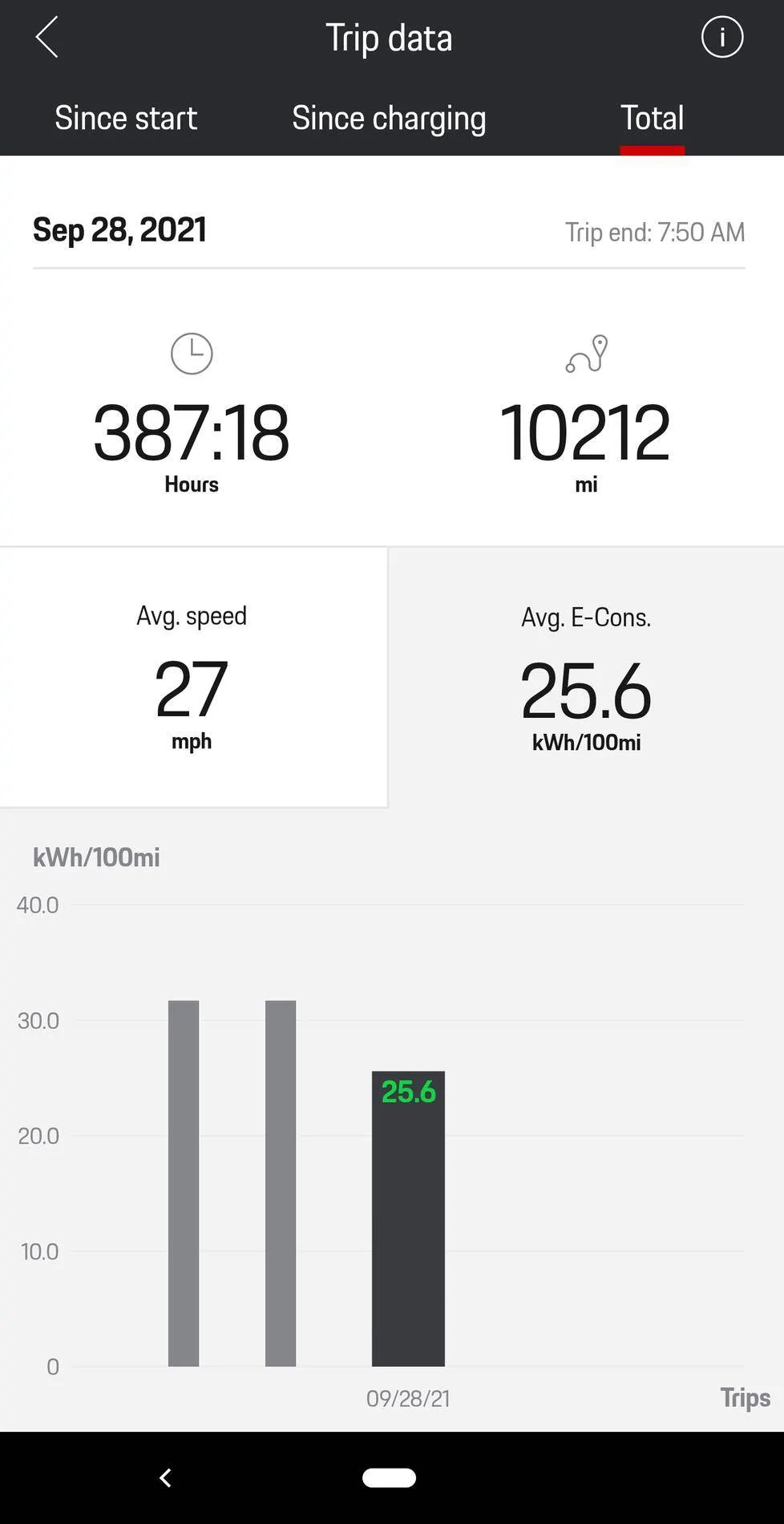

What is your average comsumption? - really nice figures, I also have 4S with +battery and 20” turbo wheels - mine only shows 207 miles @ 85%, and has been consistenly like that.. My average consumption is for the last 4188 km is 20,9 KWh/100 km (must be approx. 34 kWh/100 miles)
If I believe Porsche Connect, it is 25.6kWh/100 miles over my 10K miles. That doesn't seem right. When I look at individual days, I bounce between 28kWh/100 miles and 34KWh/100 miles.
What is your current weather conditions? I do most of my miles on highway at avg. 80-85 mph.. temp approx 20 celsius.. (avg. Approx 39kwh/100 miles when doing highway speeds)
