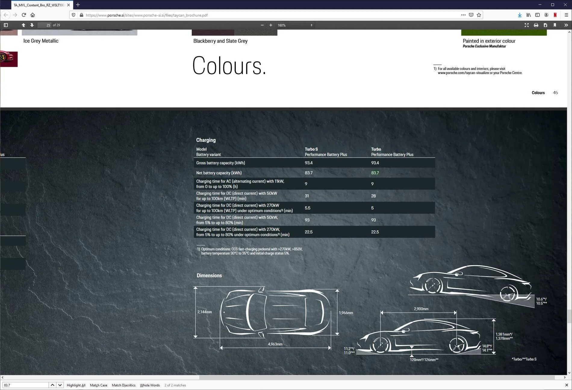

Gubbjaevel
F
Jun 20, 2020
177
255
Sweden
TaycanT'20
Gents,
The amount of capacity is displayed on "technical specifications" on Porsche configurator:
So yeah, charge to 100% and you still have 10%-ish left for battery safety.
Still, Porsche recommends (as per the manual) to charge to 85% for daily use.
They also state that charging to 100% before a roadtrip is not an issue.

It is mentioned as 83.7 kwh (actual usuable) on several sites but finding a good source was more tricky until I noticed it in the current brochure!.
Source: https://www.porsche.si/sites/www.porsche-si.si/files/taycan_brochure.pdf
So it seems to be true that Porsche hold batteries in reserve in one way or another.
However, overall I agree that 85% isn't a major problem it is just slightly irritating.

So no, you don't. That document needs to be updated. Many here and elsewhere have reported battery availability at close to 90 kWh. Porsche decided at one point in time to allow more of the battery available for use. If there ever was a top buffer, my guess is that was the time when it got cancelled / severely diminished.
