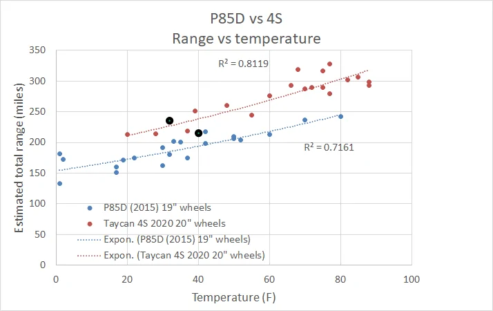

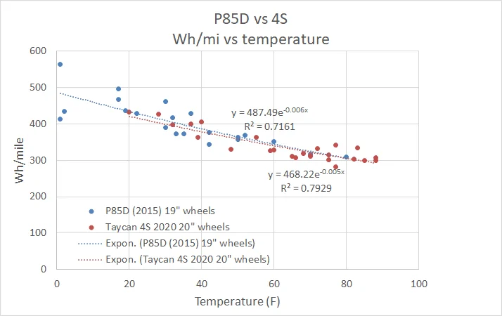

Gosh, you seem convinced about it, but that is incorrect.... I did measure and posted the results all over this forum (including on this thread - with the link to the original post). So here it is one more time
The two highlighted points are the effect of battery pre-heating and tire inflation to 42 PSI. Consumption is 5% better (over 180 miles) - part of that is less rolling resistance, part a more efficient battery when pre-heated. Just like magic - better efficiency at 32F than at 40F. That translates in a net increase in total range of 20 miles. Since most experienced EV drivers prefer to charge at 10% or less, those 20 miles make the difference.

Nice chart and I respect your math but I don't believe the conclusion is correct. What "temp" is that? Outside temp, or starting battery temp? Outside Temp does make an appreciable difference as keeping the car warm (or cool) consumes appreciable power.
Do you have the complete data table for those plots which would need to show: ambient/environmental temp, battery temp at departure, estimated range, and demonstrated range (to validate)? You would absolutely need to consider both temps (battery and outside ambient) to have enough data to draw a valid conclusion.
If you are comparing range for a 32 degree battery in a 32 degree environment vs a 50 degree battery in a 50 degree environment, then you don't have enough data. I would believe most of the range loss in a colder environment is due to the required cabin conditioning, not the starting temp of the battery. Do you have numbers for a 50 degree battery in a 32 degree environment vs a 32 degree battery in a 32 degree environment?
I've never seen any noticeable difference when starting from a cold garage vs a warm garage and I never preheat/precool any of my EV's.
Maybe the ability for a cold battery to accept regen might be marginally reduced. However, even if it was, I'm not spending much time in regen when I'm on the highway doing a long road trip.
If you've got links from industry respected/established sources which show warming a battery before departure makes any appreciable difference in range, I'ld like to learn from them...
...and not that it matters from the perspective of any benefits achieved from battery warming... ...but I don't think you are correct in stating that "most experienced EV drivers prefer to charge at 10% or less". If you are doing a road trip and waiting for 10% before you take a charge you are setting yourself up for massive failure and inconvenience at some point. My last 1400 mile EV Road Trip, I had 2 whole stations out of service for the 5 I had planned to stop at (each way). The entire station at both of these planned charger stops was completely out of service (despite what PlugShare said). All 4 terminals at one and all 6 terminals at the other. (...and calling EA couldn't get any of them working). As an "experienced EV driver" (4 cars/6 years), if I had planned to charge at 10%, I would have been plugging my travel charger in at some generic 120 or 220v outlet and delaying many additional hours. I had to travel an additional 30-40 miles down the road to the next station to get a charge. (This is where the "Experienced" part comes in...) Planning to charge at 10% on a Road Trip leaves no margin for safety. ...and if you are not talking about charging at 10% on Road Trips then I would also submit that "Most experienced EV drivers" simply plug their cars in whenever they are parked at home (ie every night) and do not wait until the level gets pulled down to 10%. (Unfortunately, folks without home chargers will not be able to benefit from this major convenience).

All temps in the table are outside temps. Battery temp for the Taycan without preconditioning is about the temp in the garage - mine is not heated, so usually just ~10F above outside temps in winter, about the same as outside in summer. Most of the trip data is with battery charged to 100% shortly before departure - but not all data.
The reason I started tracking the influence is because I assumed the heat pump will make the Taycan vs Tesla P85D curves diverge at cold temps - but so far just about the same consumption. I then remembered that all Tesla trips were with charging just before starting the trip (no superchargers in Minneapolis area at that time) and with the tire inflation at 42 PSI. That is why I decided to test the higher pressure and the charging just before departure so battery is warm - to see if the Taycan starts getting better.

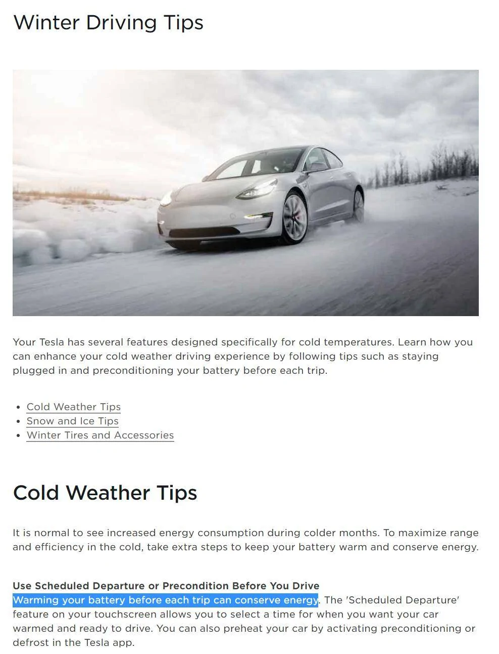

Also a Link here from Tesla on the importance of pre-warming the battery.
Then you don't have enough data to draw a quantifiable conclusion. All you are doing is proving that an EV operating in warmer weather will get more effective range than an EV operating in colder weather. I don't think anyone disputes that but the reason is mostly to hold cabin comfort.
I respect that you have a quote from Tesla that says that battery warming can conserve energy. I think the point of contention is whether it is particularly meaningful or even quantifiable.
