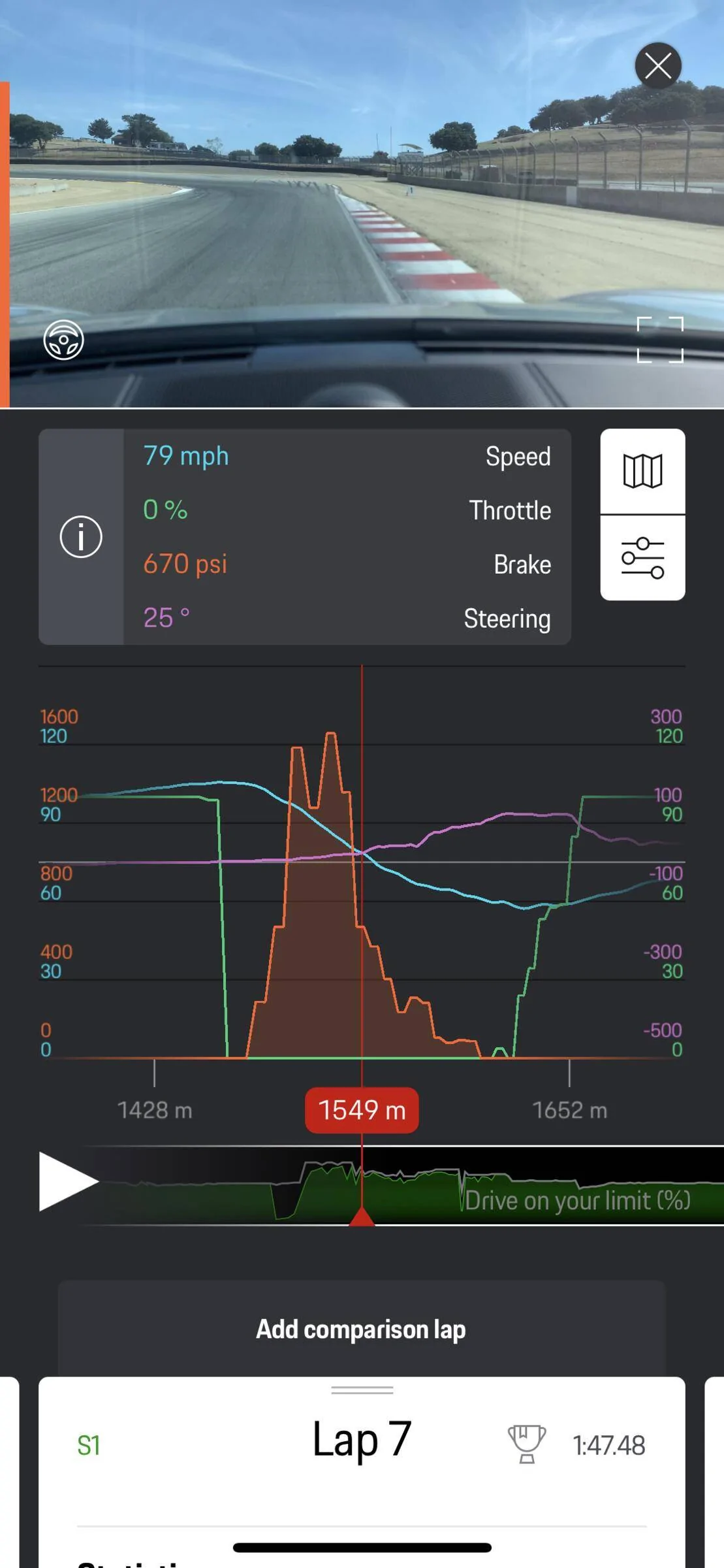

Tire compound and under-tired fronts definitely needed earlier turn in to compensate for the understeer. Still trail braking but it's asking alot from the front tires and with the size of car, not going to feel the same kind of rotation as a lighter car. Having said that, I'm pretty impressed with the suspension kinematics, made the best use of the tires. I was running about 0.6deg less camber in the rear than stock which I hope helped with the balance a bit.
I've got to play with the Track Precision app a bit more but so far it's pretty sweet having the extra channels for brake press., throttle, steering, tire pressures, SoC, PSM, etc. etc. I was about to go down the rabbit hole of CAN bus mapping with my Racecapture DAQ. Next time I'll need to figure out how to connect my Gopro to the video feed to avoid the phone camera vibration. Also, I don't see a good way to compare laps from session to session, so that is one downside.
Here's another example screen shot braking in to 5 showing some of the trail braking, throttle and steering transition.

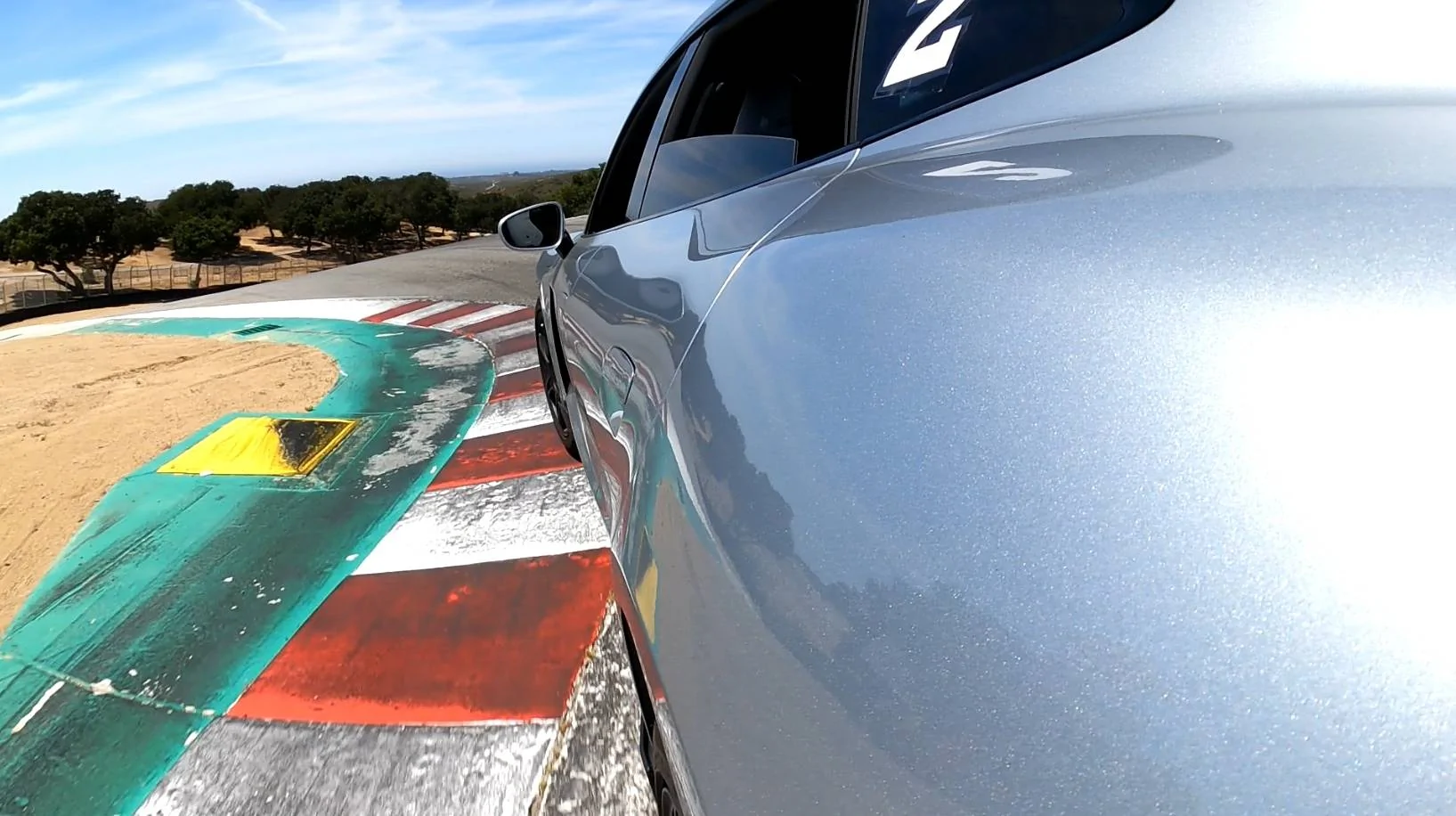

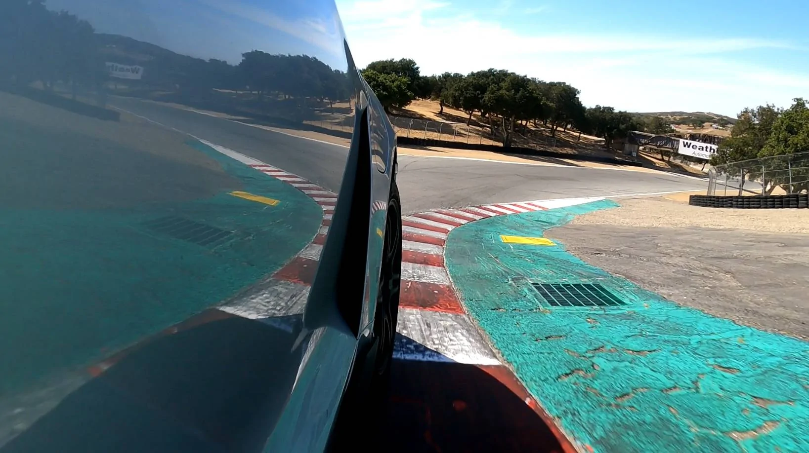

Wind buffeting when just the front windows were down. So I had to drop the rear windows too.
Some onboard shots going down the corkscrew.

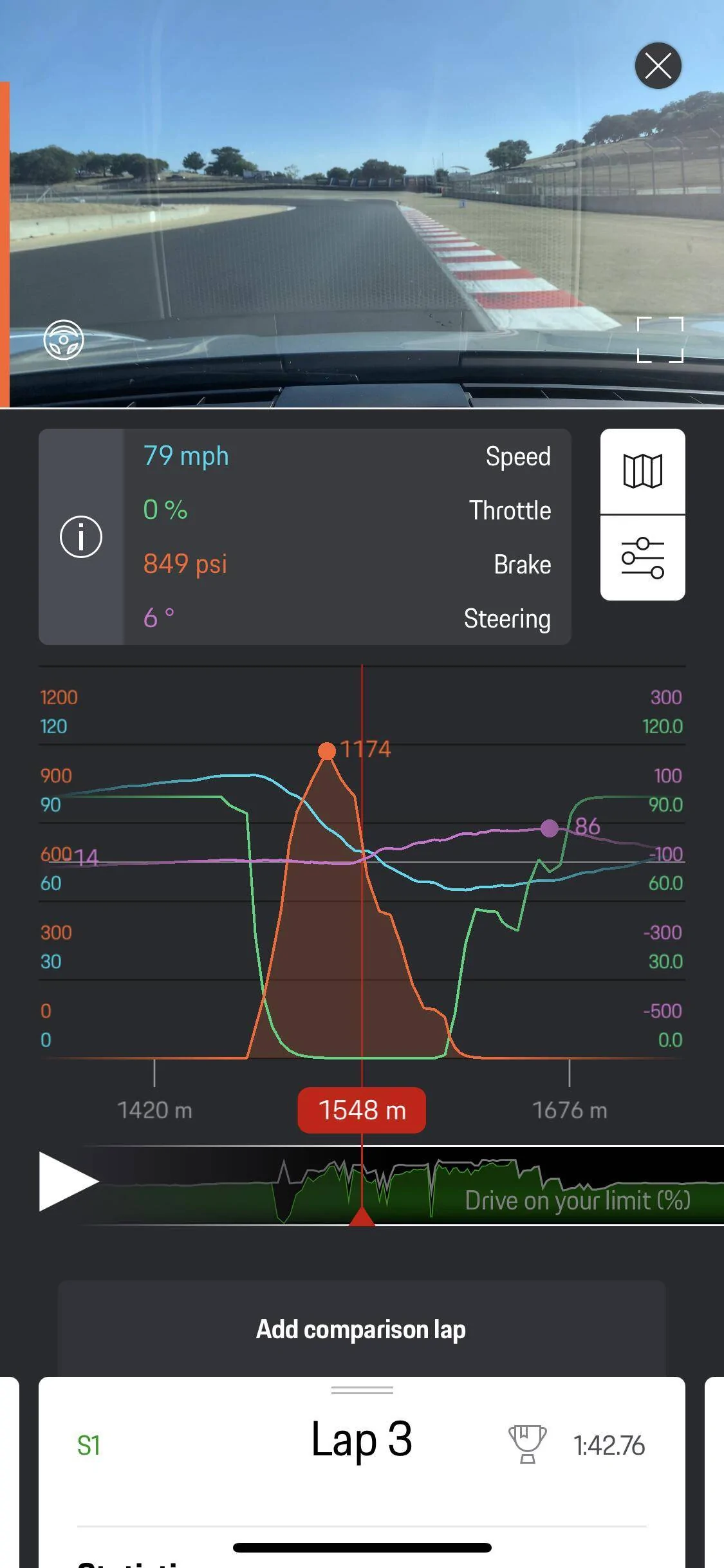

Another day at Laguna Seca. Today I decided I wanted to practice left foot braking since it’s not fair that one foot gets to do all the work. TLDR: immediately dropped 1 second off my lap times. Here’s a vid of a 1:42 lap in the 4CT.
A year ago with a fresh set of Bridgestone RE71RS I was running 1:43 on the old track surface. Was hoping to go faster today with the new asphalt but was only managing 1:43s as well so tires might be going off a bit. It was also a pretty hot day, into the 80s by noon. I had been practicing left foot braking for a while on the street but the last two track days I told myself I wanted to try. Well, I couldn’t get over the nervous feeling that my left foot just wasn’t as experienced as the right and it wasn’t until the last session of the day that I finally tried it. Lined up at the back of the group behind all the Miatas as I told myself I’d work up my braking points slowly. Started the out lap at an easy 70% pace and by the end of the lap was surprised that I felt so confident. I definitely wasn’t hitting the same braking points exactly that I was used to and immediately noticed the transitions from brake to throttle were much smoother and the car felt more settled. I would roll on the throttle earlier, vs right foot braking, I was usually trying to catch-up to the available longitudinal grip and hammering the throttle on exits. Passed all the Miata’s by the end of the second lap and was ready for a flying lap. Was super surprised when a 1:42 popped up on my first complete lap.
So, just letting y’all know, left foot braking is the way.
Here’s a turn 5 example you can compare with a post above. Notice the red and green lines crossing.
