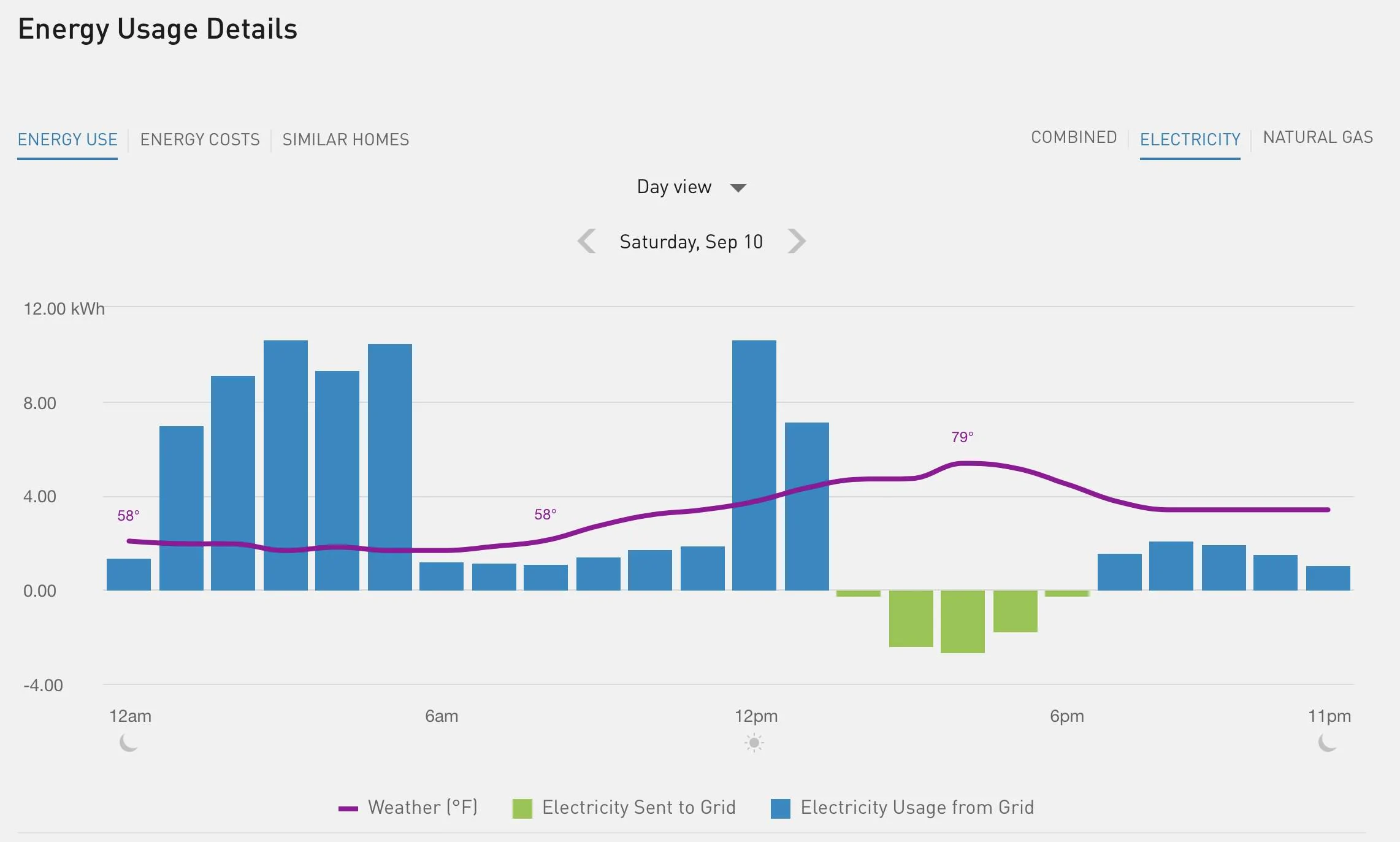

wanna guess when I was charging my EV? and what AMP setting the PMCC was set to?
here is the data -and PG&E will provide a CVS file with the raw numbers so you can really dig into the data - there are enough digital bread crumbs that if it got testy regarding liablity one could analyse the direcxt and indirect data and come to some pretty sound and convincing deductive conclusions - that with the physical evidence (even cheap NEMA 14-50 plug sockets don't melt that easily) - once can make the case what caused the event…
How does any of this show the difference between an EVSE set at 40 amps or an EVSE set to 20 amps+ 20 amp dryer running at the same time?
dryer is unlikely to be running between midnight and 4 am - and if there was an issue you'll have time of the "event" and any physical evidence - I'm pretty confident you could make the case as to what the AMP setting was and with time and physical evidence and usage patterns of the other appliances - you could come with a very plausible series of events and settings.
Forget dryer. How about air conditioning? Or hot tub? Anyone of which can switch on at any time. It’s a tough prove in my book.

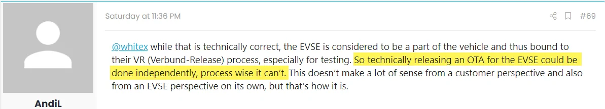

This doesn't make sense from a technical perspective either. Porsche EVSE may be charging non-Porsche vehicles (it is a standard charger, not a Porsche specific standard, not can the EVSE even reject a non-latest-version-Porsche car), it may be charging Porsche vehicles with any released version of the software. Testing only with latest Porsche firmware doesn't make a lot of sense.
That said, if what you say is true, did the EVSE OTA come with a matching car OTA update? If not, that means they didn't wait to do a combined release process, they did release EVSE only update.
That's not what the original poster said; they said the release process is the same for either car or equipment, and that makes sense. It's not just about the test matrix/qualification, it's everything else - escrow, signing, publishing etc. Nobody said the car got an update, or that the equipment is _not_ meant to work with other cars.
58
4,959
4,136
Not sure what point you are trying to make. Similarly, if you wire your PMCC to a 10a circuit breaker that your electrician signs off on and you set the charger to 16a and your home catches fire, that is also your fault.
My point is that products do exist where user can, technically, modify its settings in a way which may cause the product to be dangerous. If you want a simpler example, if you set your cruise control to 100km/h in a school zone, you are still responsible for the car speeding, even though the manufacturer let you set the setting.
PS> In the specific example you gave above the circuit breaker will trip, preventing a fire.
58
4,959
4,136
Here is what the original poster said, note the highlighted section saying not that it is a joined process where EVSE and car firmwares are tested and released together, not just having same steps but with different scope.
