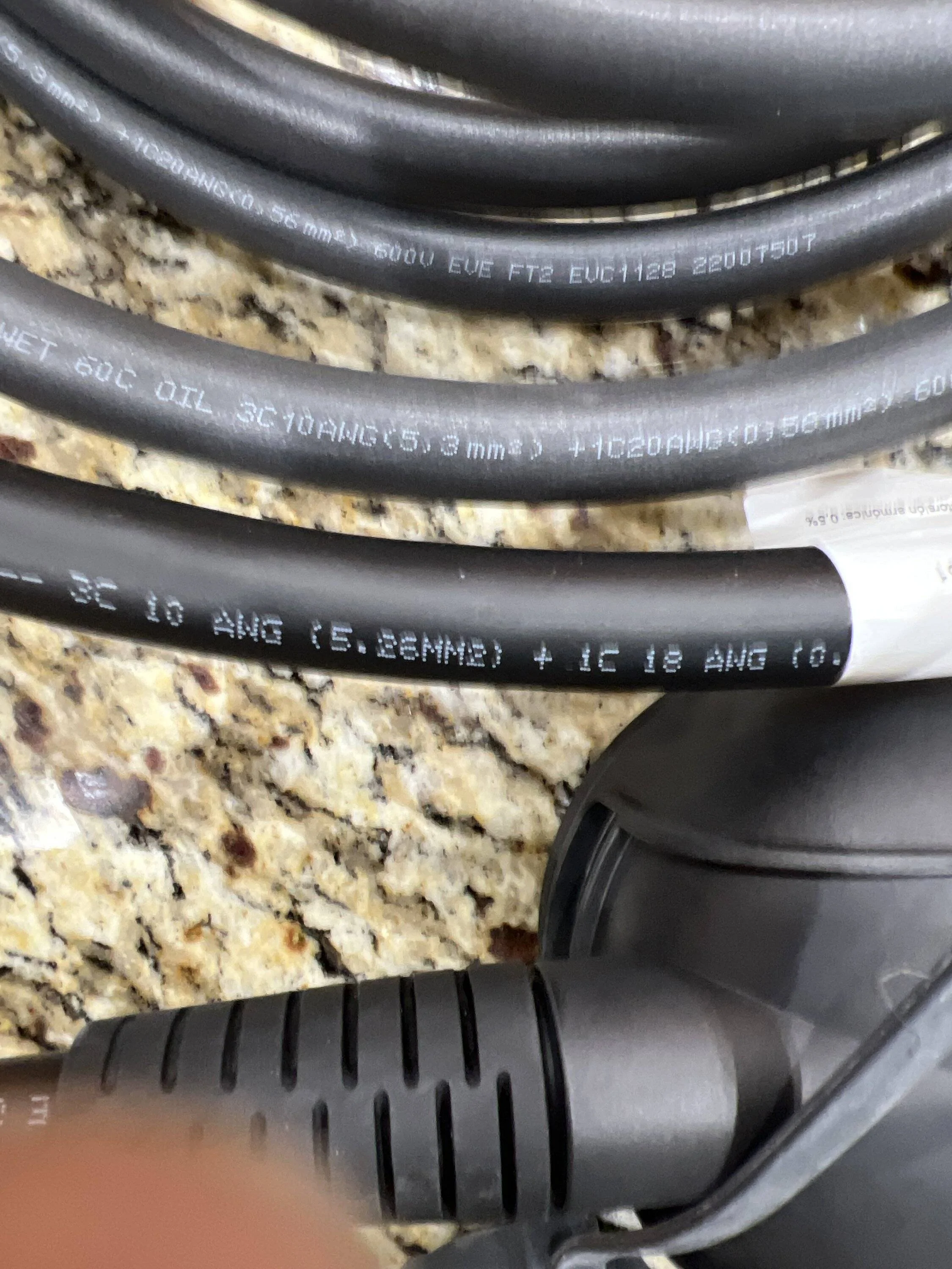

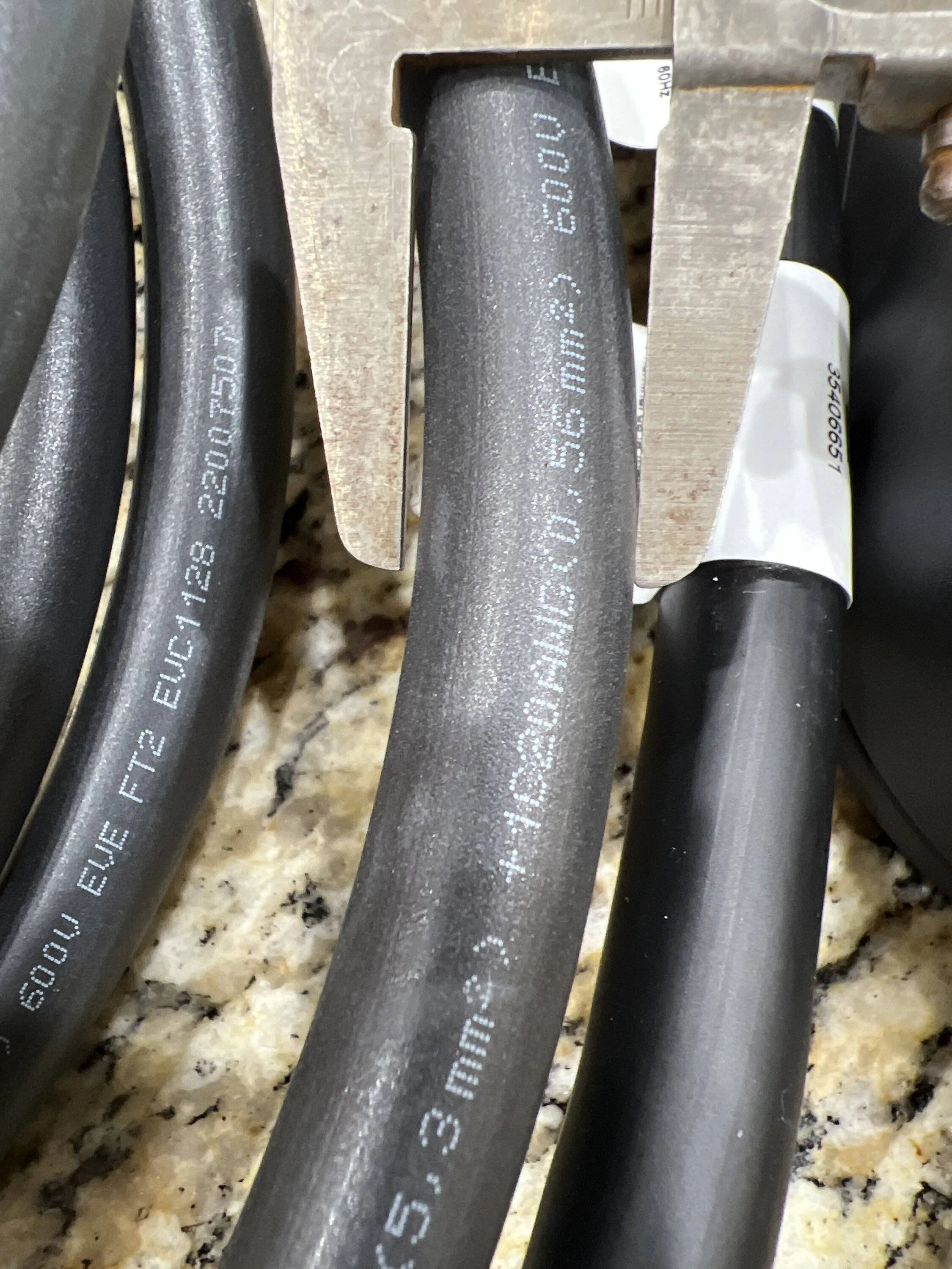

The calipers were placed on the etron wire and then on the Taycan wire. Notice the gap. The etron wire may feel cooler due to larger insulation.

thank you for doing this - I"m wondering what the difference is - nothing jumps out at me - thicker insulation would make a difference
things that make you go hmmmm
does your eTron charge at the full 40 amps?

REALLY- this is NEWS - do you have a photo of "said" unit - and which cable is "updated" - part #? is this the power supply to PMCC/PMC+ segment, or the cable segment from the PMCC/PMC+ to the vehicle.
photos of both ends of the cable (w/part number) and the cable itself would be appreciated
if you inspect the cable the wire-gauge should be embossed on the cable itself - it would be news if the wire-gauge indicated on the cable itself was not 10 AWG…
my 2021 Cayenne's PMCC still has the same physical cable as my 2020 Taycan PMCC - and 10 AWG wire…
please share details if you can - this would be news and progress in my opinion.
if there is a new power supply cable and part number - maybe we can get @snstevens to ask his CEO buddy to get us all upgrades to the newer/cooler (thermally) power supply cable.
more details please if you can.
a photo like the one in this post would be ideal if possible…
side by side photos of the two cables also might be interesting if the Audi part # is "thicker" and it would show up in the photo.
Both cars draw 36 amps. 8.8kW/240=36 amps; The Audi 8.7kW.
what does the screen on the PMCC say for amps?
in car reports power "at the battery" which will be less than the "raw" power "at the wall".
I do not have the charger with display screen. It's possible the the quality of the wire in the Prosche charger has more resistance than the etron unit?
My CP Flex Home charger says 9.4kW going to the car. So 9.4/240= 39 amps at the 14-50 outlet.
that would be inline -with expectations - 9.6 @ the power outlet (like your flex charger) should yield the numbers you are seeing in vehicle
I wonder why the Audi charger is "running" cooler - any temp measurements after an hour or so of charging
something like the following comparing the two would be interesting.
you can just share the numbers if you feel like I t- I"m most interested in the "supply" cable temperatures and ambient temp at the time of measure
this is 100% optional but if you're willing I"m sure we'd all appreciate the data…

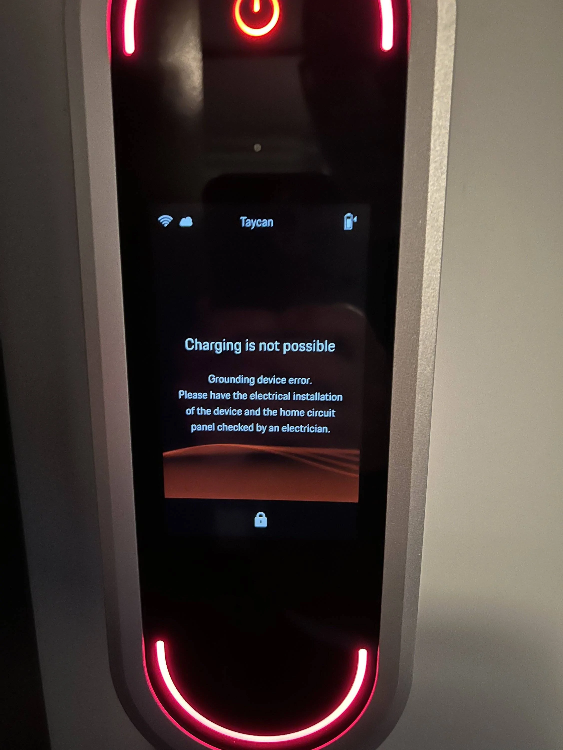

Been flawless for 15 months. Now after this latest software update I continuously get this error. So frustrating
If it works like the PMC+ does, there's a toggle to check grounding or not. Perhaps that was off before the update, and is now on?
In either case I would contact the electrician and have them check it as suggested. Better safe than sorry.
