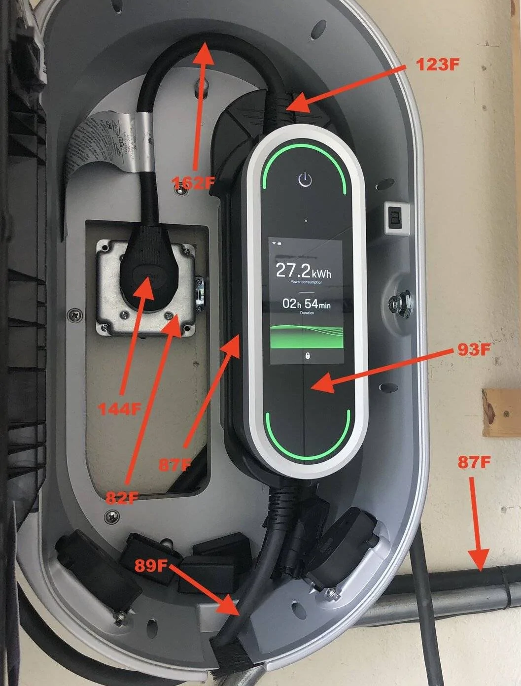

that would be inline -with expectations - 9.6 @ the power outlet (like your flex charger) should yield the numbers you are seeing in vehicle
I wonder why the Audi charger is "running" cooler - any temp measurements after an hour or so of charging
something like the following comparing the two would be interesting.
you can just share the numbers if you feel like I t- I"m most interested in the "supply" cable temperatures and ambient temp at the time of measure
this is 100% optional but if you're willing I"m sure we'd all appreciate the data…
I will run some tests this afternoon and report back later today. I have the Porsche charger running now for a baseline. The pigtail and plug are not an issue at all so far. The highest temperature is the wire near the J772 plug, about 25 degrees higher than the plug after nearly an hour.
25F higher than ambient is no big deal and in line with expected behavior of the best electronics for 9.6 kW of power…so this is good news
my temps are consistent with the photo I posted 2 years ago - the only issue is the power supply cable from Porsche - all other components are nominal thermals for what is going on during charging.

Can you check to see if your pictail is the same as y photos? 40amp rating? Do you run that charger totally enclosed?
mine are same/very-similar -one PMCC I run in the Porsch enclosed dock - and the other I run "open air" - the one in open air has slightly lower temps than the enclosed one - but still more than expected rise with alternative EVSE's - pics of my supply cables can be found in this thread…
https://www.taycanforum.com/forum/threads/nema-14-50-supply-cable-heat-data.1940/
Here are my observations running both the Porsche and Audi chargers on the Taycan. The car showed 86 degrees abient temperature, i'm in central Florida.
Porsche charger: Plug 113F, Pigtail at the charger input 113F, Wire @J1772 connector 125F.
Audi e-tron charger: Plug 107, Pigtail @ charger 100F, Wire @J1772 connector 108F.
BTW: Before the '21 e-tron I had the '19 e-tron which had a hot plug, measured 150F on the blades of the plug. There were a lot of posts last summer on the Audi forum about plugs running hot and sometimes melting.
Hope all this helps.
