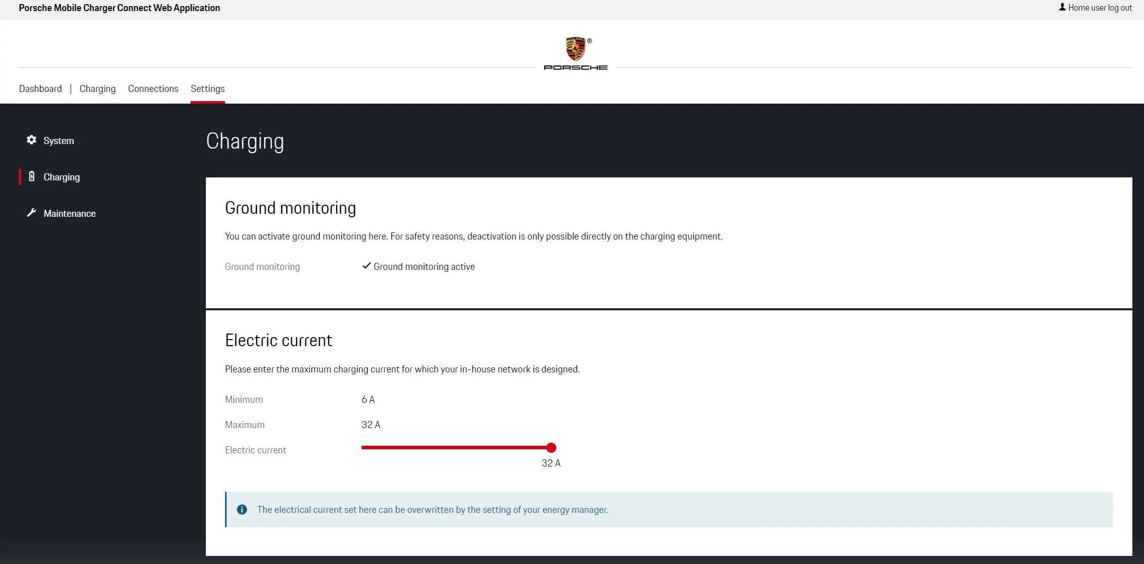

I just checked my PMCC settings as it updated yesterday morning, I had not read up about the update in this thread yet. My maximum charging setting is still at 32Amps which equates to 22kw at 400V 3-phase here in Europe. I have the option for the 32 amp industrial 5-pin connector, so no downgrade for me. Makes sense because the input wiring is much thicker and is cool to the touch when charging at 16 amps in 42º degree weather and with the Porsche Charging Dock closed. I do not have 22kw charger in car as it was removed from my order while Porsche resolved issues.
Yep - update this morning and no apparent difference and still retains my 32A setting on a single phase supply.
