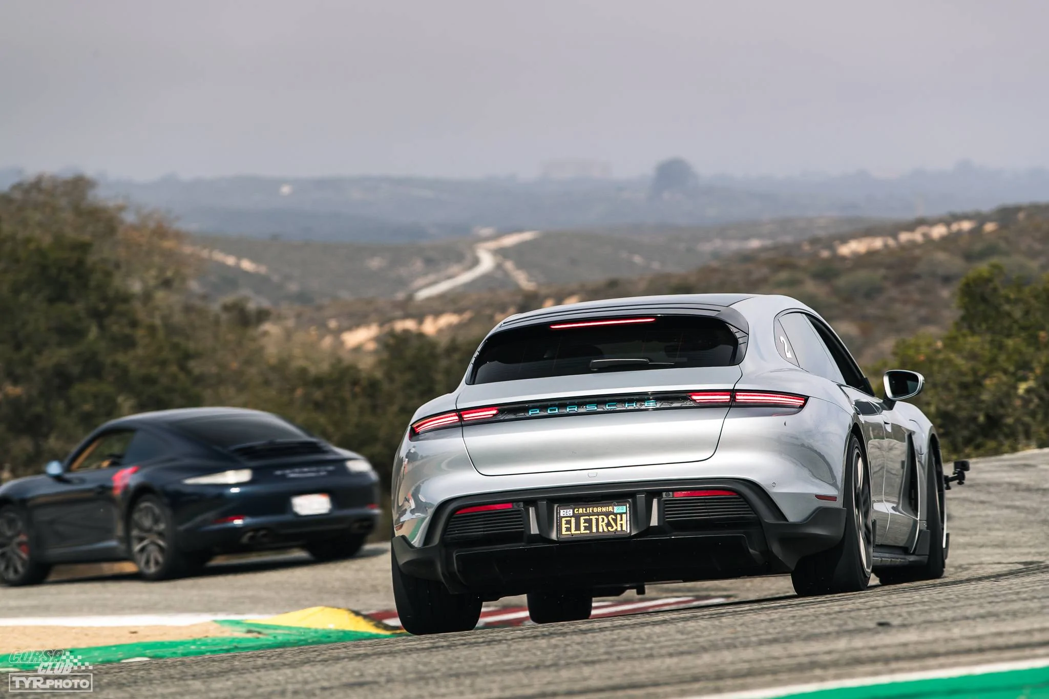

If OP is looking for value for performance, I would suggest saving the money from PDCC and putting it towards a stickier set of tires like PS4S or the like. That would have a significantly more noticeable effect when driving aggressively at the limit.
Body roll on a non-PDCC is not a lot to begin with due to the low CG so the benefit of decoupling roll and ride rates is going to be less than say on a Cayenne or Panamera. Having said that, if you can afford it, you will definitely be happier spec’ing it. Just don’t forget to upgrade tires too.
My avatar is a mid corner shot around 1.0g lateral accel, and below about 1.2g, without PDCC for reference.
