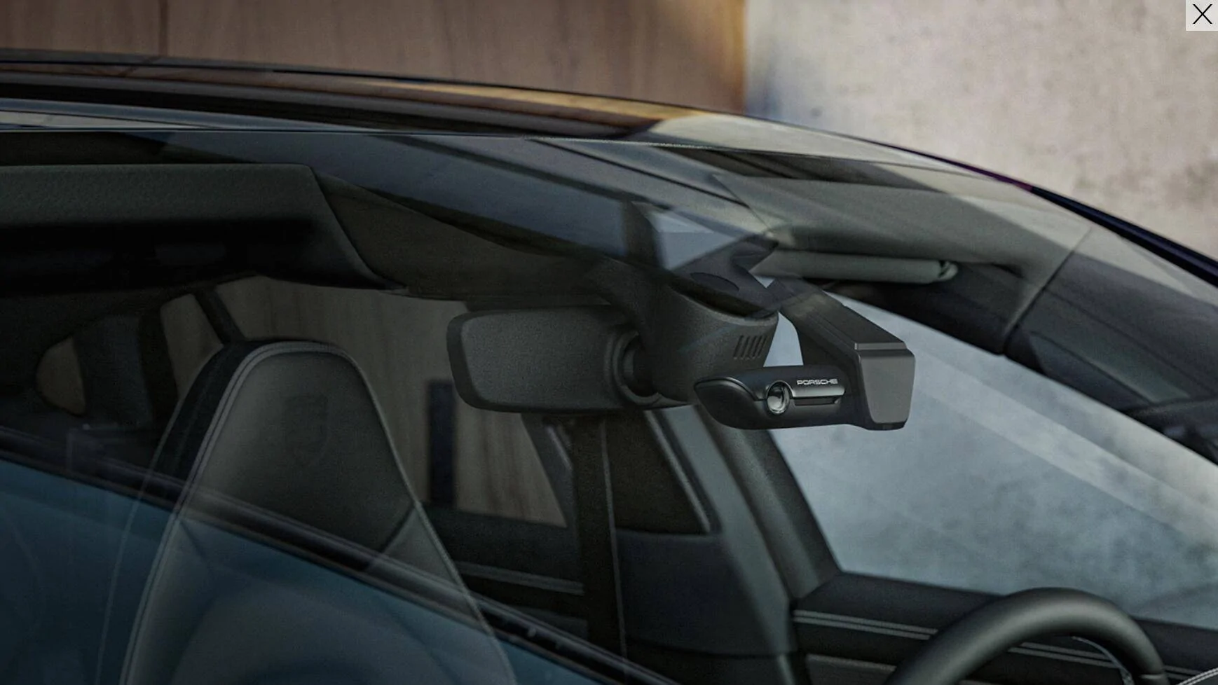

So why aren't people installing the OEM camera in this location? This looks low enough to be mostly obscured from the driver's view. I think it looks kinda out of place on the right side high or the left side high.
I'm going with this camera after getting a FitcamX that didn't work, and subsequent cold feet.
This install spot looks pretty clean to me, what am I missing?
Definitely interested in your installation experience. I think the location is just fine. While not as sleek as FitcamX or BlackVue, it’s not bad at all… and I’d like to take advantage of the pre-wired configuration option.

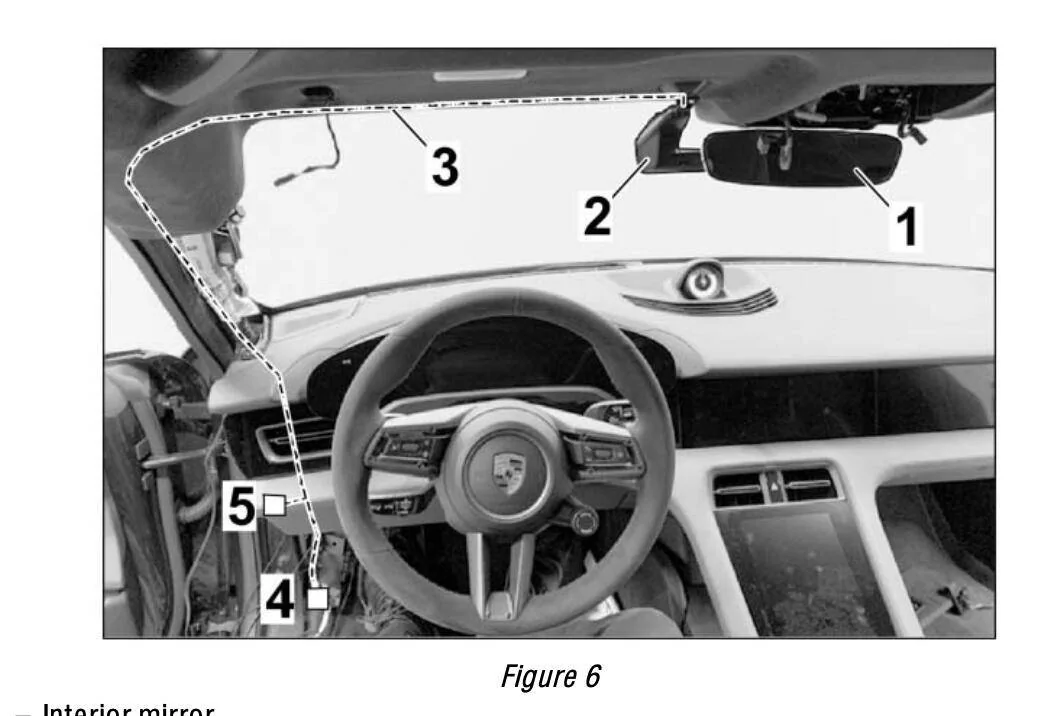

All the install pics I've seen have it in weird, obtrusive spots. Even the installation manual has it in a weird obtrusive spot.
I hope they will put it where I want, as depicted in that photo. It will be mostly out of my sight, centered on the car, and looking decent.
I think thats the problem. You get an official install from Porsche Centre and the camera is going to be placed half-way down your windscreen.
I don't understand why they'd suggest this spot in the install instructions:
Porsche Taycan Porsche Dashcam Installed - Review and Overview for US Taycan Owners Screenshot 2023-01-25 at 8.07.18 AM
And advertise this one, which is so much nicer and probably barely even visible from the driver's seat:
Porsche Taycan Porsche Dashcam Installed - Review and Overview for US Taycan Owners Dashcam Install Spot
I will definitely report back. I plan to put blue tape where I want it and discuss it with them fully before they start the work. Just waiting on its arrival as Suncoast is backordered.
So here is my hunch: They have determined there is a 0.00001% probability that the dash-cam has a chance of interfering with the driver assistance systems/safety camera that is in the same area. Perhaps the dash-cam uses infrared light to focus or something.
And so – in typical OEM/Porsche fashion they've decided to eliminate that risk by installing it where they do.

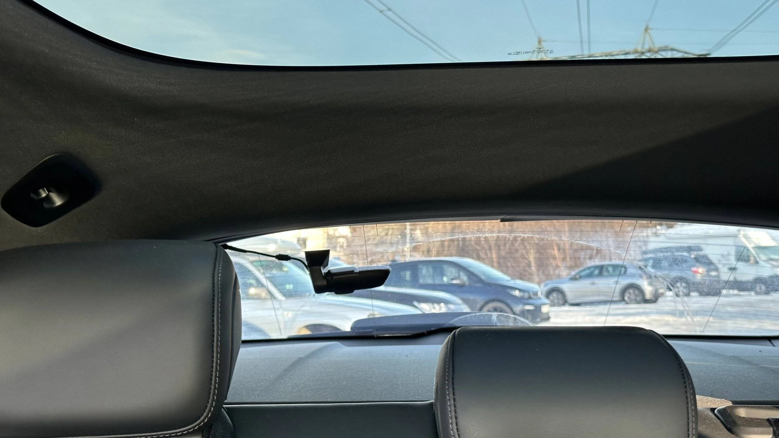

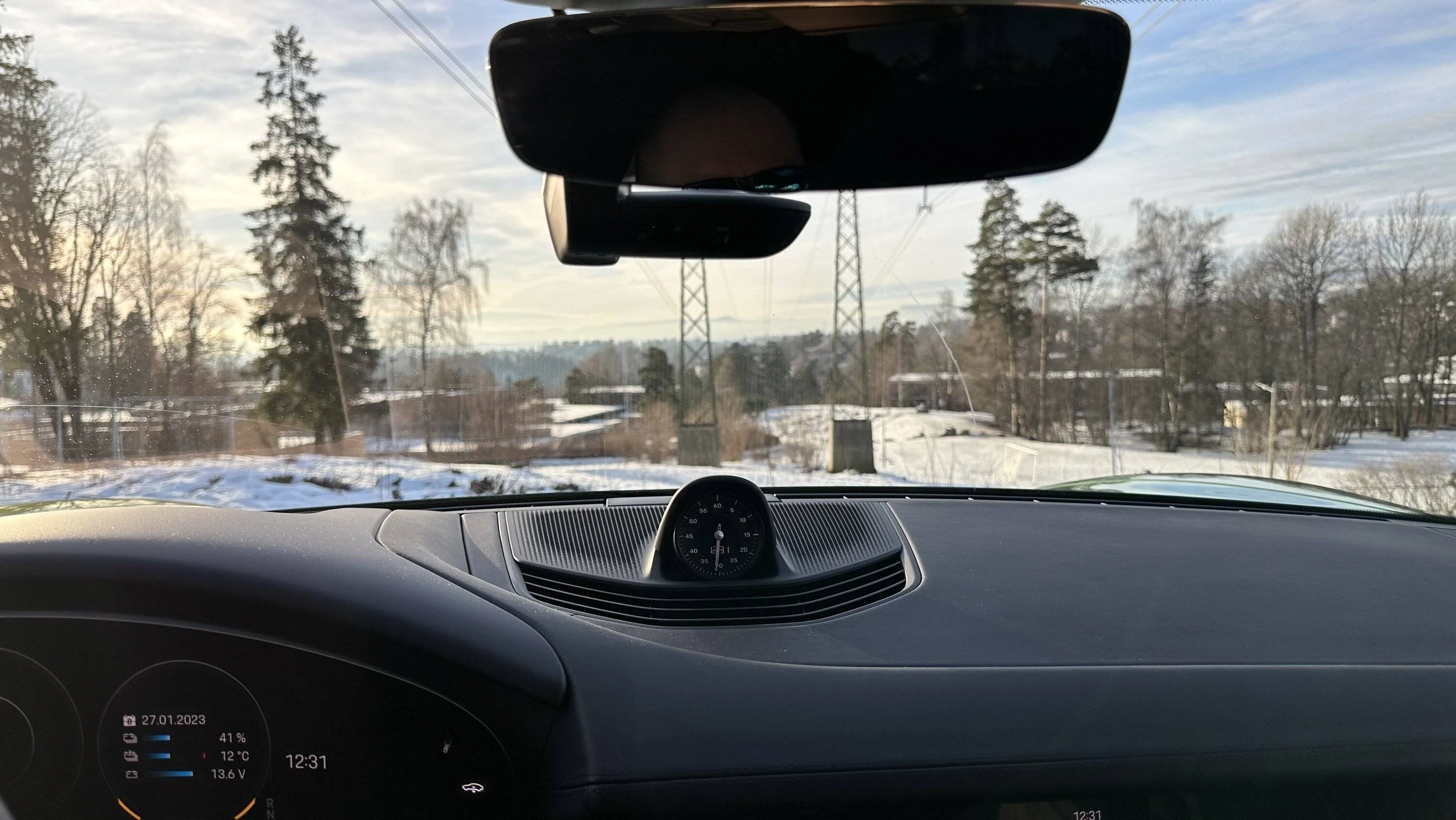

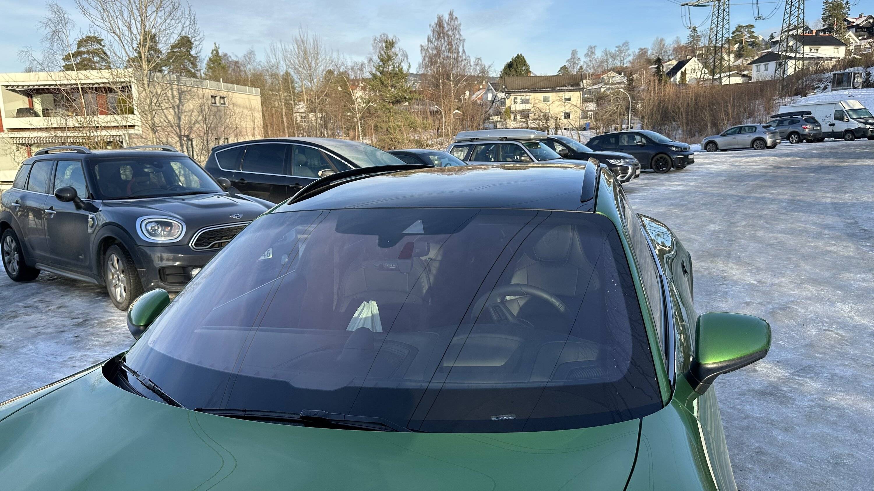

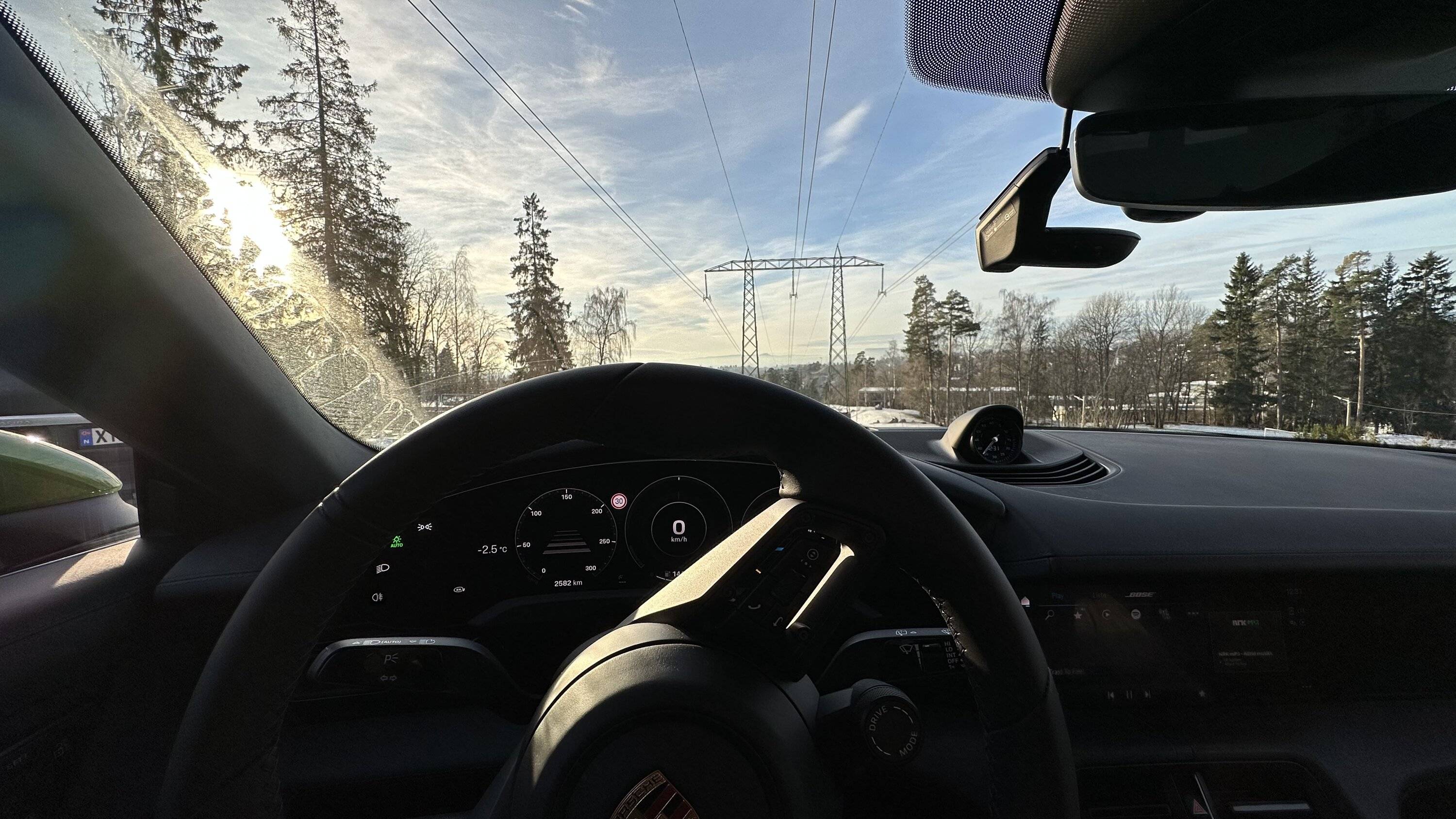

I just got the Porsche dashcam installed front and back on my 2023 CT4. Works great so far.

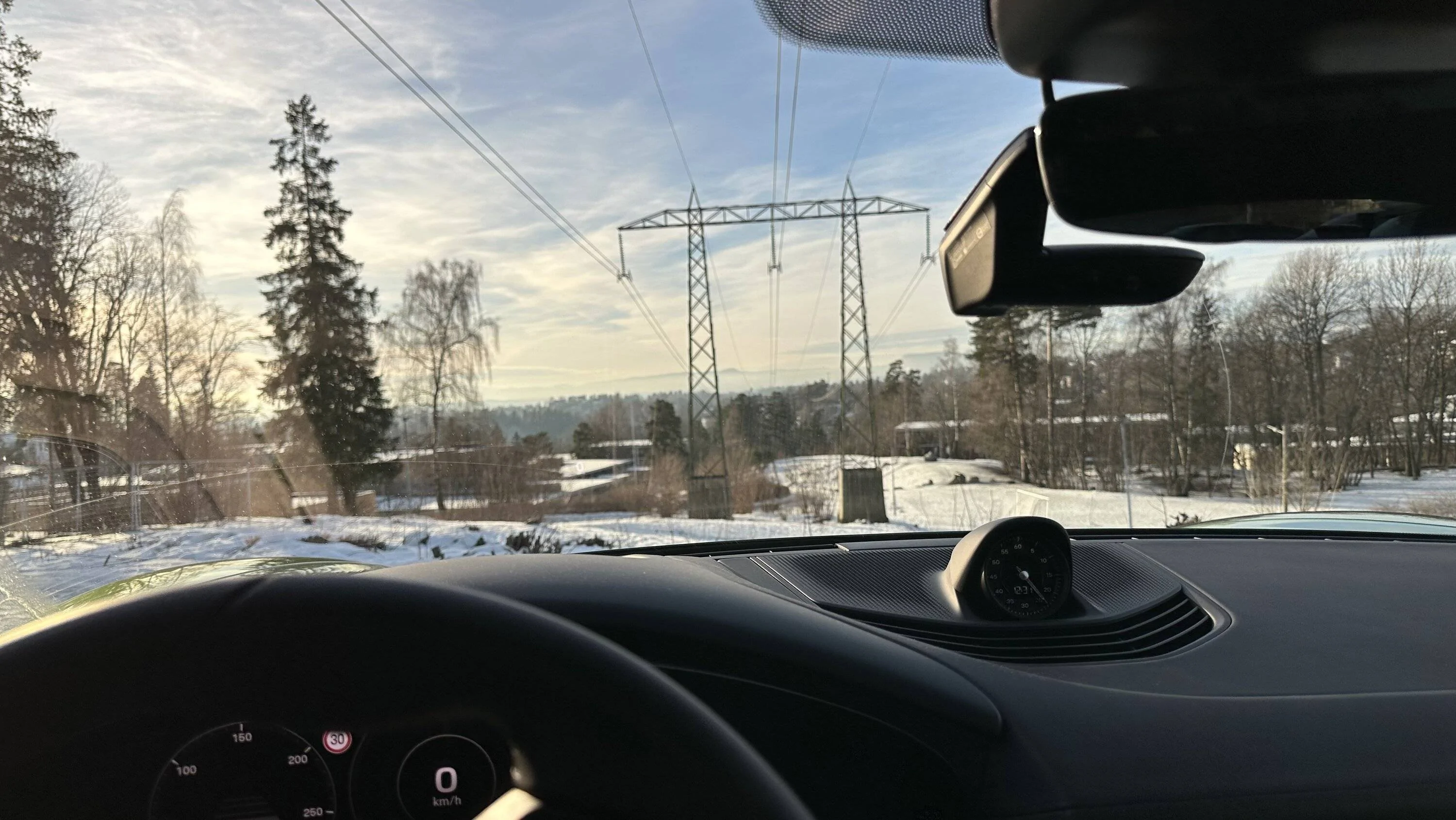

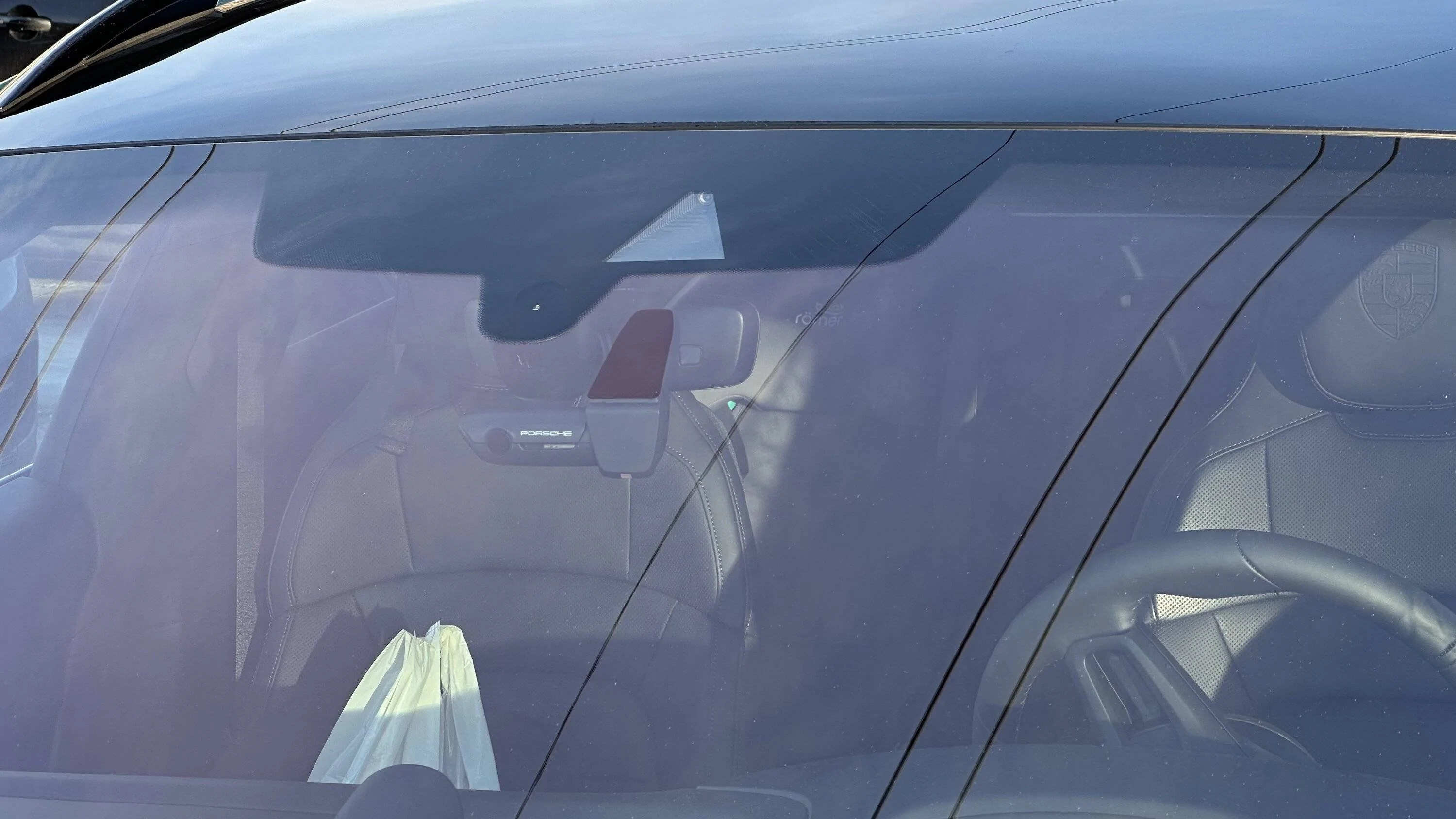

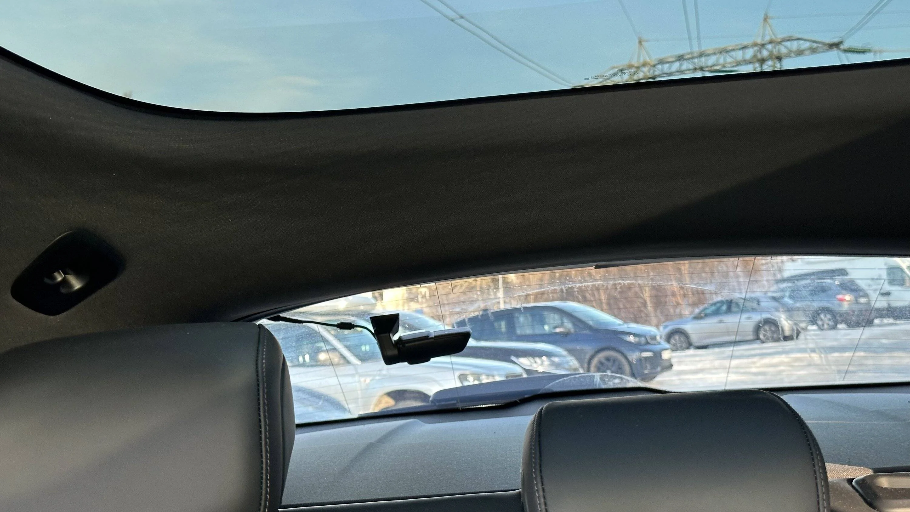

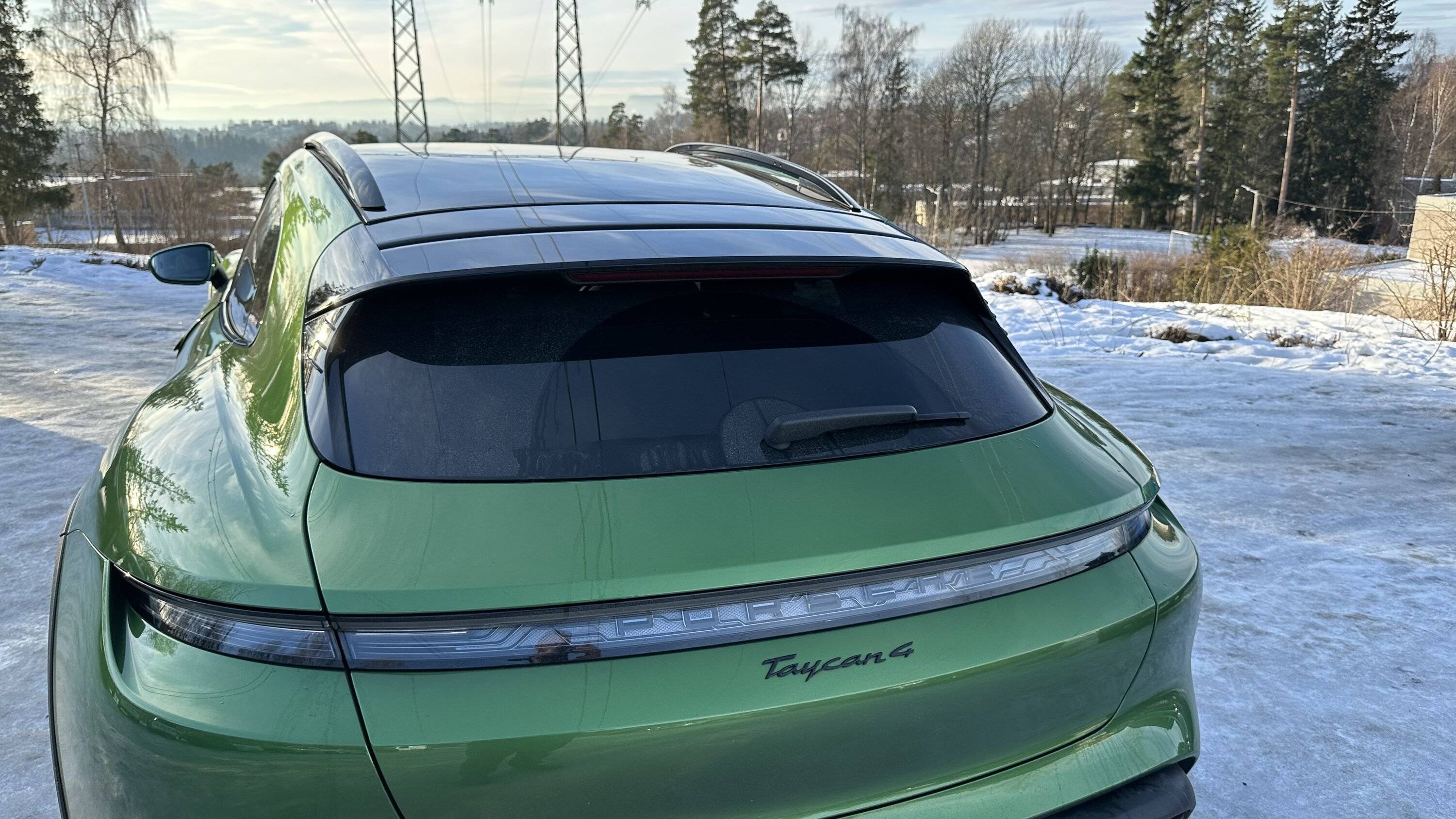

You CAN use wireless CarPlay as usual with the dashcam installed.
They way I have set it up is that is uses it's own Wi-Fi so I can access that from the phone (the default config). It is not connected to the cars Wi-Fi. That way I can use CarPlay as before.
The only problem I have had is that CarPlay with override the Wi-Fi setup on the iPhone when you connect to the camera Wi-Fi and you have to reconnect. I disabled CarPlay on the phone when I need to access the camera if this problem comes.
The Porsche Dashcam app is not the best but it does the job.
I had the car delivered from factory with the pre-wiring for dashcam. They dealership said they would use 3 hours to do the install. But they used more time since they had some problems and was missing some cables. They had the car for a day and a half since they had to wait for the cables from another dealership. But I only paid for the 3 hours that was in the offer they gave me.
It was costly, about $1460 in totalt for the front and back dashcam with installation and so on. But seeing Porsche is a pain in the ass with warranties it's "worth" it. The cameras itself was just $500. On top of that in Norway we have a 25% VAT.
The partsnumbers they used is listed here:
9Y0044951 (cameras) $500
9Y0044955C (cable set for camera) $35
9Y0044956 (cable set for camera) $35
9Y0044956A (cable set for camera) $35
The installation is ok enough.
EDIT: Photos attached
Porsche Taycan Porsche Dashcam Installed - Review and Overview for US Taycan Owners 8BF817F0-BDE6-4B98-859A-F06202E04007
Porsche Taycan Porsche Dashcam Installed - Review and Overview for US Taycan Owners C2CA3134-DB49-4C72-907E-A0B91587068F
Porsche Taycan Porsche Dashcam Installed - Review and Overview for US Taycan Owners F18EE941-0DBB-42AD-A1B2-E8C9565B9FE0
