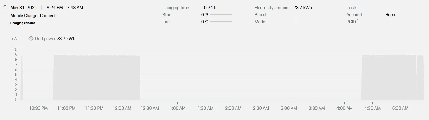

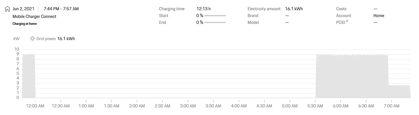

Wondering if anyone else sees the inconsistency that I do with profiles. The car charges to the correct target SOC, but charges at random times outside of my 12-6 preference.
I have one timer, set to 8AM daily, 80% target, and 70F. That works, the car is at 81% at 8AM and is 70F.
The problem is no matter which profile I choose, general or location based, both with preferred times 12-6, the car appears to be charging outside those times. The minimum charge is set at 25%, and car wasn't anywhere near that. Here are some examples:
Porsche Taycan Preferred Charging Times Being Ignored? 1622728972046
Porsche Taycan Preferred Charging Times Being Ignored? 1622728877098
Car is a 2020 with WMA5/7 done. Any thoughts? I get off peak pricing 11PM-6AM, but don't want the car to be preconditioned till I get in at 8AM. Not sure if that's the problem?

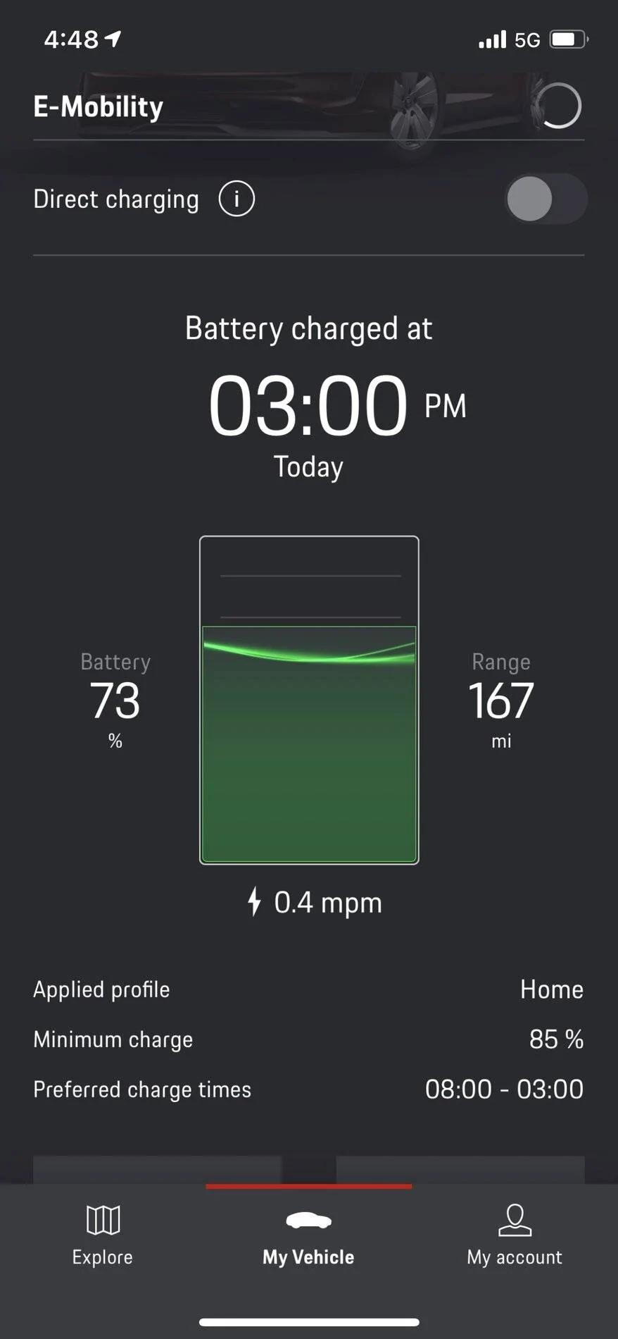

I am seeing the same bug and have reported it via the customer support email.
My Preferred charging time is 8pm to 3pm the following day to avoid the 3pm-8pm peak rates. I plugged in at 4:45 expecting it to wait and it immediately started to charge.
I have the same issue as well.

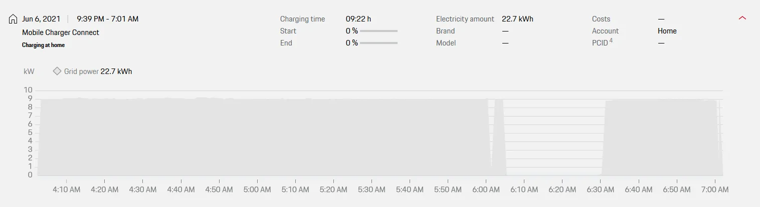

So I did what was suggested by @NC_Taycan , no profile and just timers for 6AM and 8AM. And it worked, until it didn't!
The car didn't start charging till 4AM, and charged to 80% SOC right around 6AM. Great!
But then it randomly continued charging after 6:30AM until I realized and cancelled it after 7AM. Was at 85% with no signs of stopping before I killed it.
Porsche Taycan Preferred Charging Times Being Ignored? 1623071689993
Maybe I need to set the 8AM timer as charging also to an 80% target so it doesn't keep charging?
