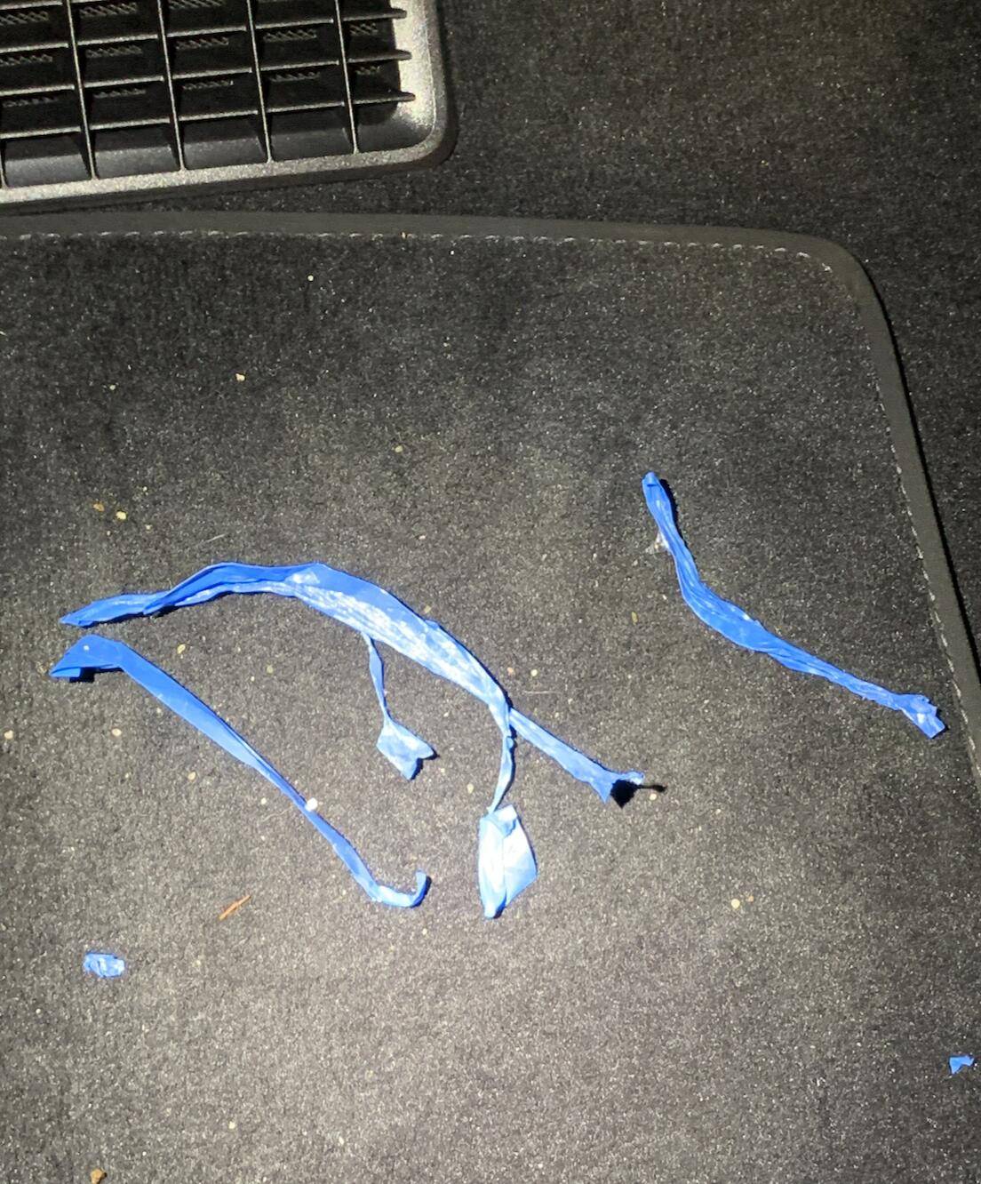

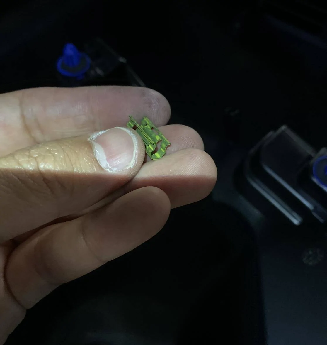

So I decided to forego the dealer and address the rattle myself.
I have many reasons why I decided to take the risk, which I won't waste your time explaining, but in the end, I found a satisfactory result.
Here's what I found.

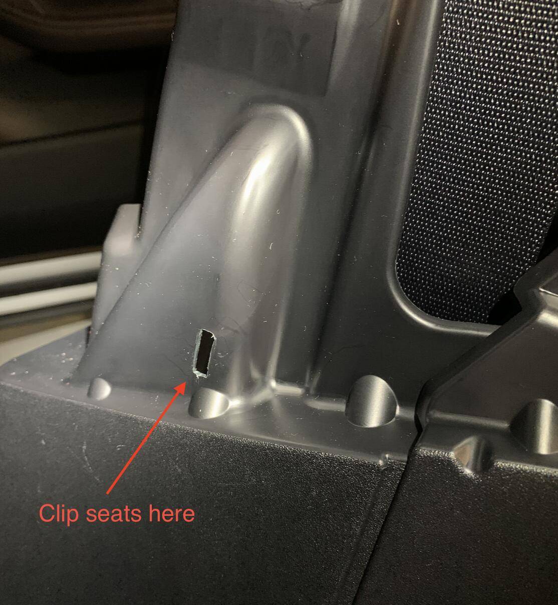

1) B-pillar clip which appears to be anodized in green was rattling in its housing. The male tab on the plastic B-pillar trim was dented, suggesting that the tab and clip were not connected.

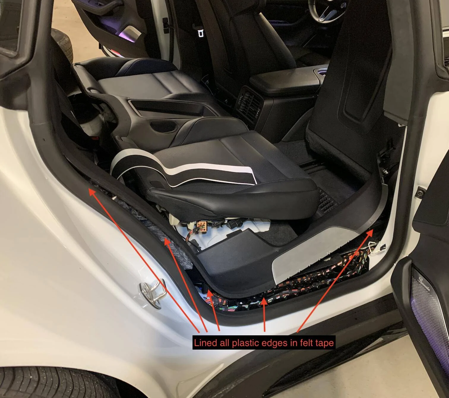

2) Lots of blue tape; not sure if its purpose is to minimize rubbing or if its purpose was to provide protection during shipping. Either way, I removed it all and replaced it with felt tape.
3) There is an awesome wire-harness channel along the floor to run wires for those who wish to install rear dash cameras, etc.

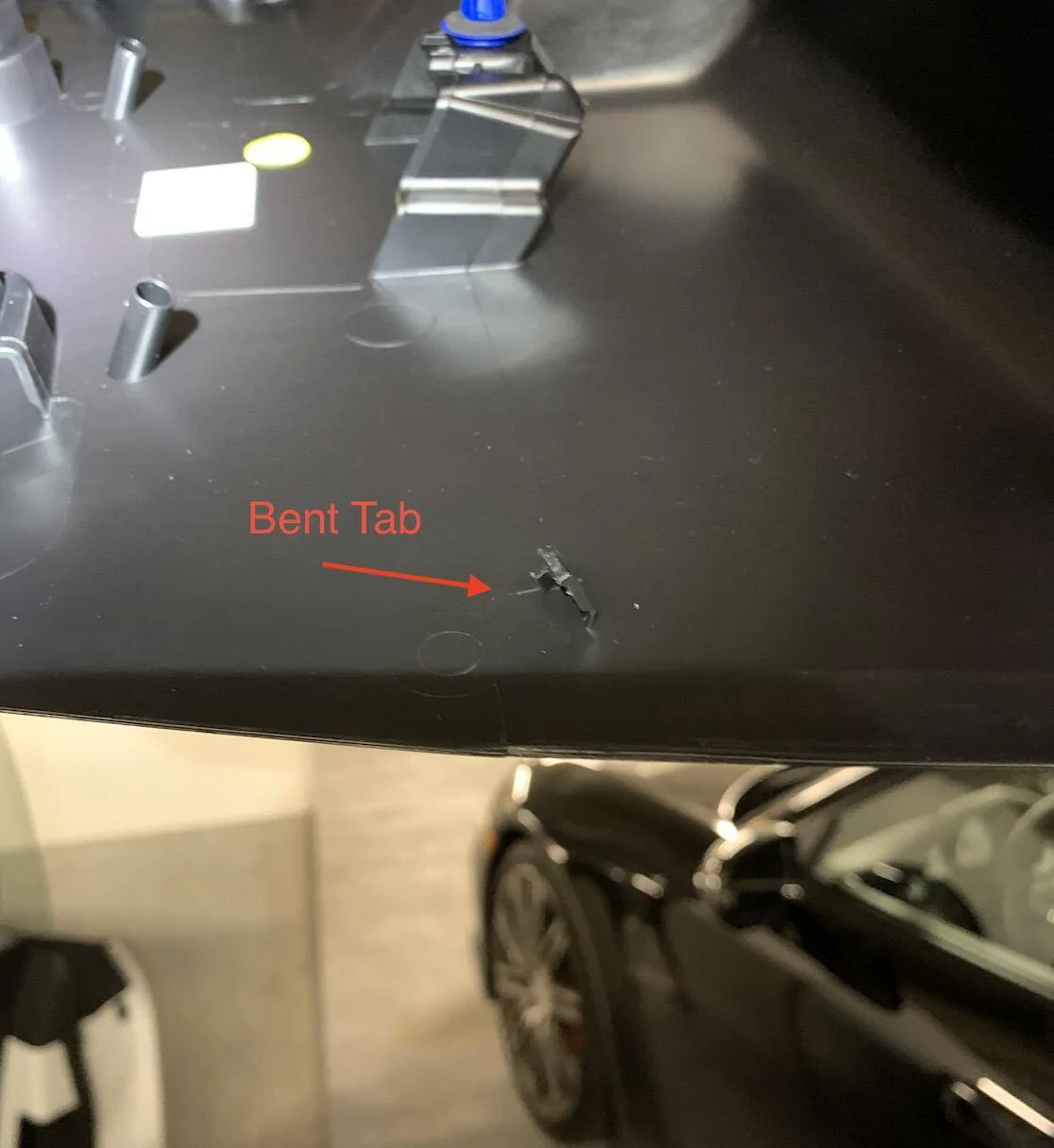

4) The door sill plate (in my case brushed aluminum) is held to the plastic covering via bent tabs. Be very careful when you move the plastic trims as the aluminum sill tabs may become loose or break.
As the perfectionist (as my family tells me) that I am, I decided to felt-tape the bottom of the door panel as well.
