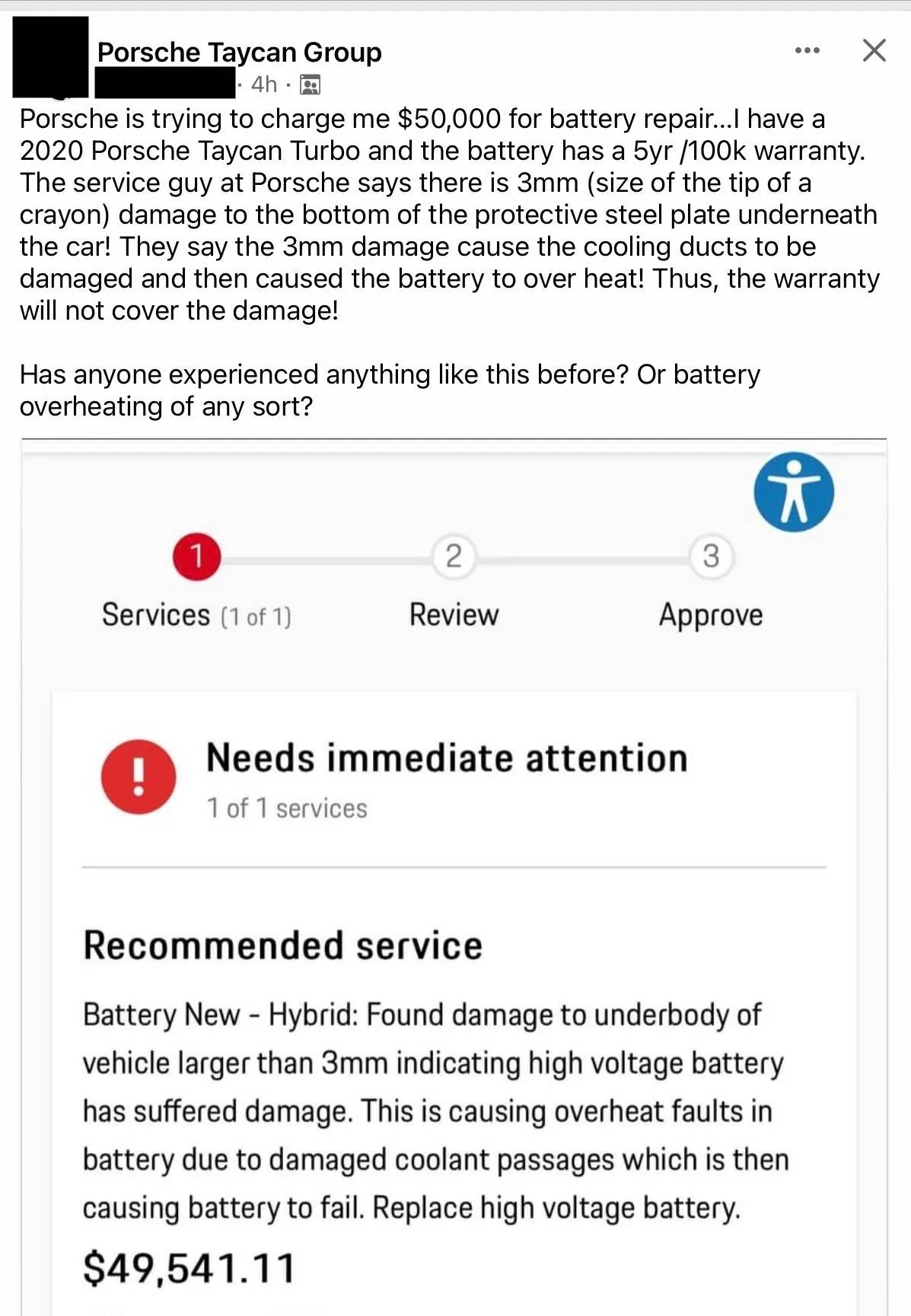

I saw a poor soul on Facebook post that his battery took some debris damage, piercing and overheating it.
Because it was caused by road damage, warranty does not apply.
Some commenters suggested he file with insurance, but that's not good news either as it will translate into higher premiums for all of us once insurance companies pay a few of these out.
I'm a big fan of electrics but I have to admit this gives me pause.

This is what insurance is for. Any premium increase will be de minimis. No reason for Porsche to cover it under warranty. Paying for it out of pocket is dumb.
Porsche’s battery enclosure is impressively robust. When I was rear-ended, I was hit so hard that the front of the car and pedal box were bent. The battery was one of the few elements that didn’t require repair or replacement — and that was an incident where the car was a total loss.

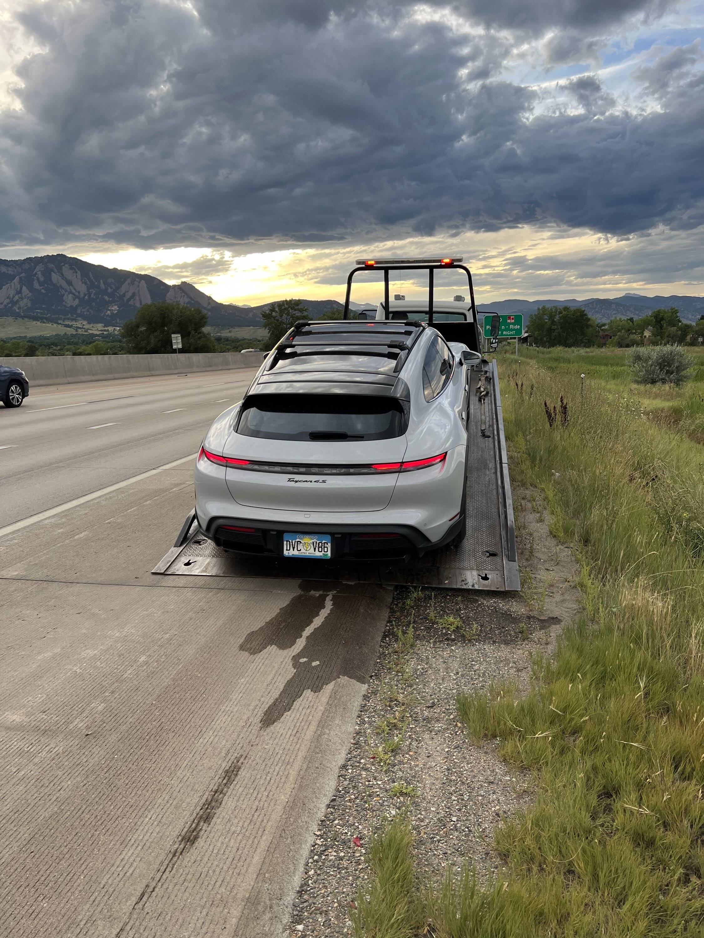

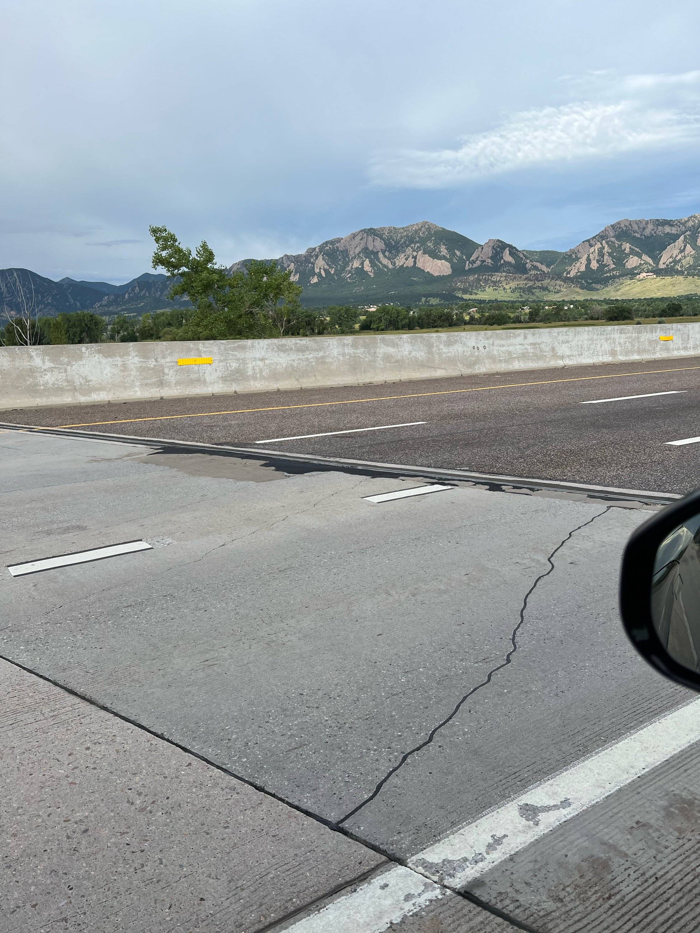

Last Friday I ran over a piece of metal that was sticking up from where a bridge and the roadway meet - there are metal rails at that junction point - doing 80mph in moderate traffic. I did not see the chunk of metal until it was too late, and since the metal was wedged in the spacing/gap between the road and the bridge there was no give to the debris and it did a number on the car.
My CT4s when airborne for a second and when I hit the ground I realized I had no steering, and I could not budge the steering wheel . Luckily, the wheels were still point mostly straight, so I slowed down as I drifted to the shoulder. The car next to me saw what happened and gave me some clear space to drift off the road. If the wheel had been more at an angle, I would have hit other traffic, or flown right off the highway at speed.
It was some scary shit.

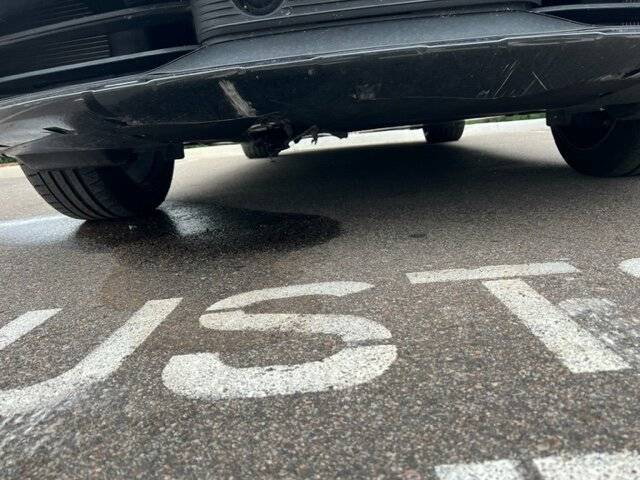

I had the car towed to the Porsche dealership, and am still waiting to hear the full extent of the damage. I have my insurance company engaged, and told them to kiss my ass because they wanted the car sent to a 3rd party repair facility. Until I know if there is any damage to the battery, no one is looking at the car other than a certified Porsche mechanic.
In the pictures you can see how high the debris was sticking up and the damaged it caused to the front underside of the car. I am hoping that by going airborne for a second I cleared the battery of any damage.
I went out the next morning to where the chunk of metal was sticking up, and that had damaged more cars than my own, and the Colorado Dept of Transportation had been out over night to do repairs. Luckily, in Colorado, if you can establish that the roadway debris was there because of shoddy work on the part of the state, they will pay for repairs. I am going down this path because I don't want the insurance company to have to carry the massive financial burden it will cost to fully repair my CT4S.
Hopefully all that "blood" on the ground is power steering fluid and not battery coolant.

Does anyone know how thick the underside of the battery is?
Just curious on how deep something has to be to pierce the battery.

Fingers crossed it is something like this. Right now my main concerns are battery damage, and frame damage from high speed impact on an object that did not move and caused the vehicle to momentarily go airborne. I am still trying to figure out what connection was severed to cause the steering to go out and freeze.
I really don't want my vehicle to be totaled because the car now costs $10k more to spec than when I initially ordered, and interest rates were much, much lower in June 2022 than they are now.
I do feel lucky and grateful my passenger and I were not hurt, or worse. But, damn, I it makes me sad because of the 30 cars I have owned in 30 years, this is my favorite.
