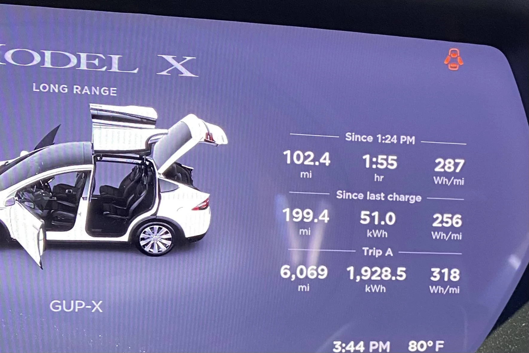

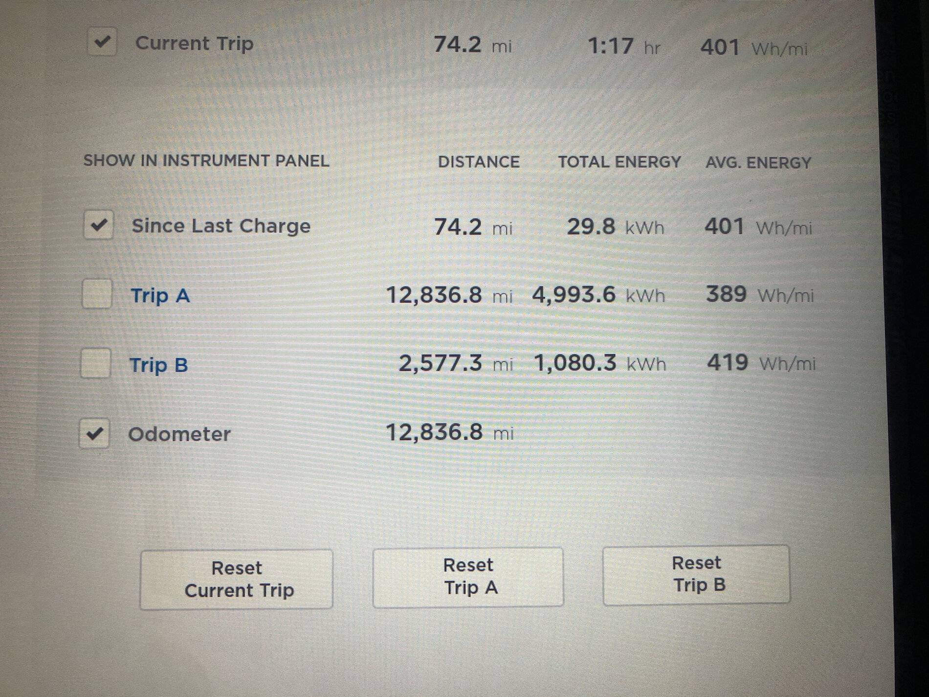

Here is the efficiency data for all three cars. Keep in mind I typically drive the Taycan in Sport Plus mode and much more aggressively than my wife drives the E-tron, or the Model X previously.
Our Model X data from the Michigan road trip along with the overall data (trip B was the Michigan trip):

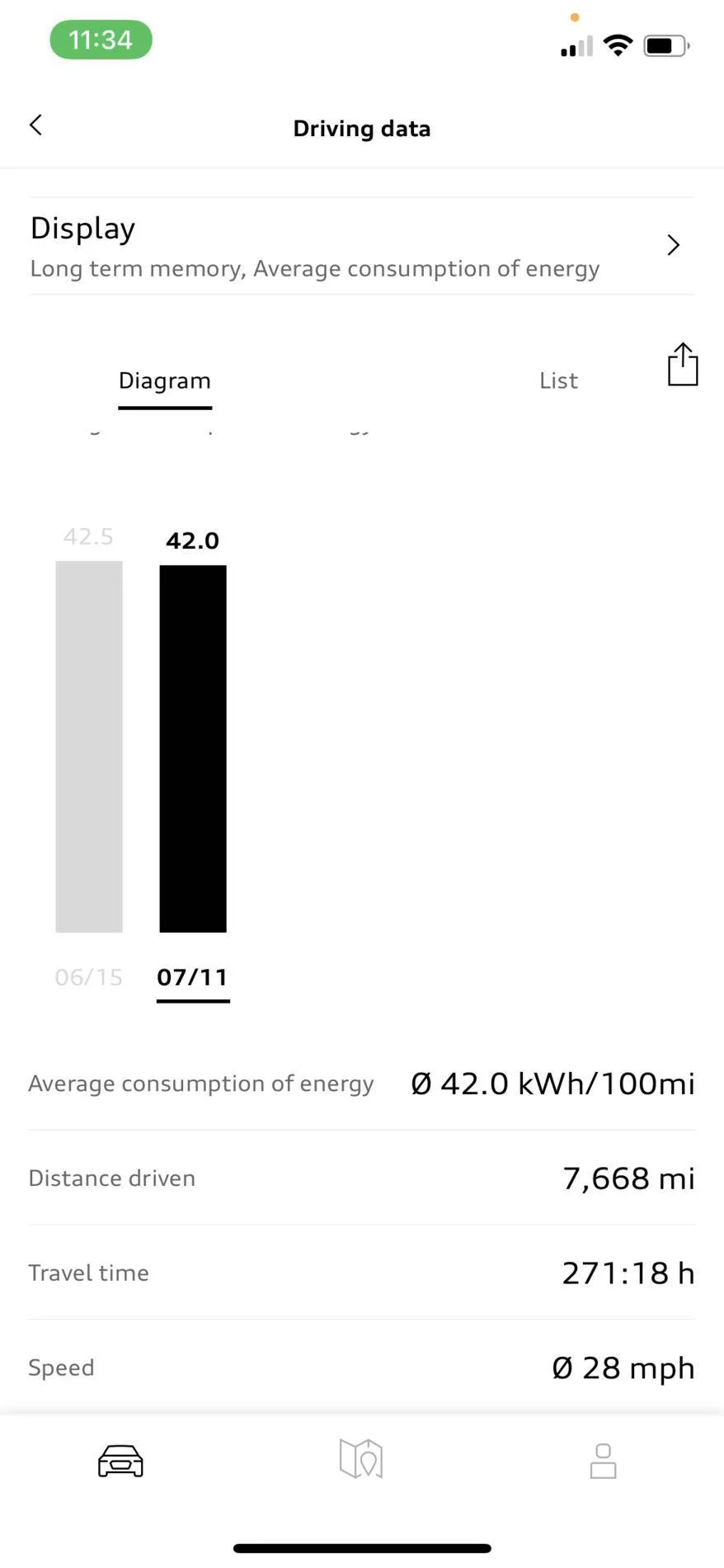

Our E-tron overall data:
Porsche Taycan Scared to ask... anyone tempted by Model S Plaid? IMG_4009

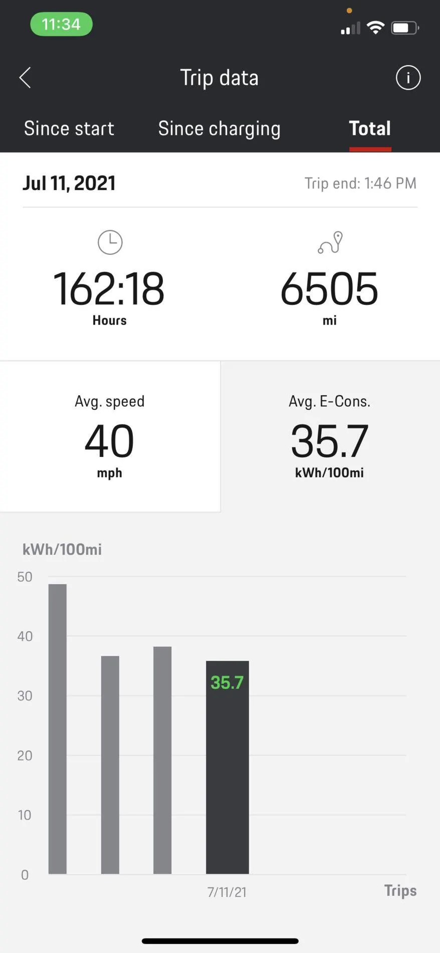

My Taycan overall data:
Porsche Taycan Scared to ask... anyone tempted by Model S Plaid? IMG_4008

We had a 2018 Model X 100D with the 22" wheels and the six seat configuration. I know the 22" wheels have an impact on range, but my Taycan Turbo S has the 21" Mission E wheels as well and gets much better efficiency. The interior space was great, but without the ability to put a roof rack on the car we were limited especially on ski trips.
My biggest disappointment was our road trip from Colorado to Michigan. We averaged 419 Wh/mi over 2577 miles (less then 220 miles of range when fully charged). The efficiency was bad, but the charging was worse. The outside temperatures were in the upper 80's to mid 90's and the charging speeds were rarely above 100kW. We would get to a supercharger with 15-20% remaining, it would quickly ramp to 125kW and then by 45% it would be below 100kW. We were regularly taking 45 minutes to charge to 60-70%. Needless to say it made for a long road trip.
On similar road trips with high temps and highway speeds my E-tron has worse efficiency (420-450 Wh/mi), but has a roof box installed. It also charges at 150kW all the way to 80% regardless of the outside temperature. Our charging stops were typically 15-20 minutes. So our E-tron was faster on road trips than the Model X. Then throw in our Model X cost $117k minus the tax credit versus our E-tron was negotiated down to $64k (from $75k) and the tax credit on top of that. The Model X suddenly felt very expensive, with slow charging and a lot of squeaks and rattles.
Now compare our Taycan Turbo S with 300-320 Wh/mi in range mode, with equal to or better than charging speeds of the E-tron, and it makes for an excellent road trip EV. I'm sure the new Model S LR/Plaid have a little better efficiency, but I doubt they have better charging speeds. So the argument that Porsche dropped the ball in terms of efficiency and charging speeds compared to Tesla isn't true. On the surface by looking at EPA ratings and peak charging speeds, Tesla looks like a slam dunk, but in reality Porsche is really close. Obviously charging network is another story and obviously a big part of the equation.
What's notable is the difference in consumption over thousands of miles.
You're at 389 over 12k miles.
I'm seeing 318 over 6k miles.
Are you towing anything on some of those drives?
22% is a massive bite, if that's just the wheels.
The efficiency I'm observing is why I keep saying that newer Teslas can achieve EPA. I'm driving speed limit + 5-10 (often 65-75mph) , non-range mode AC, 4 people in the car + luggage for a whole family. The EPA range was 320 miles, I'm getting just over 300 miles of range. Given my use cases, that's well within reasonable. It's also closer to EPA than any of my ICE cars ever managed: Q7, E class, M3, 911s all fell at least ~15% short over their lifetimes.
We never towed anything with the X. So a couple of things. Most of my road trips outside of the city are on fast open highways with 75mph speed limits (Colorado, New Mexico, Nebraska, Iowa, Arizona) and I tend to drive 5-10 over, or in the mountains with elevation and temperature extremes. So there is a good chance that under my typical driving conditions that it’s much harder to hit the EPA range.
Having said that keep in mind that all three of our vehicles are driven in similar conditions. Our Audi has an EPA rated range of 204 miles and we are achieving 199 miles (with a roof box) based on our average. The Tesla had an EPA range of 295 miles and we achieved 236 miles. Our Taycan has an EPA rated range of 192 miles and we are averaging 239 miles (with a lot of spirited driving). So for us our Tesla fell way short while our other vehicles are performing as expected or much better.
