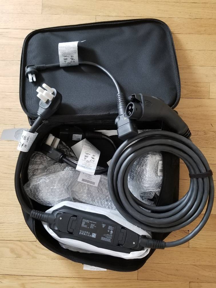

In the trunk there should be a black zippered case. Inside is the Mobile Charger Connect, mounting brackets, a pile of manuals, the 25 feet cord if spec'd, the 110V cord, and the NEMA 14-50 cord. If you ordered something other than the NEMA 14-50 cord it will be there in lieu of the 14-50 cord.

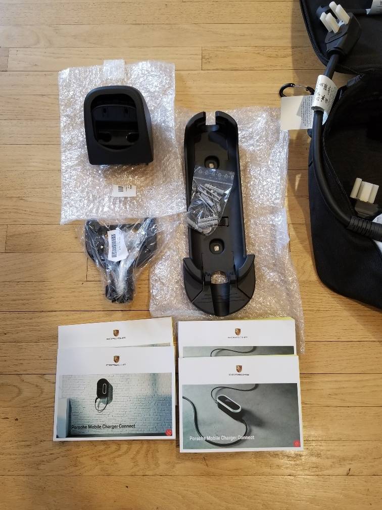

A picture is worth a thousand words. Here is a picture of what comes with the car in the US. Please ignore the extra cord in the bag. When I spec'd my car, I didn't know the NEMA 14-50 cord was automatically included. I accidentally ordered the NEMA 14-30 cord, so I had to purchase the NEMA 14-50 from the parts dept at the dealership. (I have the NEMA 14-50, 14-30, and the 3 prong 110V cords and the 25 ft charging cable).
Porsche Taycan Setting up for charging in garage 20200519_175723_resized

I don’t have the car yet. I just picked up the charger connect at the dealer so I could get it mounted. It was in a box. The dealer is telling me that the mounting brackets are a $180 add-on (see below). So you’re saying they should be included with the car?
In the picture I posted the items in the bubble wrap are the mounting brackets which were included. I think they are the basic wall mount.

Thanks. I didn’t get a bag either. What about the mounting hardware? I don’t see that in your picture.
