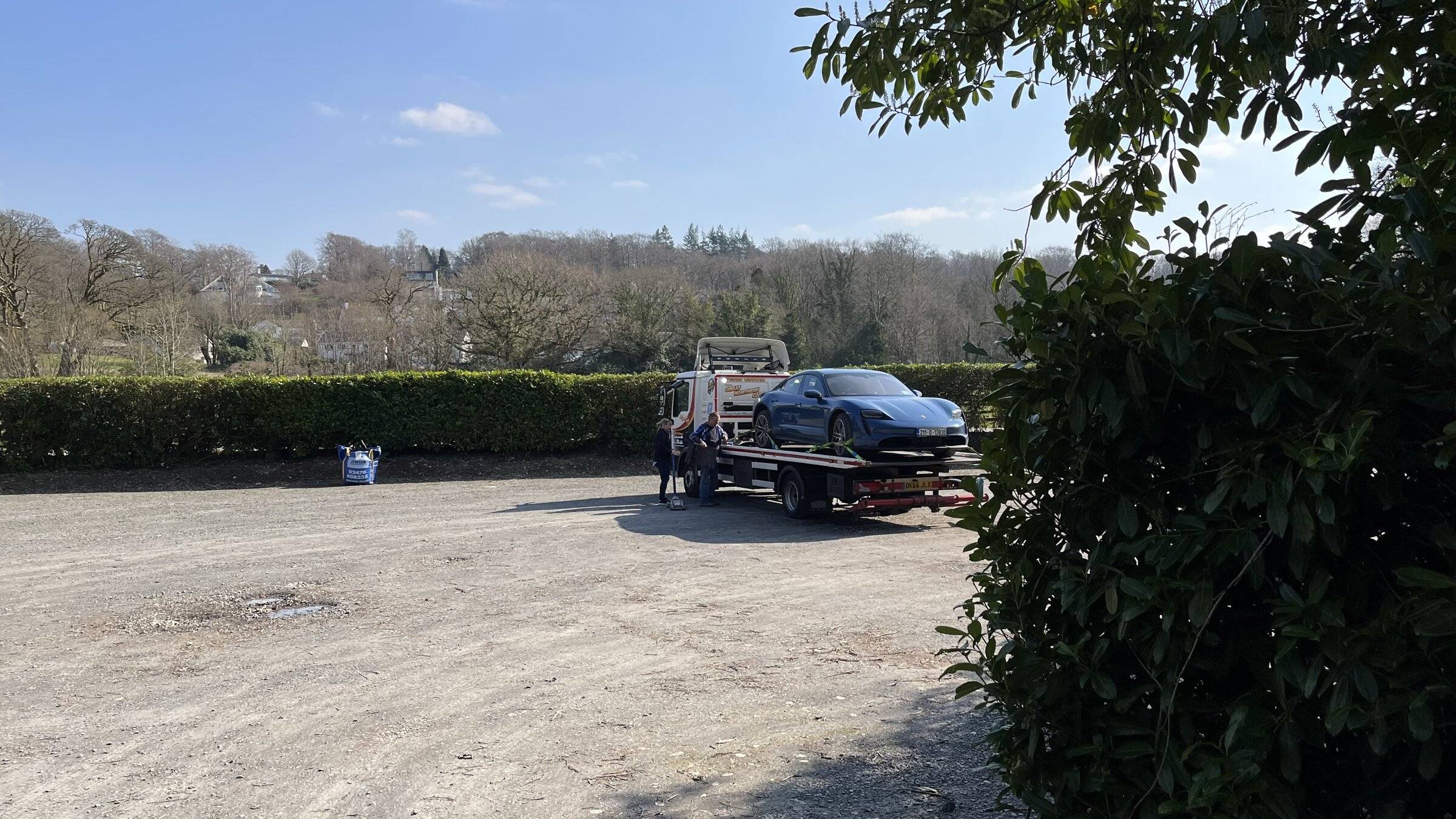

How depressing. Did they bring you another car on the tow truck? Will it be taken back to Ireland for you or to a dealer in England?

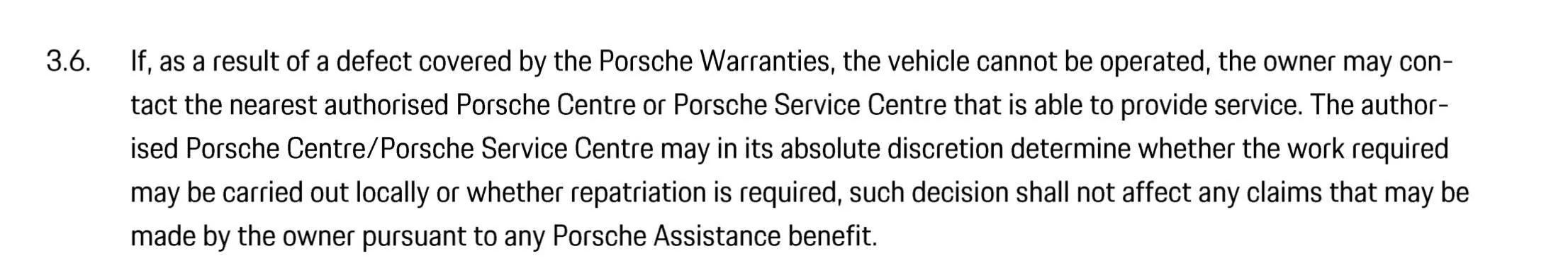

It is going to a dealer in England and we take a train and plane back to Ireland tomorrow. I've no idea what is the process re: fixing the car or getting it back to Ireland.
The Porsche Warranty is Europe-wide and this clause seems to cover my situation:

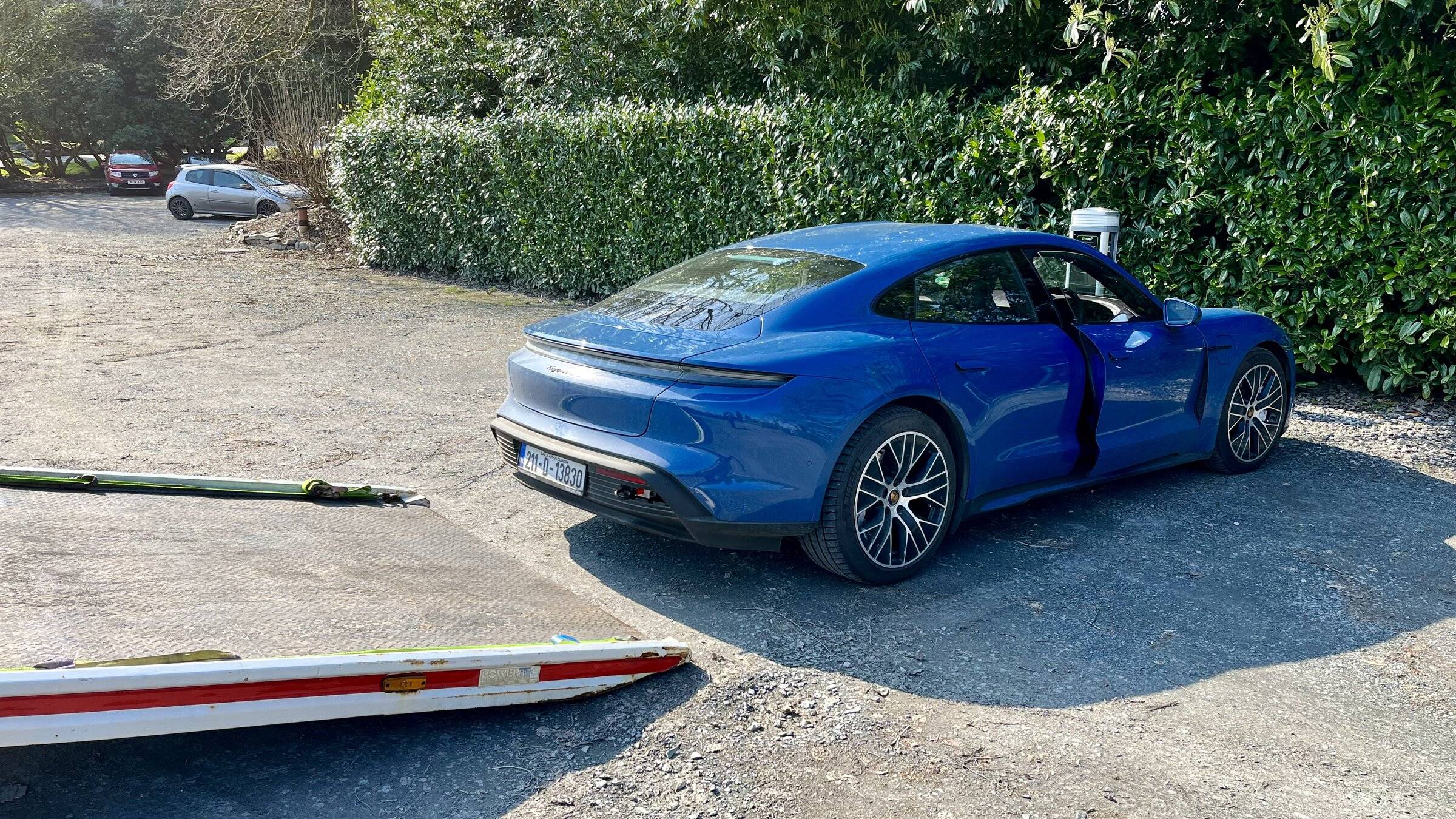

Spending weekend in Lake District, UK. Plugged into hotel destination charger - which worked fine yesterday.
Today it charged at 22kW for about an hour and then got a charging error.
When I went out the charger was dead. Car showing this error and refusing to go into any gear or move.
Any ideas?
