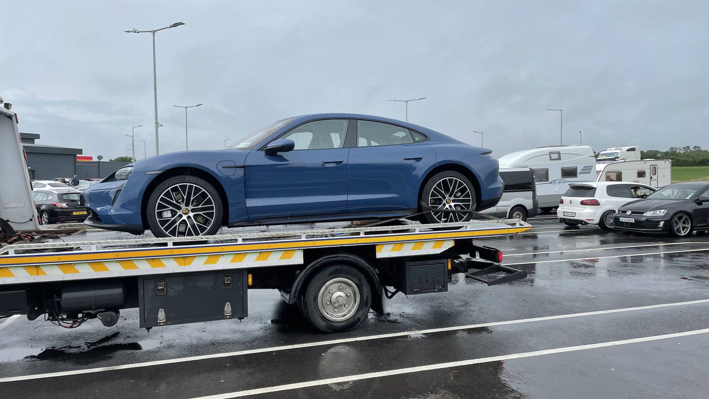

If it does have to get lifted onto tow truck – thankfully its stuck somewhere with plenty of room around it. Hate to think of this happening in a multi-story car park – where often hotel destination chargers are located.
Tow truck drivers are very helpful. This was my experience!

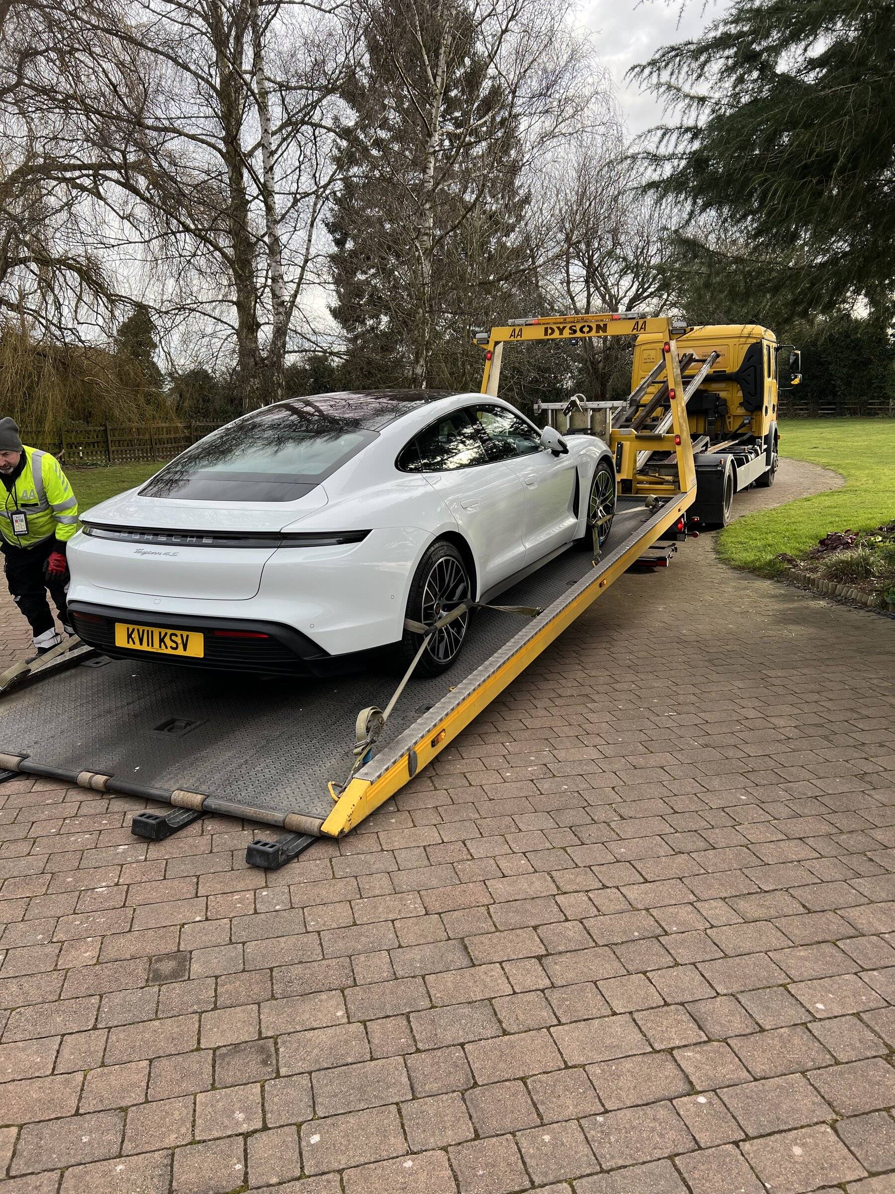

Unfortunately too familiar .... at least that time I could drive it on to the truck. This time it won't move and has no steering.
