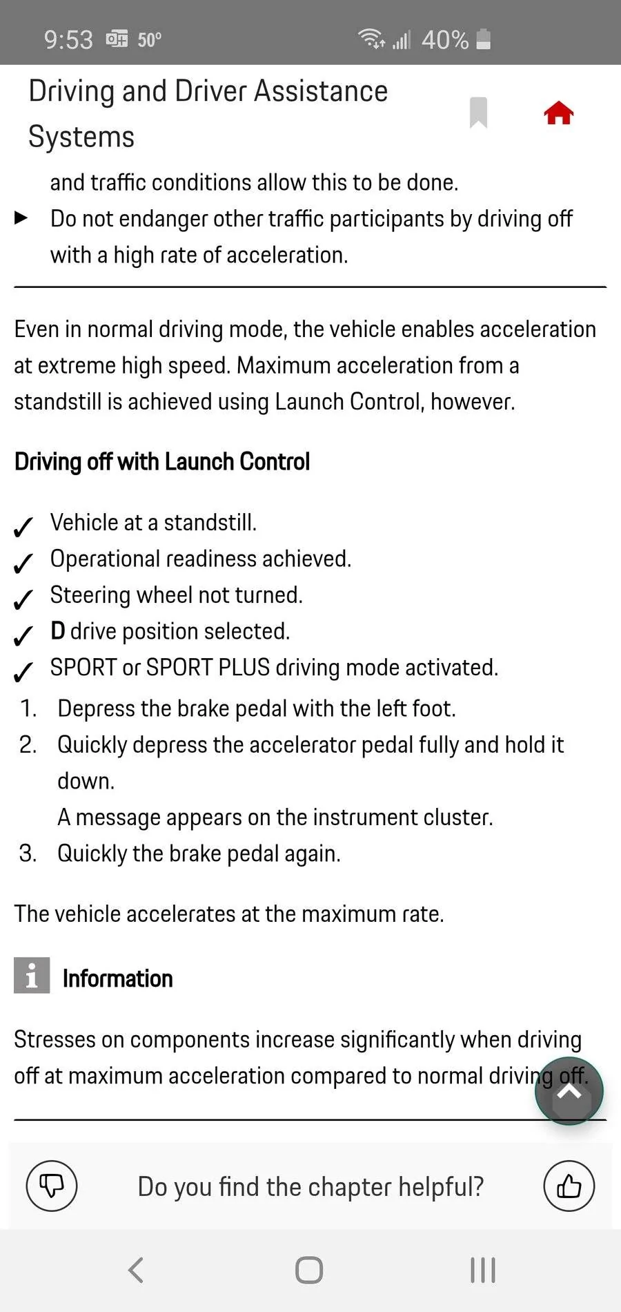

I was under the impression, based on a review elsewhere here, that even without the Chrono package, you still had Sport + mode and overboost on the 4s. Does anyone know for sure?
According to the Porsche Good to Know app, launch control is available in Sport mode, which means you don't need the Chrono package.

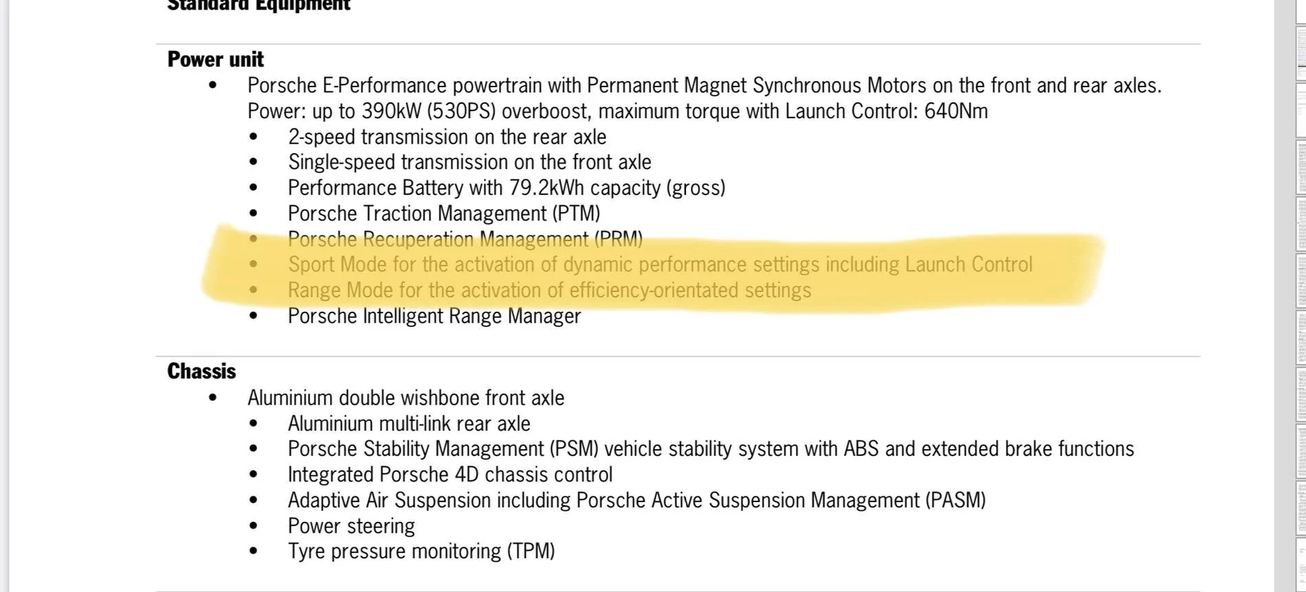

Taycan 4 S
The Taycan 4S delivers Launch Control and Sport + Mode for the chassis whether you order Sport Chrono or not.

andyxxl
andy
Dec 5, 2019
97080 germany
Taycan 4 S
;) Launch Control is definitely on board, independently from Sport Chrono!
