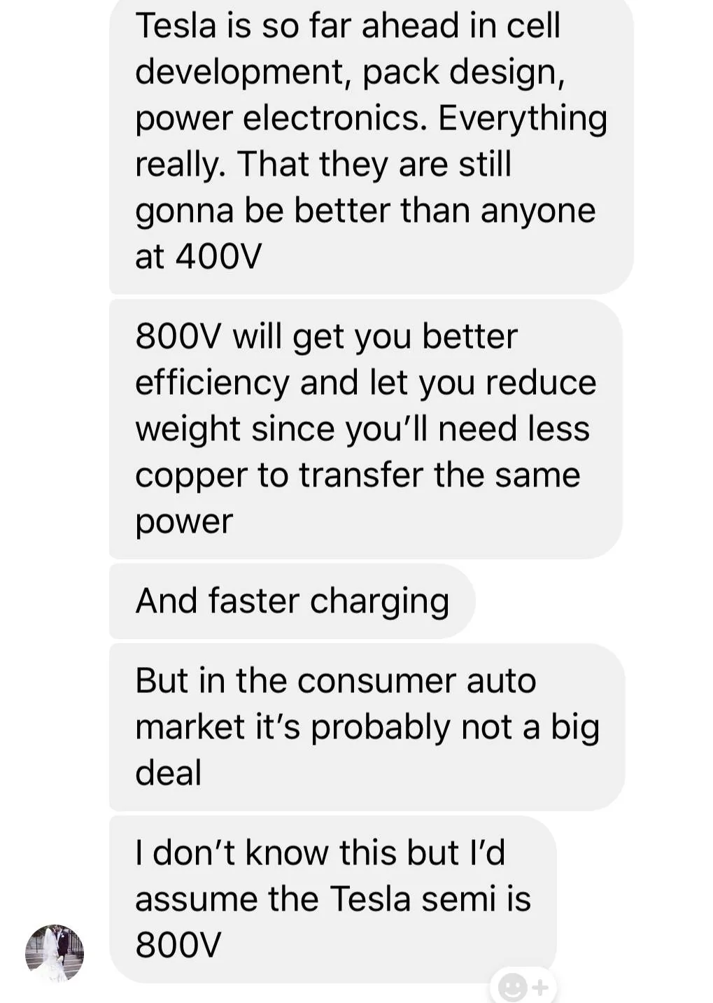

From my buddy who actually does this for a living, rather than all of us college 200 level physicists:

We all know Tesla is the leader in smallest length of wiring harnesses. That 4500 pound Porsche probably has 300 pounds of wiring in it. Tesla Model Y is supposed to be down to 20 pounds.
Theoretical labratory fast charging is great, but Porsche’s US charging network is basically a bunch of 50 kW chargers. Only Tesla has a natoinwide network of 150 kW chargers which are all being upgraded to 250 kW.
