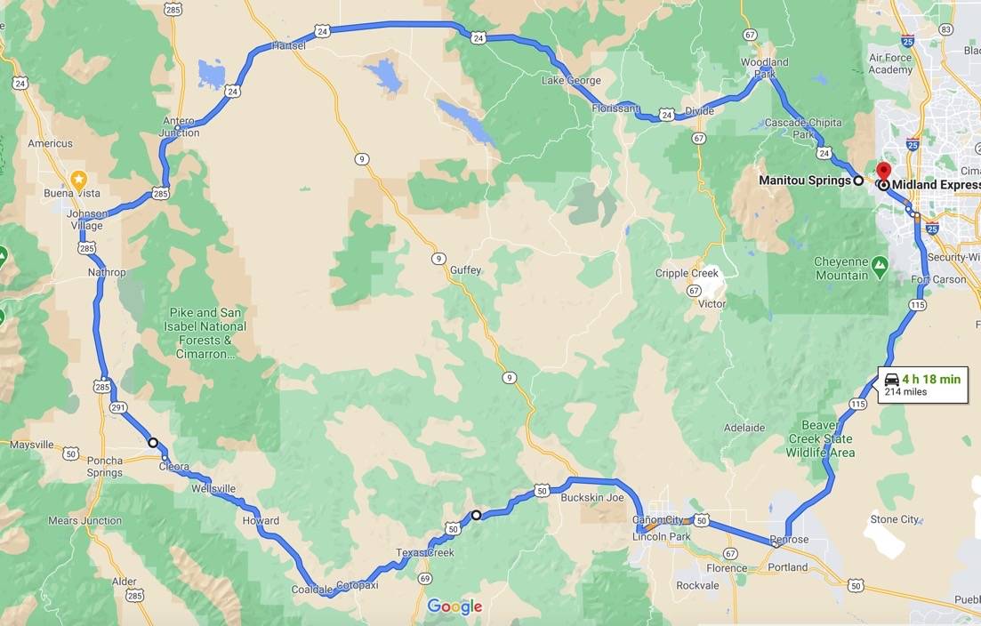

The screen shot below is approximately the route I took this past weekend. Headed out of Manitou Springs on 24 to Buena Vista, south on 285 to Salida, east on 50 to Canyon City, and then back to Colorado Springs via 115.
I'll start a new thread for the actual 5 day road trip and post details of our route. I believe it's about 1200 miles through Colorado.

That is great route. What was your overall average speed for the drive, 45mph or 55mph?

Average was 47 mph. There were several slow spots (Salida, and Canyon City) but otherwise cruising the canyons in the 50-70mph range and the open sections through South Park at 75-80mph.
