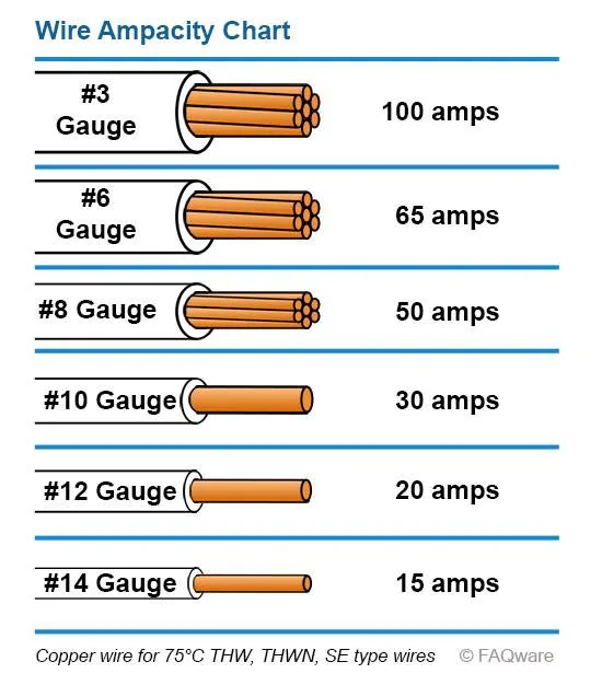

By George, I think I've got it now! I have a 50amp 10-50 plug at home using 6AWG left over from my Chevy Volt days, and feel no need to go beyond that.
you are correct - your 10-50 plug will be great and should charge your Taycan @ 9.6 kW if you have a 40 amp EVSE (50 amp breaker)
but 6 gauge AWG can support a 60 amp breaker -swap the breaker and install a ClipperCreek HCS-60 - hardwire the ClipperCreek charger into the box where your current 10-50 plug is - and you can charge your factory stock Taycan at home at 11 kW instead of 9.6 kW…
the ClipperCreek will also charge your Volt, but no faster than previously cause the limit is the charge rate of the Volt :rock: - but it will work fine.
but that is entirely optional.

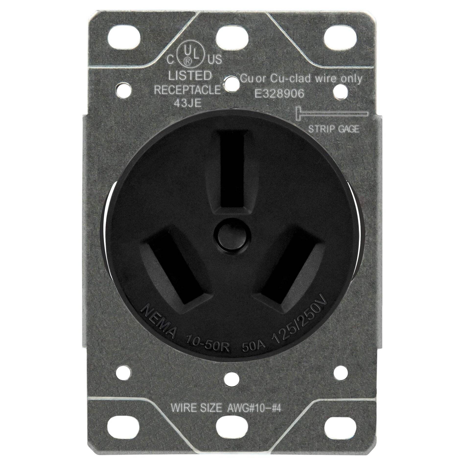

By George, I think I've got it now! I have a 50amp 10-50 plug at home using 6AWG left over from my Chevy Volt days, and feel no need to go beyond that. And since Porsche has dropped the 22KW(19.2KW) charger, that leaves the 400V 150KW unit, for which I will check that box! Man, I too would be lost without all your help. Thank you all again!
I am curious - the most common 50 amp plugs in North America are NEMA 14-50 & NEMA 6-50 - do you actually have a. NEMA 10-50 plug (see pic below)?
Porsche Taycan What happened to the 19.2 KW AC on board charger option ? 91PLnDSmk8L
NEMA 1-50 is a two-hots & ground - 3 blades - and can be easily swapped for a more common NEMA 6-50 plug - Porsche does not provide a NEMA 10-50 cable option for their EVSE - but they do offer either a NEMA 14-50 or NEMA 6-50 supply cable for their EVSE's
although if you do have a NEMA 10-50 a high quality 10-50 to 6-50 adapter from Amazon would be no problem because both plugs are 50 amp rated and the same number of connectors and wires…
anyways it's easier to find NEMA 14-50 & 6-50 EVSE's than 10-50 EVSE's but adapters are easy and cheap.

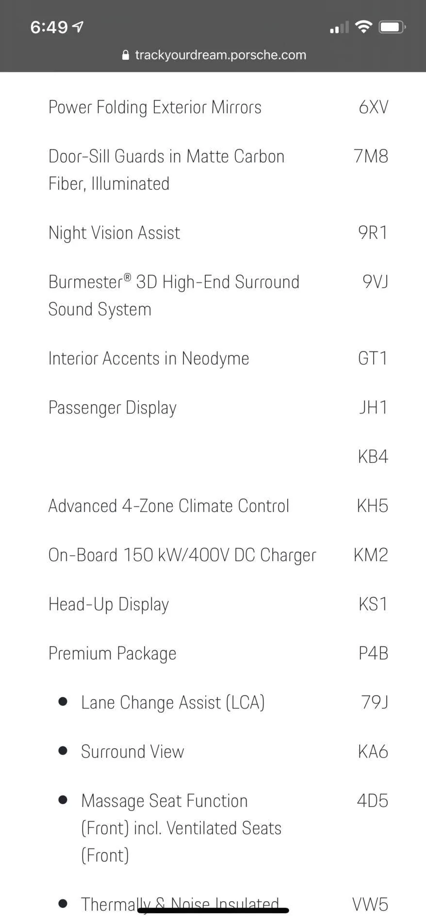

Porsche Taycan What happened to the 19.2 KW AC on board charger option ? 850DE56B-A653-4129-9B0C-E63F1C7FBB98
This is what my config looks like now on track my dream. At first it looked like the 19.2kW charger disappeared, but I noticed the MSRP total was the same. Looking again, the option code is there (KB4) but the description has been removed.
Mine got on the Goodwood on 3/5, headed for Baltimore, and shows exactly the same as yours (option code, no description). Ugh.
Should we rename it?
Plug and Charge delete (KB4)
I’m trying to remain hopeful that Porsche will determine they can fix it in software, and commit to doing so within a reasonable time frame. If they can’t do that, commit in writing to replacing the faulty hardware within a reasonable time. I fear “a fix will be implemented in MY22” answer is coming, with no commitment to fix MY21. Both features are important to me, enough to walk away.
What Porsche does here will signal what customers should expect from the brand. Ultra premium pricing should come with ultra premium service and support, otherwise I should just stay with Tesla.
