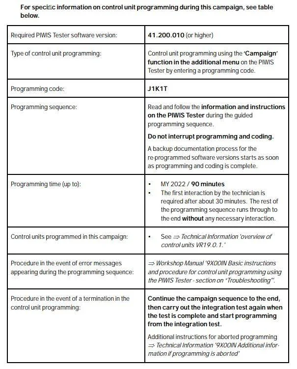

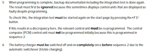

When you read these 18-23 page documents for each of the 3 campaigns, all 3 instruction sets updated twice within a week, you get some idea of what the service techs are having to deal with.
(I especially like the instructions to ignore the first test result.... )

:CWL: I missed that one.
If my car comes out of these updates in working order, I'm going back and tipping the tech.
