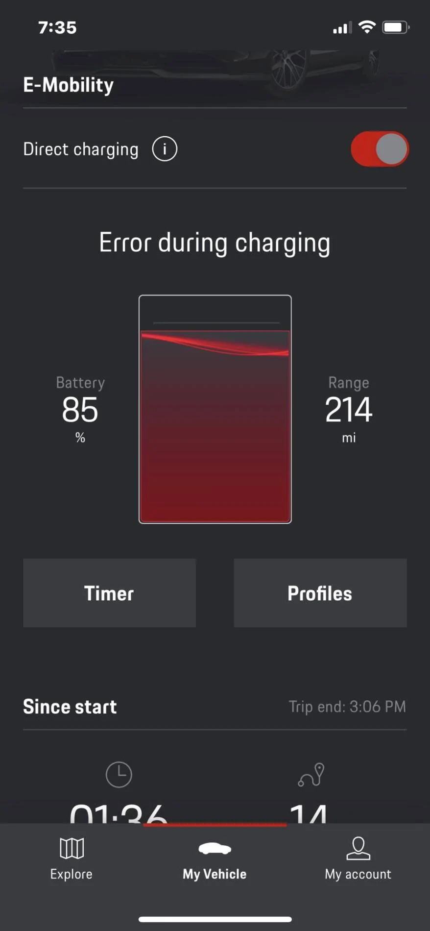

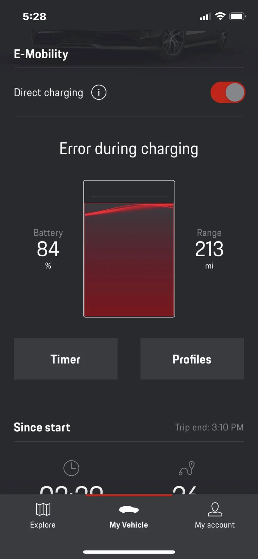

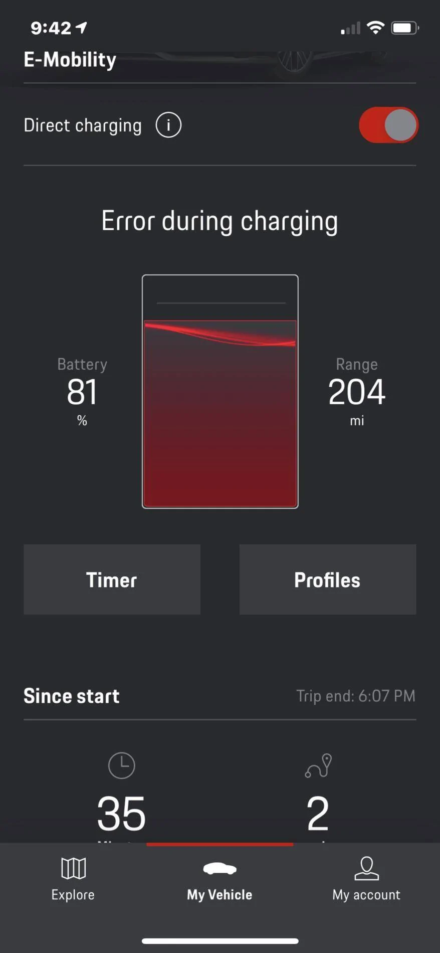

We are repeatedly getting charging error messages, usually when the car is about 80 to 85% charged. I had the electricians who installed the Porsche connect charging dock come and examine the wiring, and he found no problems. It is fully grounded, so whatever charging errors due to alleged ground faults appear to be erroneous.
Today I swapped out the pill for a new one at the dealer. All seem to be going well, and then I got the same charging error once again.
I’m really not sure where to turn at this point. In one sense, I guess I can live with it, if I just keep going outside and down to the garage and unplugging the pill and rebooting it, as that seems to get it working again — at least temporarily. But obviously this is a long way from satisfactory.
