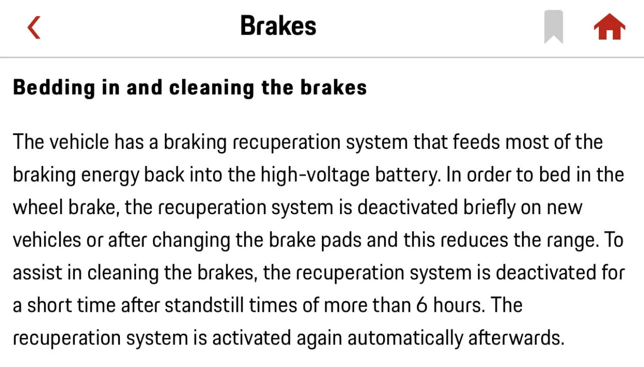

To add to @W1NGE's excellent points, the Good to Know app states that recuperative braking is disabled "briefly" (some say a few hundred km? -- can't find a reference) in new Taycans, and again when brake pads are replaced. Without recuperative braking your range may be significantly reduced depending on your braking style and the topography where you drive.
That’s interesting not even sure the dealer knows that but explains “you need to do 1000 miles albeit it’s not about “battery learning “

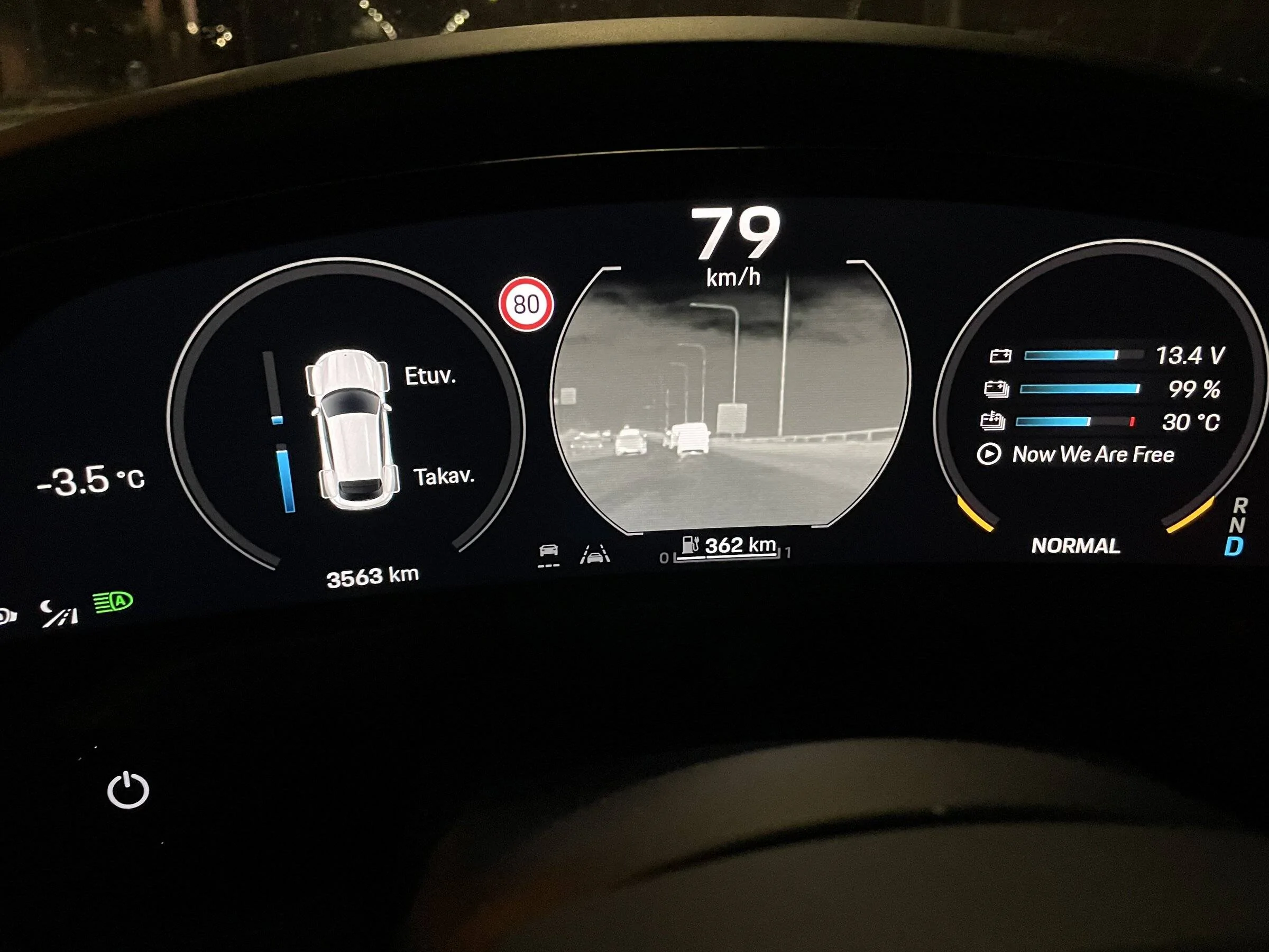

In cold weather I would set a timer to charge the battery to 100% and precondition at departure, this way the battery and cabin is warm and efficient.
Porsche Taycan Battery learning F09EF4B2-FB75-42A3-A2E1-5DB71DEBA071
The battery temp was +30C when outside temp -3.5C when leaving to work one morning with timer set to 100% at departure
