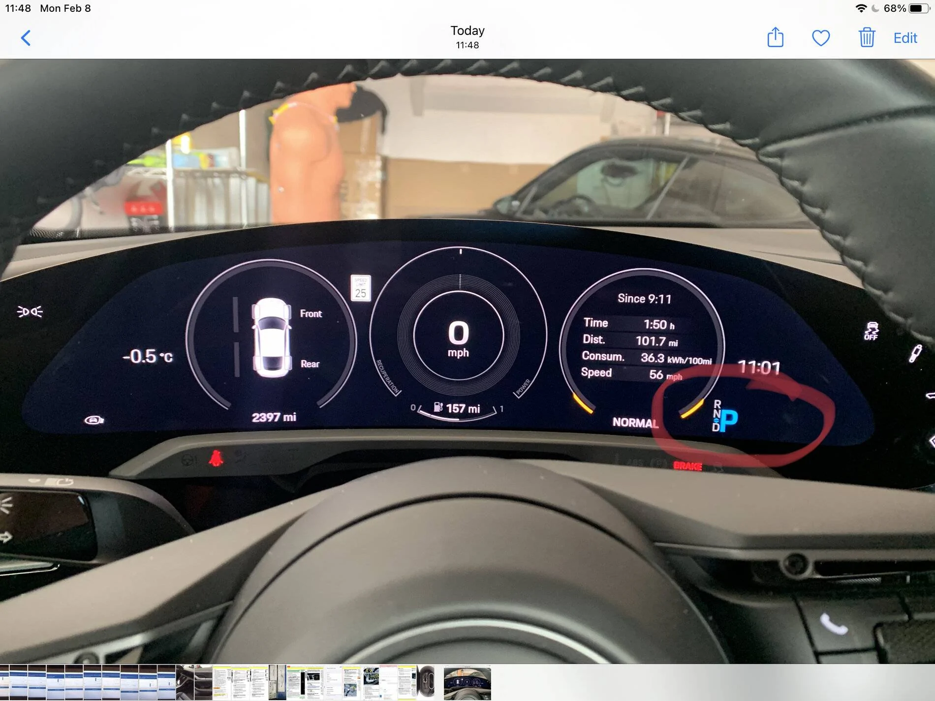

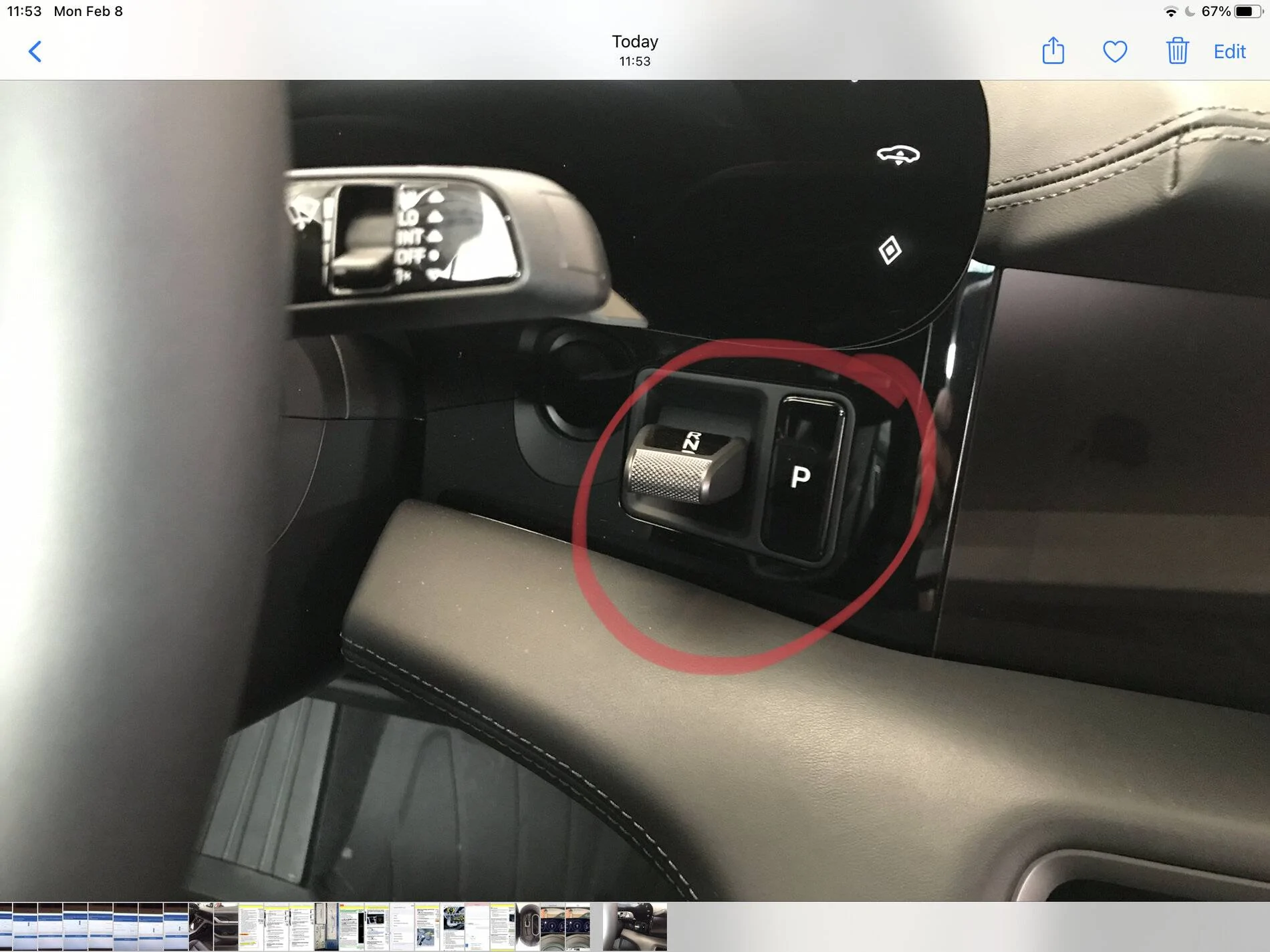

Also. Taycans dont have parking brakes or position P
