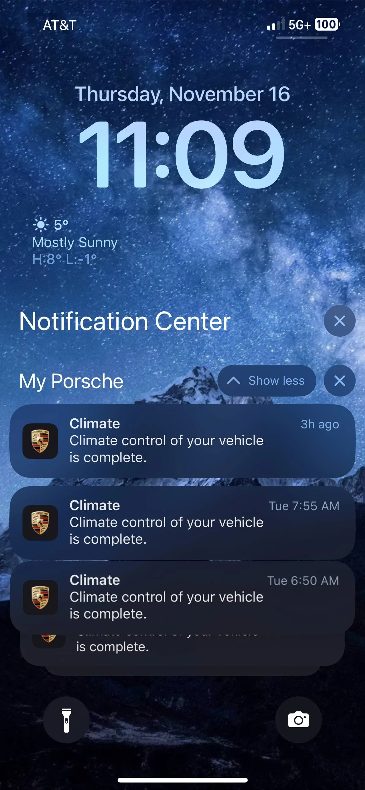

How long does it take to get to 21.5C? I recently remotely pre-warmed my Taycan recently in ~0C, 35 minutes later the car was warm (I had it set to 72F, so 22.2C).
Oh wow. The pre-heat timer on the instrument cluster says typically 5 min (in the summer it's 10). But that's not from 0, rather garage temp. I'll keep an eye out this evening after work.
(unlike Tesla, the the Porsche app doesn't tell me when the car has reached the target temp)
Do you not get these (annoying) notifications? I don't know how to make them stop - it's all types (including charging alerts, which I kinda need) or none.
If you start it from the app, it starts at 60 minutes (that number also shows on the IC). I think that's also true if you start preheat from within the car. I never used the timers, so not sure how long that preheat it.
Yep, I do. I haven't found a way to select which notifications I want to see. Tesla app has always had these as settings for a decade now, MyPorsche doesn't not (or at least not where I would expect them to be), perhaps it's coming at some future point. You are right, the only way is to disable whole app notifications on the phone/watch, but that's throwing the baby out with the bath water.
