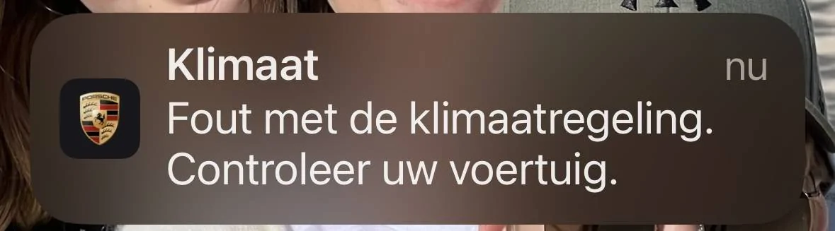

So I just had this message when preheating my car before going home.
Translated : error with the climatization, check your vehicle.
when arriving at my car it was climatized but the heating timer wasn’t on like usually. Switched the car on and fortunately the heater was working and blowing hot air during my trip home.
hope it’s not a first warning for what is going to happen the next days.
