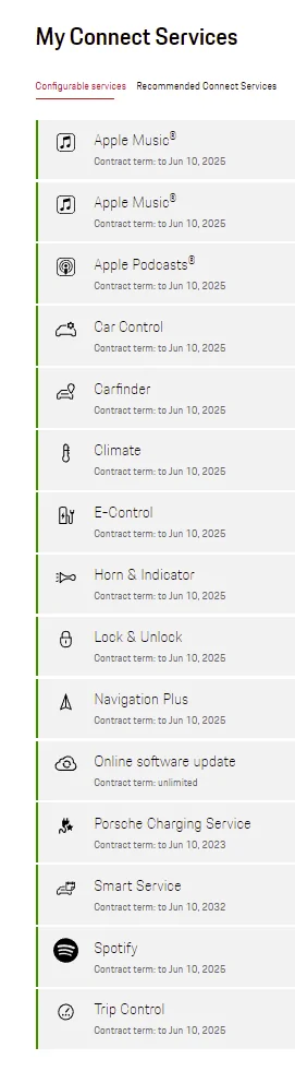

Log into the USA Porsche Portal (my.porsche.com) and click on
> About my vehicle
Porsche Taycan Help with Porsche Connect and My Porsche Mobile App Issue 1657322382751
There will be two circles on the left side of the webpage. The first circle is for Remote Access Authorization, and the second is for Online software updates. Are both of your circles green like mine, or is one or both red? (If they're both green, then sorry I don't know what to do next for you.)
Porsche Taycan Help with Porsche Connect and My Porsche Mobile App Issue 1657322516811
If either of the circles is red, click on it and follow the prompts. The goal is to get green bars for all of your configurable services under My Connect Services found further down the same webpage.
Porsche Taycan Help with Porsche Connect and My Porsche Mobile App Issue 1657322738294
I hope this helps ... and hope others have more advanced advice than me ...

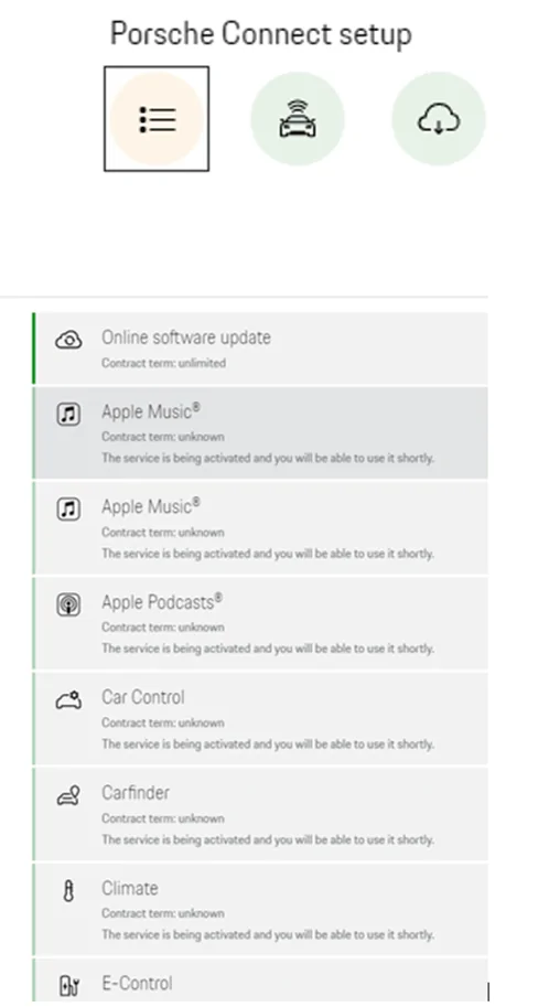

Thanks for the advice and sorry to hear you're having issues as well. Both those circles are green for me. However, the one to the left is yellow and all the features below except Online Software Update are light green and say "you will be able to use these features shortly." Has said the same thing since I took delivery....
Porsche Taycan Help with Porsche Connect and My Porsche Mobile App Issue 1657326354343
