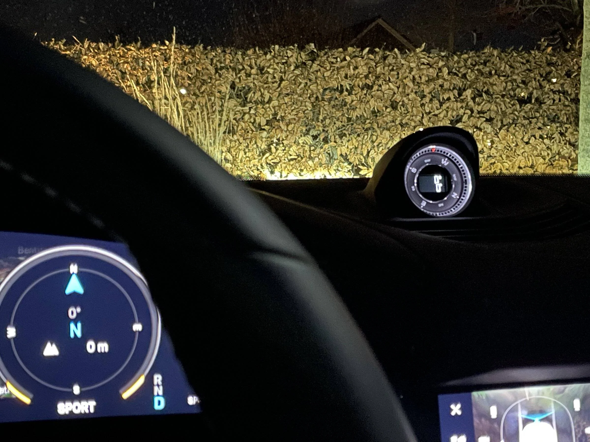

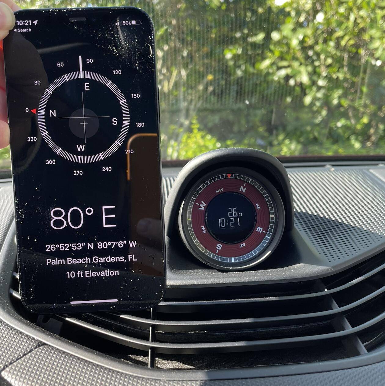

I just noticed (actually passenger) that the compass is .... not accurate, look nice but useless!
I guess an other bug or technical failure or you are not supposed to look the compass but drive the car.

Have very same Bordeaux red :), but I have not seen it in error as yet - seems to be spot on.
Just to check - I noticed that mine basically seemed to 'boot up' (spin up to correct direction) after starting/powering up the car i.e. I wonder is the clock display a digital report of the compass and the actual reading taken from somewhere else on the car (for interference/bounding material reasons?). If correct, then obvious question, was the car fully powered up when you compared to the iPhone's compass?

Yes it was.
It may be due to the fact driver display and compass never shut OFF, I always see the P on the Driver display and Compass remain showing time and kinda of direction.
"funny" is...I can shut it off from PCM (car ON) does its spin to a random position, light off the screen and the time and then when with OFF the care, Compass come to "Live" with on show some direction, light the back ground and show time!
Tried to find a reset some where - nop
Tried to reset PCM - nop
Tried pull the plug like on my (SH#$%#$%) PC - can't find the plug
Porsche Service - nop (like with the Alarm, Miss fit panel, open close door)

OK laughing man @fleng - and with genuine deference to your automotive career :), is my suggestion that far out?
I raced BMW GS’s off-road, mountain bikes and road bikes and it was not at all uncommon to have metal on these machines interfere with any sort of mounted mag. compass that effectively made them useless - entirely dep on proximity of ferromagnetic material and magnetized material at that of course. Electromagnetic interference from a car dash electronics if poorly shielded combined with other sources could presumably also effect a basic ‘mechanical’ compass - hence just the suggestion that the actual magnetic compass in the Porsche might be located in an area of minimal interference and via a simple circuit board relay it’s reading to a ‘digital’ (‘pseudo’-) compass readout in the cockpit.
Now of course fully appreciate most metals in our Porsches are weak to non-magnetic and that even the steel present is not nec magnetized nor strong enough if so to have a field big enough to mess with a conventional compass magnet. - more than likely answering my own question :)
But again the only reason for suggesting even this was that the Sport Chrono compass needle/readout ‘activates’ every time you power up the car - a std. stand-alone compass presumably would not?

I have the same problem too…
The compass on the dash actually shows a different direction then the digital one on the instrument cluster.
The degrees shown on the compass and on the instrument cluster the same. So it looks like only the turning ring on the compass is off.
Sometimes it starts the right way, sometimes it’s wrong.
Porsche Taycan LOL - My CT lost the North! F472A26D-FA6A-402A-86DC-9029EA568C6D

I had this problem. I could always see the P and a slight glow from the instrument cluster. My sport chrono clock didn’t turn off either. Even if the car was sitting for a few days.
I had the dealer connect their computer and check for any error codes. They said there were no error codes but afterwards everything started turning off all the time. I asked if they did any kind of reset function or anything and they said no.

Terminal 20 reset solve it all but the alarm.
-driver display that does no got completely off
-various display bugs with miles vs Kim’s etc…
-compass losing the ‘north’
-gps map not displaying in central driver display
-blurry hud
and maybe more but that fixed with terminal 20 reset and seems to be stable
I have the internal sensor module in order that should fix the alarm.
for the rest I just love the car!
