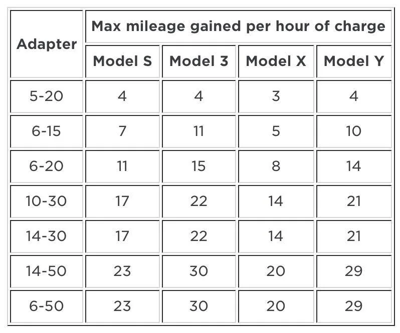

this is the Tesla UMC Gen2 Offering - and a wide range of NEMA plug adapters available - the Taycan is about the same as a Model S - so the miles-range/hour of charge is about that column
$275 - https://shop.tesla.com/product/gen-2-mobile-connector-bundle
$220 - https://shop.tesla.com/product/nema-adapter-bundle

https://www.evseadapters.com/collections/new-tesla-model-3-gen-2-charging-adapters/
this site has a number of "interesting" adapter for the Tesla UMC Gen2 that offers additional plug compatibility beyond what Tesla offers on their site. Most interesting to me from that site is the TT-30 adapter for the Tesla UMC Gen2 - a common plug type at race track paddocks and RV parks & campgrounds.
for any particular 50 or 30 amp plug that one offers vs. another - there are adapter to covert a 6-50 to a 10-50 - and since the amps are the same they are safe to use - example mustart offering a 10-50 is not a deal breaker for the Tesla UMC cause a 6-50 to 10-50 adapter is is $29 from amazon.

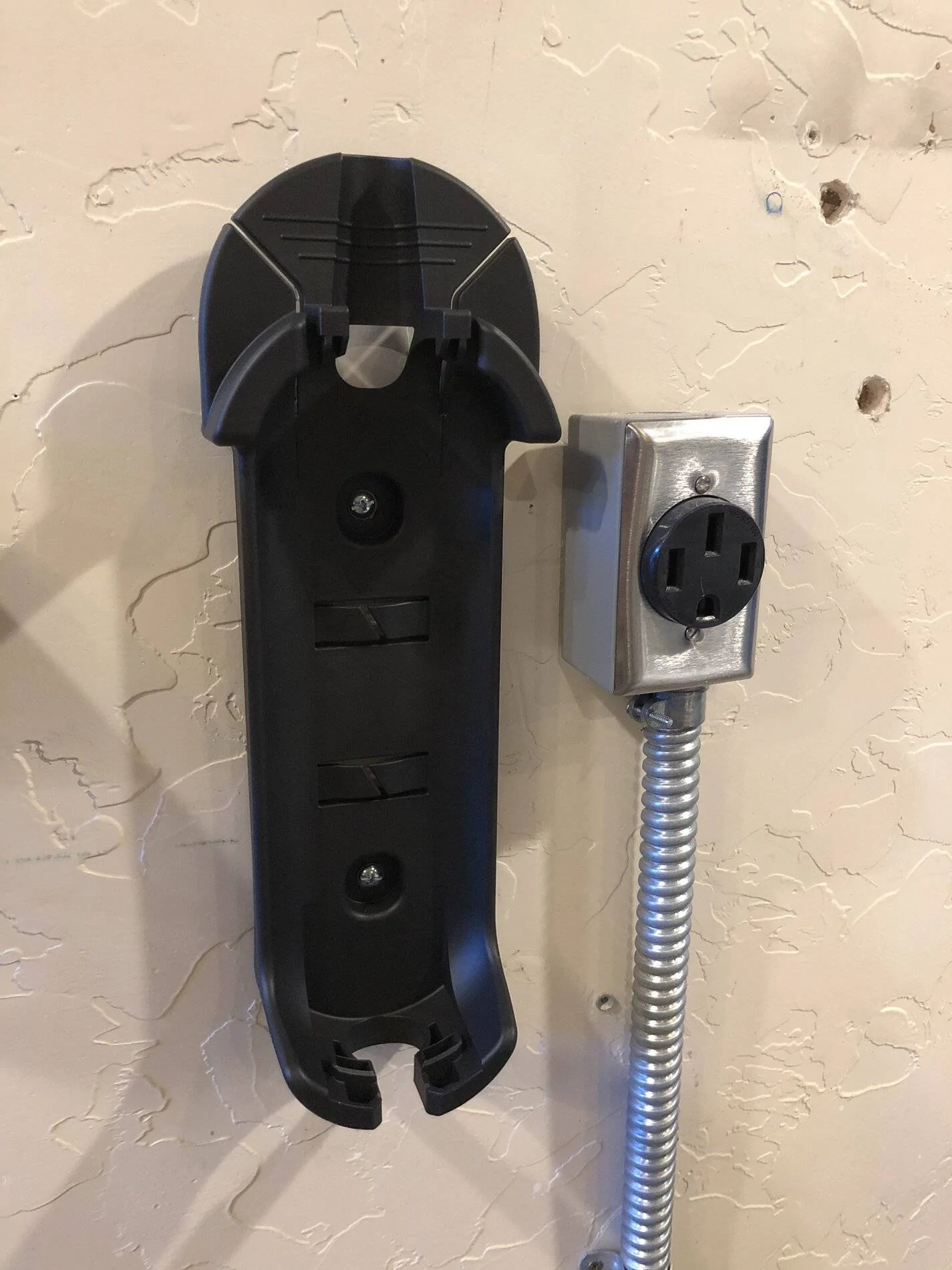

The basic wall mount is the black plastic piece inside the dock. If you don’t want to use the dock just remove the two torx screws and the mount the plastic piece directly to the wall. I was going to install the dock and decided it was over engineered for a garage install and just installed the plastic piece.
The plastic wall mount is two parts that have to be joined first (press fit). The smaller part is the latch that allows you to make the PMCC mobile.

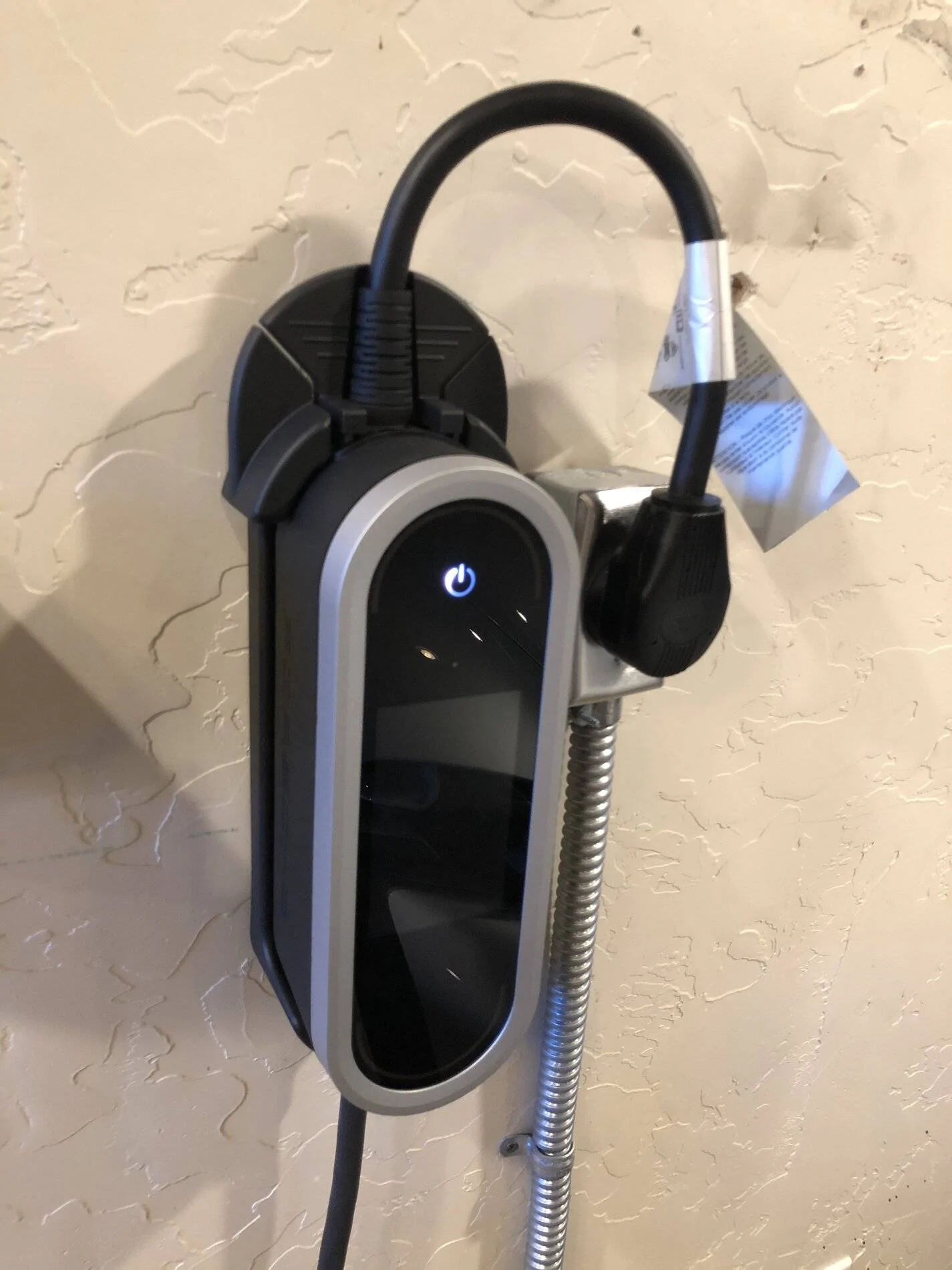

This is my setup. Again, the black plastic piece was taken directly out of the dock.
Very nice. Someone pressed the two parts together for you. The top latch is a separate piece.
I have the basic mount. It looks very similar except for the cord guide at the top. I remember pressing the two pieces together during assembly.
