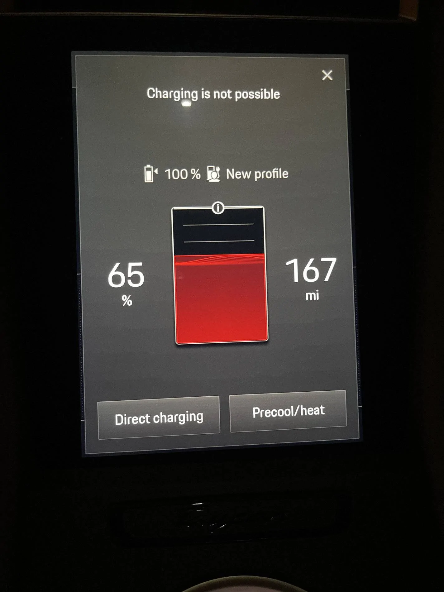

Yes, unfortunately I have seen that message a few times. I'm in Florida too. Usually, you just have to unplug, wait for everything to cool down and then try again. Not very comforting though.
I presume you have seen the other threads regarding the temperature issues relating to the PMCC. Coincidentally, I went to charge last night for the first time time in a few days and upon plugging in the charger to my car, I got the following:
I unplugged the car, waited a few minutes and then plugged in again. Message went away and charging was fine. I am, however, based on Porsche's latest recommendation, charging at 32 amps instead of the full 40 amps to try to help limit the heat load on the charger and my circuit breaker.

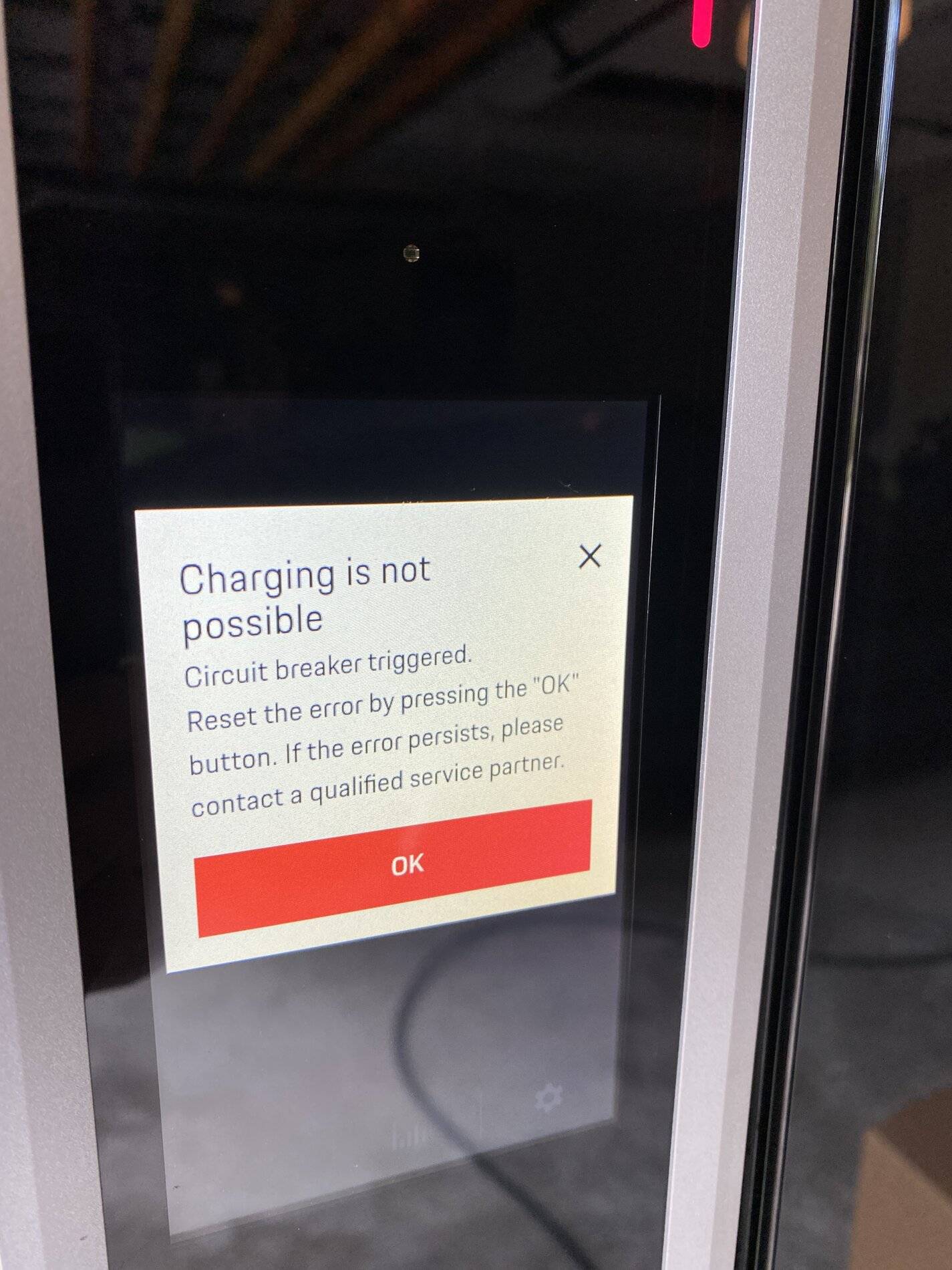

Sorry to hear that. My car and charger are going back to the dealer on Friday because my charger is occassionally giving me that "Charging Not Possible - Circuit Breaker Triggered Error". Seeing that several forum members are getting replacement chargers, I am going to request a new charger as well. Even though it won't help the temperature issue unless they have changed the adapter cable, at least Porsche NA will continue to see complaints about the ongoing problem and address it sooner rather than later.

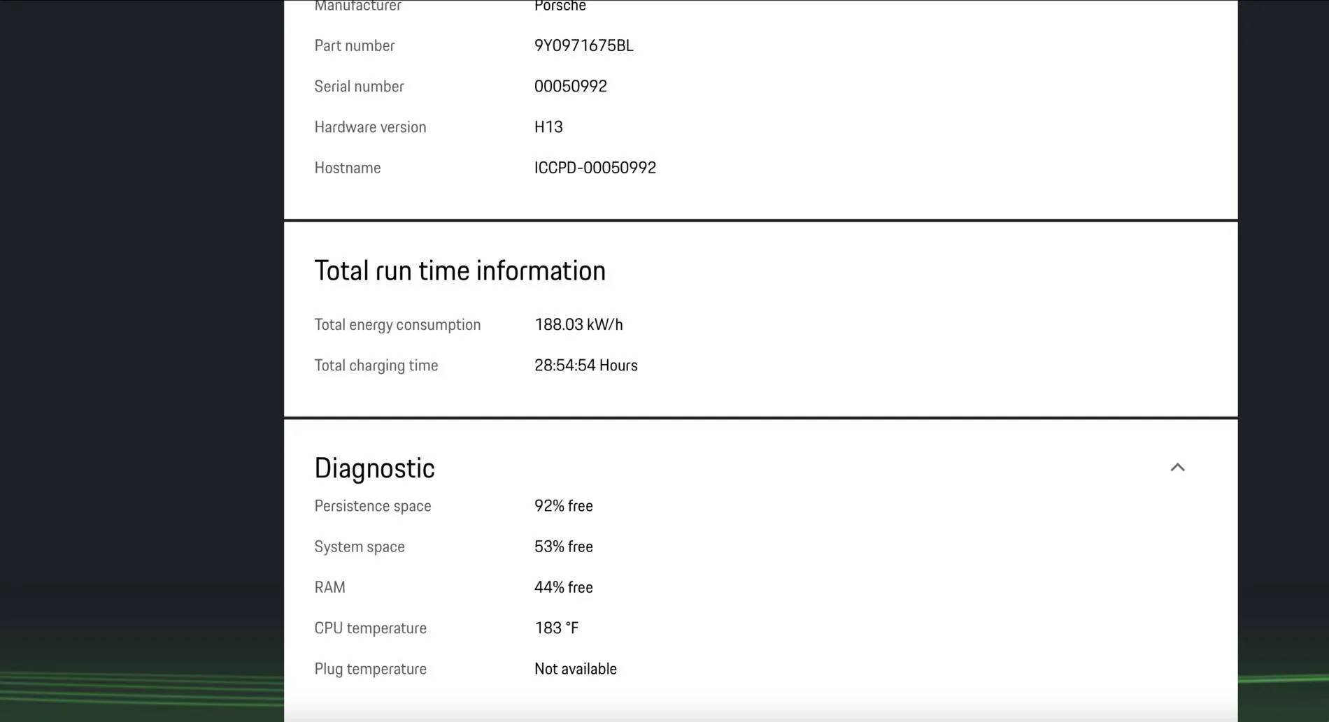

My internal CPU temperature is 183 degrees. Is this too hot?

183 deg. F is hot, but not overheated. It does depend on exactly how/where the diagnostic code is measuring the CPU temperature. That said, cooler (< 160 deg. F) is better for longer life, but the difference between 160 and 183 is potentially the difference between 25 year life and 20 year life (just to put that in perspective so you don't worry). Something in the charger will fail before the CPU fails at 183 deg. F.

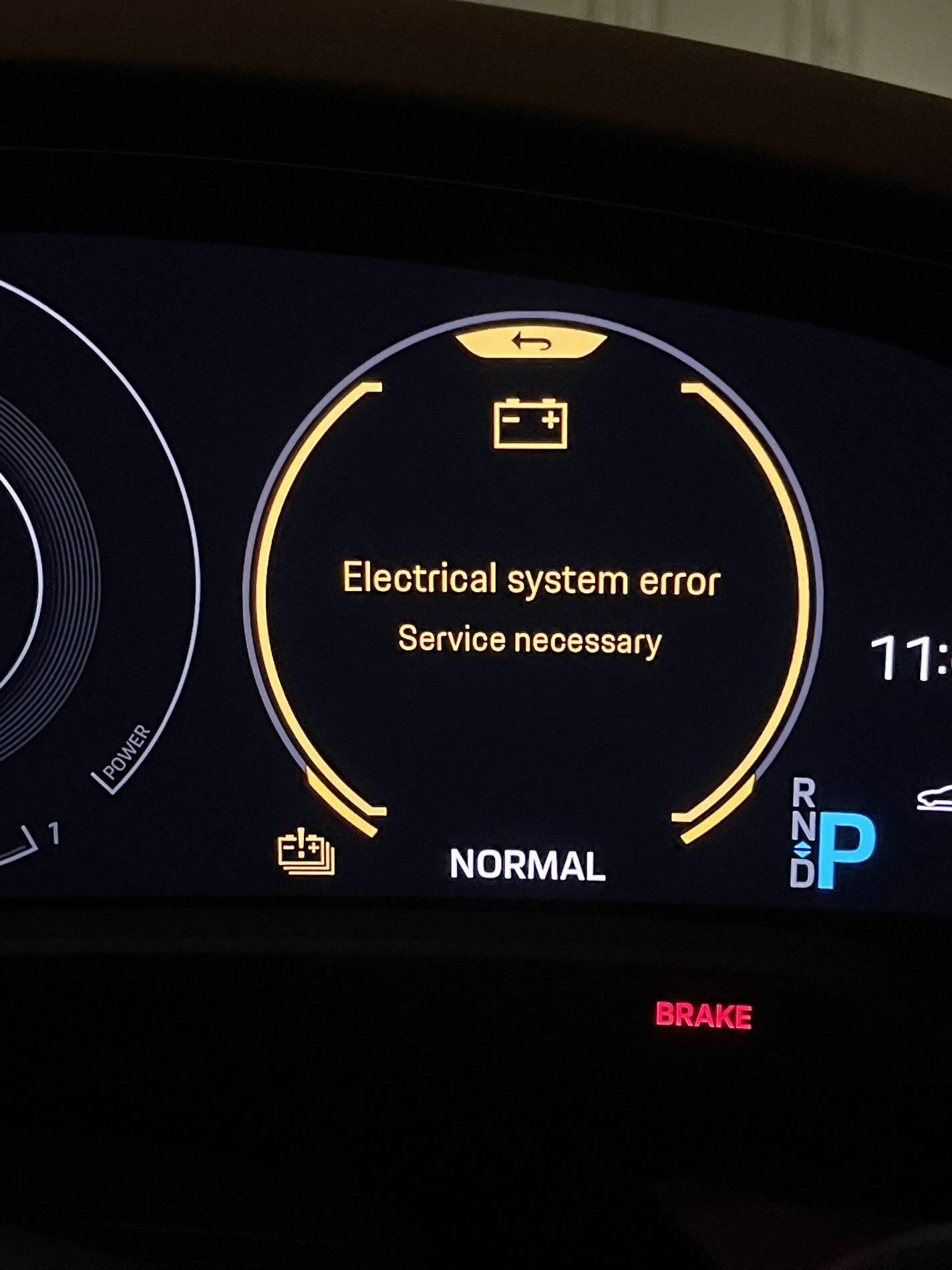

Well, the unit got very hot to the point where I did not feel safe with where it was located. Then it went from bad to worse from there.
Porsche Taycan PMCC - Overheated Error Messag
Porsche Taycan PMCC - Overheated Some 3 hours later

I was referring only to the CPU temp. With the rest of the PMCC getting too hot to touch, I'd be wary of a bad internal connection and I'd take it into the dealer - especially given the in-car errors you have encountered.
