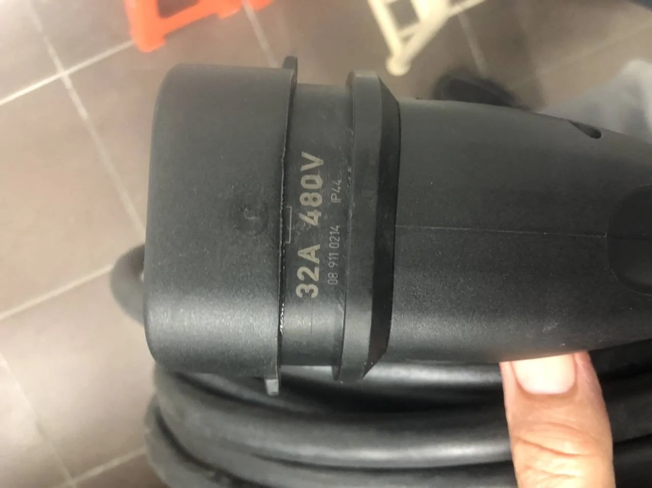

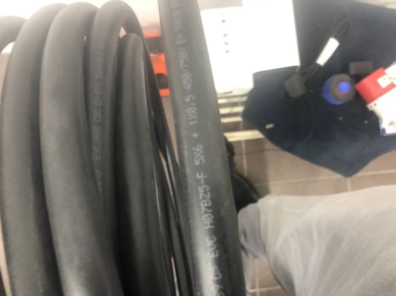

@Ron-b here are two photos of my cable in Europe. Rated at 480 volt and 32 amp. It is three phase and came with the Porsche charger that is good for 22 kW charge! The cable is the 25 foot one, (7.5) meters. I have no idea what that will mean in the US though if you do not have three phase?
Thank you for the photos Peter, I'm sure it will not be three phase in the US as it will be the J-1772 not the IEC 62196 Type 2 (Mennekes) connector. But I am hopeful that a US cord is equally overrated.

10 Gauge wire (10 AWG) in the USA is rated for a 30 amp circuit, 24 amps continuous. You double (or halve if smaller) the current every 3 gauges. A 60 amp circuit would require 7 gauge wire. A 50 amp circuit (40 amps continuous, e.g., NEMA 14-50 socket or plug) would require 8 gauge wire.
Well I was guessing on the AWG based on the area of 6.0mm², I was looking at https://www.jst.fr/doc/jst/pdf/current_rating.pdf
Which showed 50A for 5.26mm² though that is a French chart.
The table shows the rating of a single wire in free air (able to dissipate heat), however, it does not show the temperature so it is a guideline but not a reference. Multiple wires in cables trap heat and reduce their single-wire rating.. 50 amps in two 10 gauge wires produces a lot of heat:
  • 10 Gauge copper wire is ~1 milliohm (0.001 ohm) per foot
  • Power = Amps^2 x Resistance
  • Power in 1 foot = 50 x 50 x 0.001 = 2.5 watts per wire
  • Power of 2 (10 gauge) wires @ 25 feet = 2.5 x 2 x 25 = 125 watts
125 watts trapped in a cable is a lot of heat and high risk.
This table aligns with USA National electrical Code (NEC):
https://www.thespruce.com/matching-wire-size-to-circuit-amperage-1152865
Electrical current is measured in ampacity, and each wire gauge has a maximum safe carrying capacity. For standard non-metallic (NM) cable, these amperage capacities are:
Amperage Capacities for Standard Non-Metallic (NM) Cable
14-gauge wire15 amps
12-gauge wire20 amps
10-gauge wire30 amps
8-gauge wire40 amps
6-gauge wire55 amps
4-gauge wire70 amps
3-gauge wire85 amps
2-gauge wire95 amps
These ratings are for standard copper NM sheathed cable
