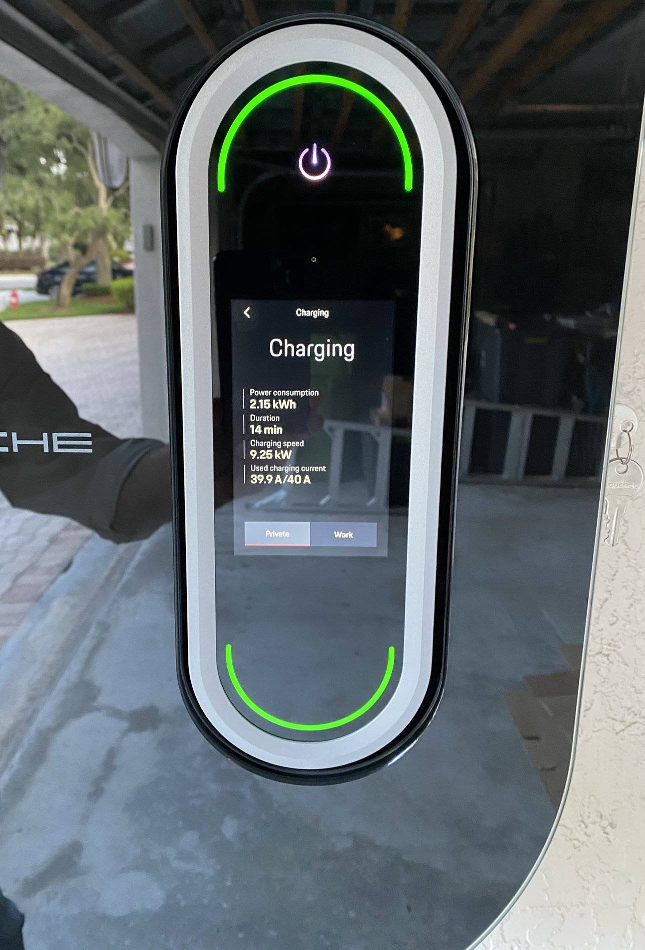

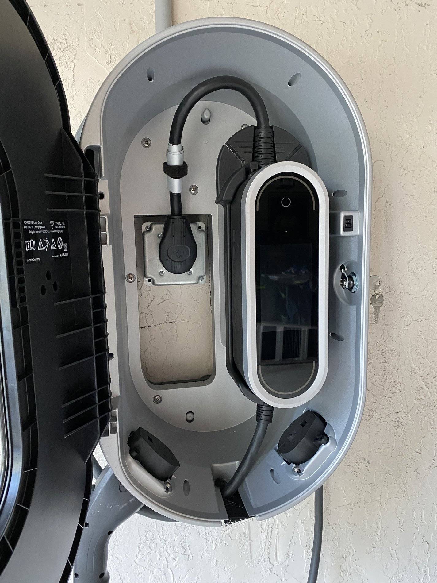

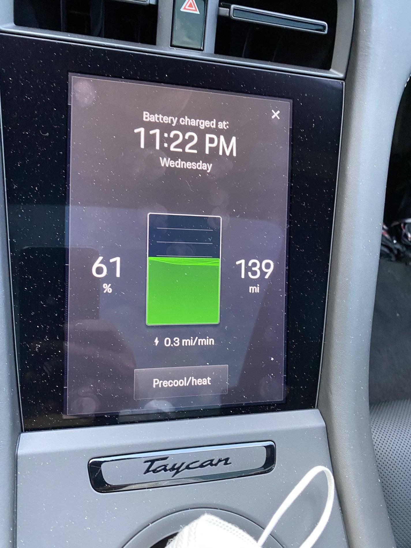

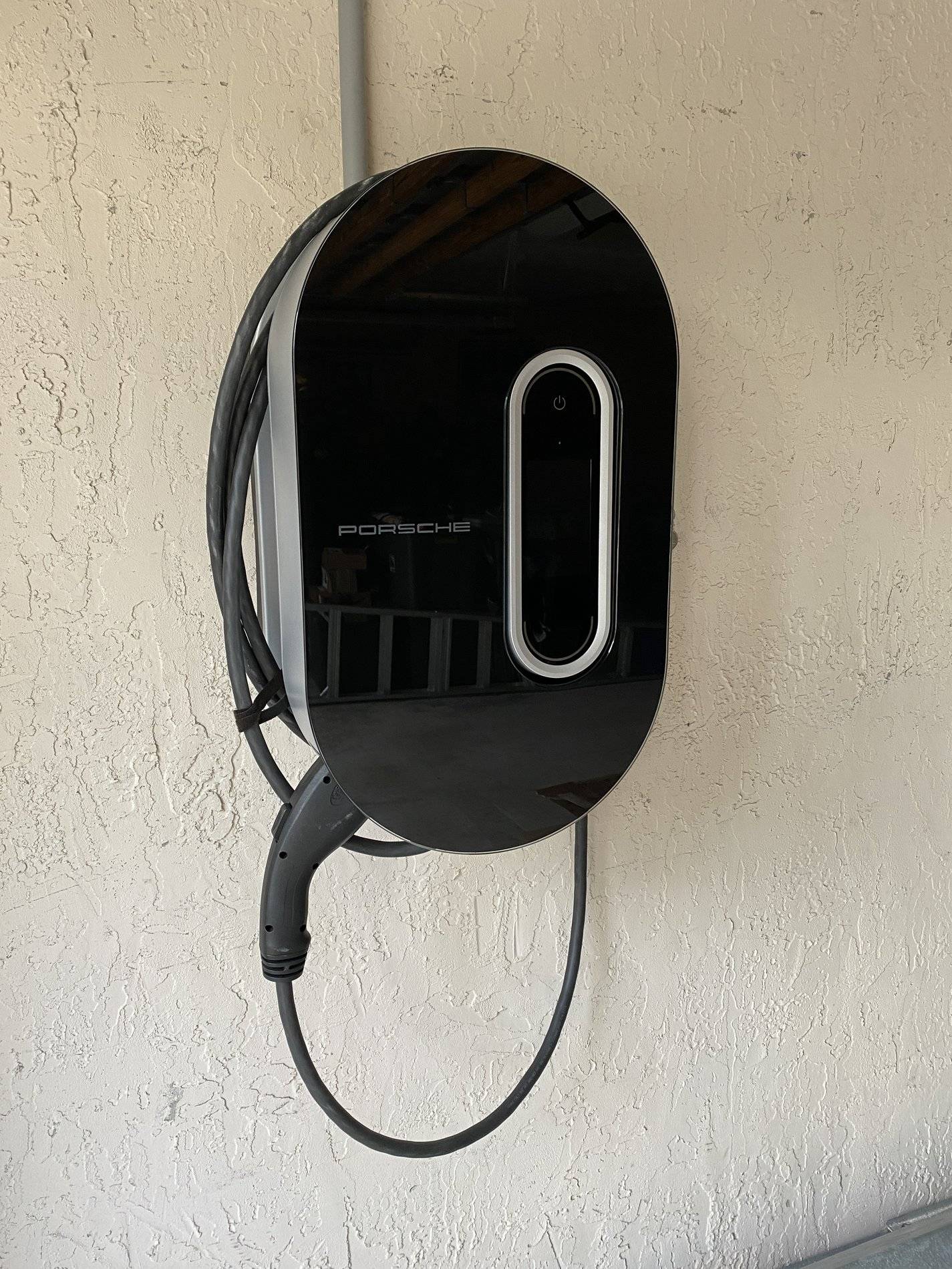

Finally got my Mobile Charger Connect and Porsche Dock installed - 50 AMP circuit with NEMA 14-50 outlet. Here are some pics. You can see at 40 amps I was getting the .3 mi/min at 9.25 kW speed. I plugged it in when car was already at 61% SOC so car was showing it would take 4 hr 20 min to finish to 100% - I didn't program 80% limit since I was just trying to see how long it would take.

Thank you for all those great pictures @HelfFL that was super useful. You know in the car if you click on the 0.3 miles per minute it will toggle and show you kilowatts.

Yes sir. But as someone pointed out, you can't get the miles per minute on the Mobile Charger Connect. The Mobile Charger Connect does show the kW of use. The charger display should show both like the car display. I'm just glad to have the charger installed now - relieving me of some range anxiety. Plus, in typical Porsche fashion, the dock's appearance is really nice and makes storing the 25' cable easy and neat.

I don't think you'll find that miles per minute number very accurate as it is based on a very pessimistic assumption for the efficiency of the vehicle. If you do some more driving let me know what you have for a consumption figure on the driver console in kWh/100mi I am very curious then figure a 10% loss while charging so you are probably getting 8 to 8.3kW to the battery. I believe the Taycan will give about 3mi/kW so 24mi/hr or 0.4mi/min but I maybe over-optimistic. ;-)
Also I agree with how good that dock looks. I was never thinking of getting it before but seeing your install makes me think twice.
