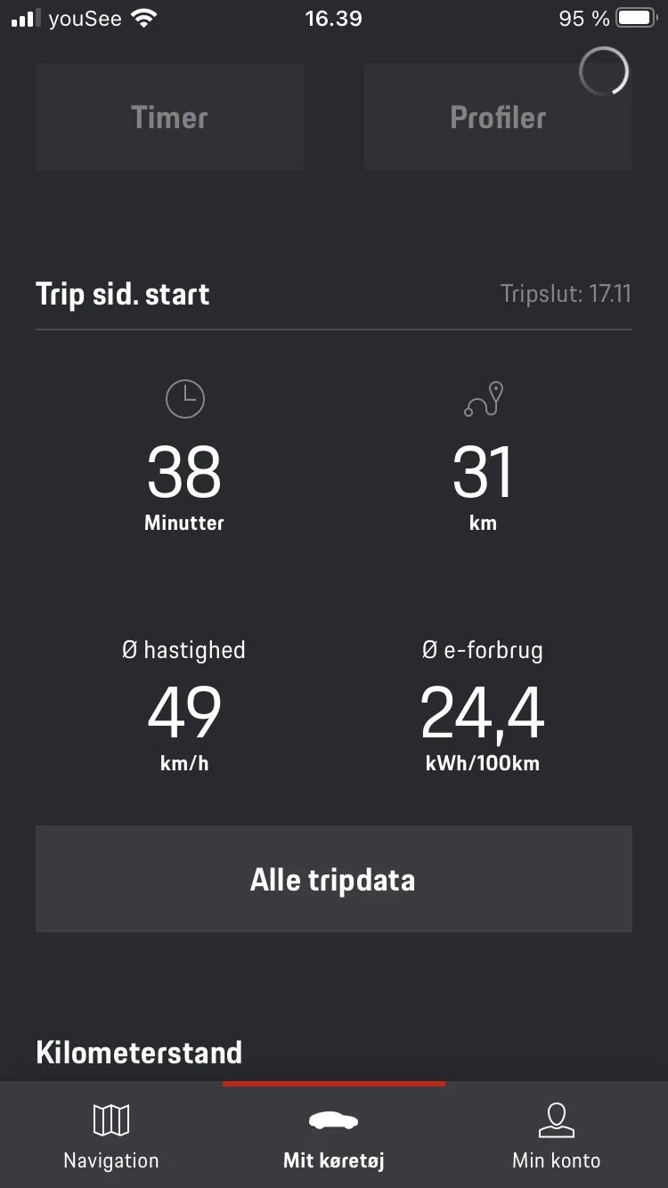

Drove a trip yesterday at 31km / 19.4miles. Consumption was low due to few stops.
Preheated the car for 10-15 min before departure. driving mode "Normal". Battery temp at start was 3C / 37F. By the end, the temperature had only risen to 4C / 39F.
I have not experimented much with how to increase the battery temperature in winter, but have only once seen the temperature rise rapidly in connection with fresh driving on a winding road in "Sport Mode".
