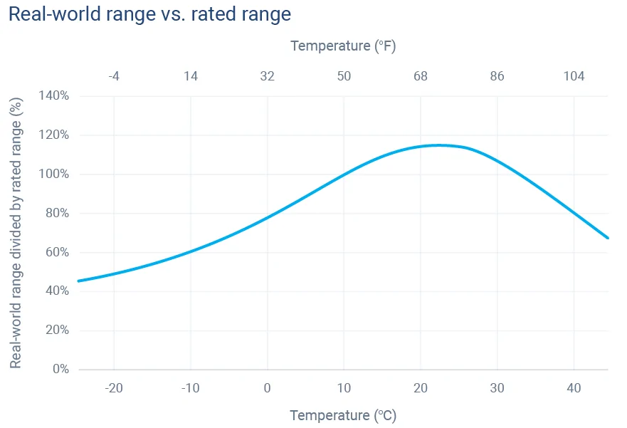

Temperature makes such a big difference. I can now easily get over 400 km ( 240 miles) in spring time, however that is not driving on flat ground. It is down hill 550 meters 1600 -1700 feet) and return back up. A normal 996 takes more than 16 Liters /100 km driving the same stretch. That is about 50 % more than driving on a flat motorway at constant 130 km/h!!

Today it’s 13C, 63% humidity, car is in the garage, 85% SoC, range 204 miles (equates to 240 miles max), car parked but Range Mode will add some miles. The high numbers above in the thread don’t assume Range mode. It’s almost like use of the heater (rather than the chiller) saps significant energy. As a rule I vary between 21C & 23C at this time of year.

Humidity? Probably not. Range, if done under the same conditions in any location in the world, should be the same. It's just hard to get the same conditions and lots of information is left out when you do see test results reported. If your speed is low enough (50 mph?) and not too cold outside, you can easily get 300+.

I can vouch for that from a UK perspective. Back in July I was getting 270 miles plus of range (20', Turbo, Normal mode, Eco at 20C/68F). However, from numerous posts over the last 6 months, you will see that my range plummeted once we got to October/November. Small changes cause huge changes in range. I'm actually pretty sure humidity makes a big difference - in Oct/Nov/Dec we were getting humidity in the 90-100% range. That makes a difference if on a speedy motorway drive. In a UK Winter, unless you pre-heat the battery, you are getting closer to EPA figures, especially on motorways with 70mph+ speeds.
Took the car out today for the first time in over 3 months, and with the unusually warmer temps, consumption was around 35kWh/100miles, which is way better than I was getting pre-lockdown. Let's see if we start getting the high range figures once we're in the Summer. If not, then my battery has degraded in a year!

I know you all enjoy beating the EPA estimates in a Taycan; however, I have yet to see anyone taking on a long trip here in the desert Southwest when it gets to be 105F-115F (41C-46C) as it does in June, July, August & even early September. This is particularly hazardous when driving along our somewhat desolate at times Interstates and US Highways where cell phone service can be non-existent. A trip like going from Phoenix or Tucson AZ to Las Vegas NV isn't safely & comfortably possible in those heats unless you get 230-250 miles on a 100% charge. Speed limit on the Interstate 10 is 75 mph and if you try to go that speed the 18-wheelers will pass you by. One has to drive 80-85 mph, with the full AC on to maintain 72F-75F (22C-24C) cabin temperature. Also, recharging at a Level 2 charger is impossible. The Taycan's heat-pump based battery temperature control system takes all the juice just to try to get the battery cooled down below 100F (38C) when trying to use a Level 2. Even using a DC Fast 50 kW charger can take over 2 hours when its that hot to charge to 80%. The cabin pre-cool feature doesn't work when the SOC is below 25%. As pointed out, Range can't be used after recharging in that heat for at least 30 minutes.

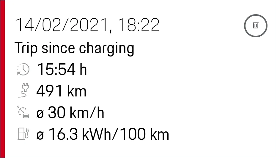

Absolutely no disrespect. I find it very hard to believe that anyone gets 300+ miles of range, sorry.
I don't think you can get less than 300 miles, if you
1. drive in regular traffic, no highway speeding
2. take it easy on the acceleration
3. switch off recuperation options
4. seek and use traffic opportunities for letting the car coast
5. drive in temperature where you do not need the AC, open window sometimes
6. live in a flat landscape
7. avoid traffic lights
Porsche Taycan Taycan 4S gets 323 mile real world range in Edmunds EV range test! 1618484798278
I always charge to 100%
Just keep an eye on your average consumption.
Porsche Taycan Taycan 4S gets 323 mile real world range in Edmunds EV range test! 1618485146394
Same works for constant higher speeds on highways, but consumption goes up a bit of course. The consumption here is also a bit higher because on one leg of the trip, I was rushed to get back and drove Porsche style. I also started to used the AC again - getting hot here!

Alas, not in UK - nowhere near. 240 miles is my max so far, always use RANGE mode (ECO PLUS on Climate) on long journey. For example journey to Edinburgh from Aberdeen is 98% (or more) a motorway / freeway / dual carriageway and speed is a max 70 mph. Distance 126 miles mostly flat and light traffic (so cruise most of the time) generally end up with 14 - 16% battery (if I can’t stand the cold) from 85% SOC.
