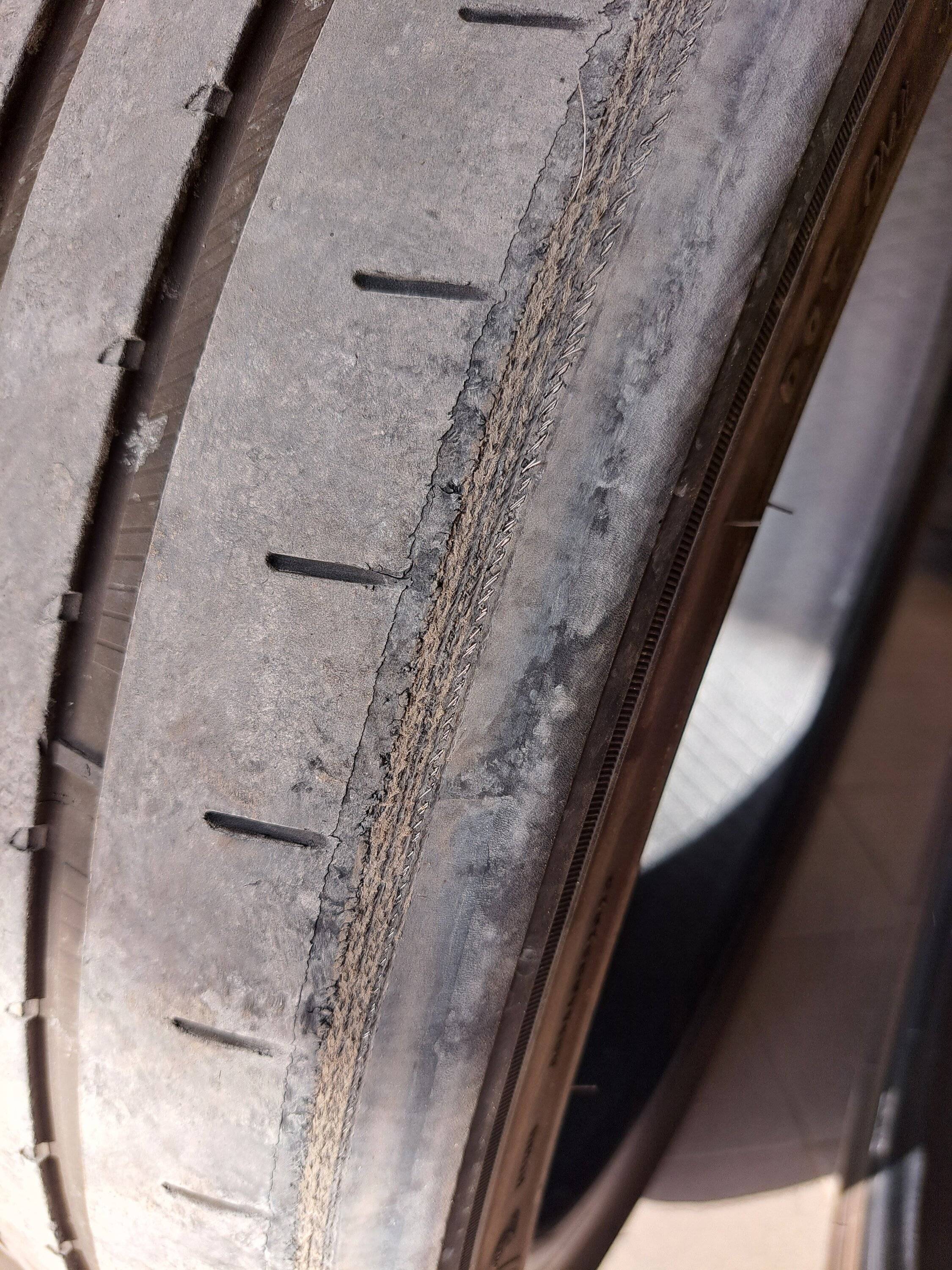

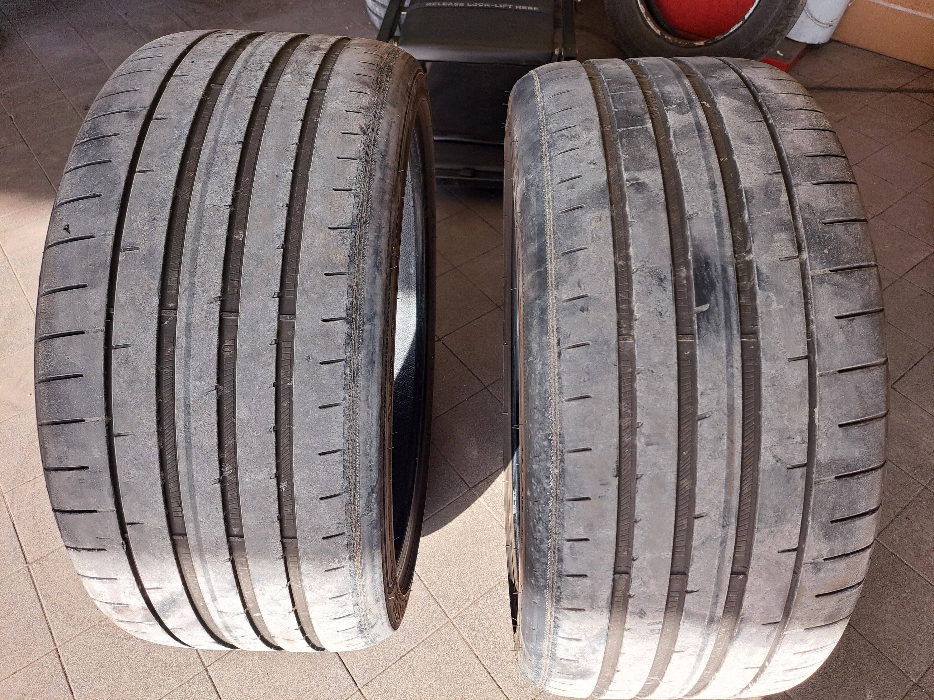

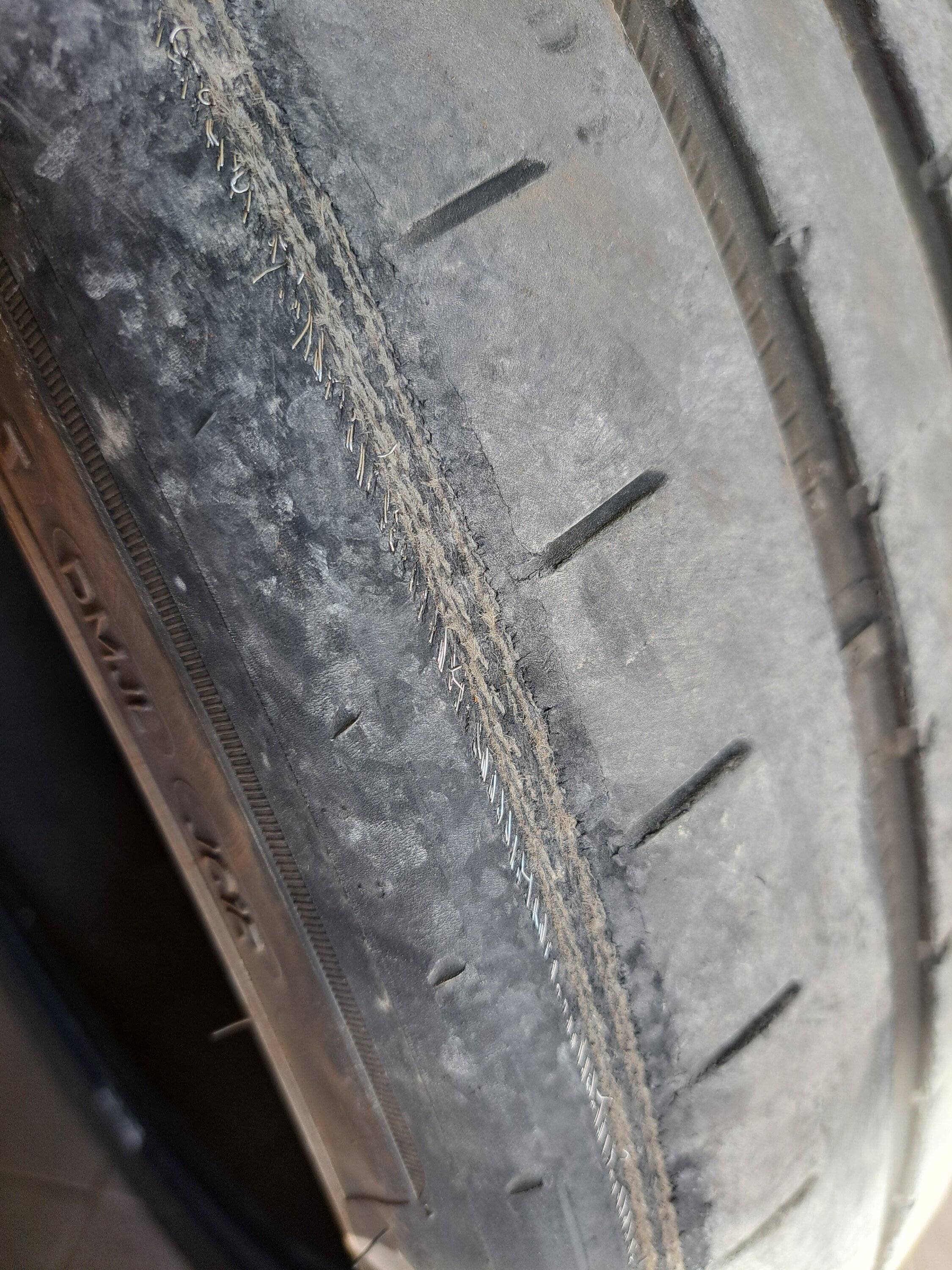

Yesterday I put on new front tyres after 13.000km.
The wear was as in pictures.
The inner border of both tyres is destroyed, the other areas are in good shape.
This is the second time I had to do it, first time the same condition was after 15.000km.
Not so happy about that.

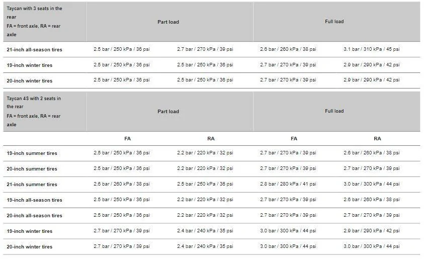

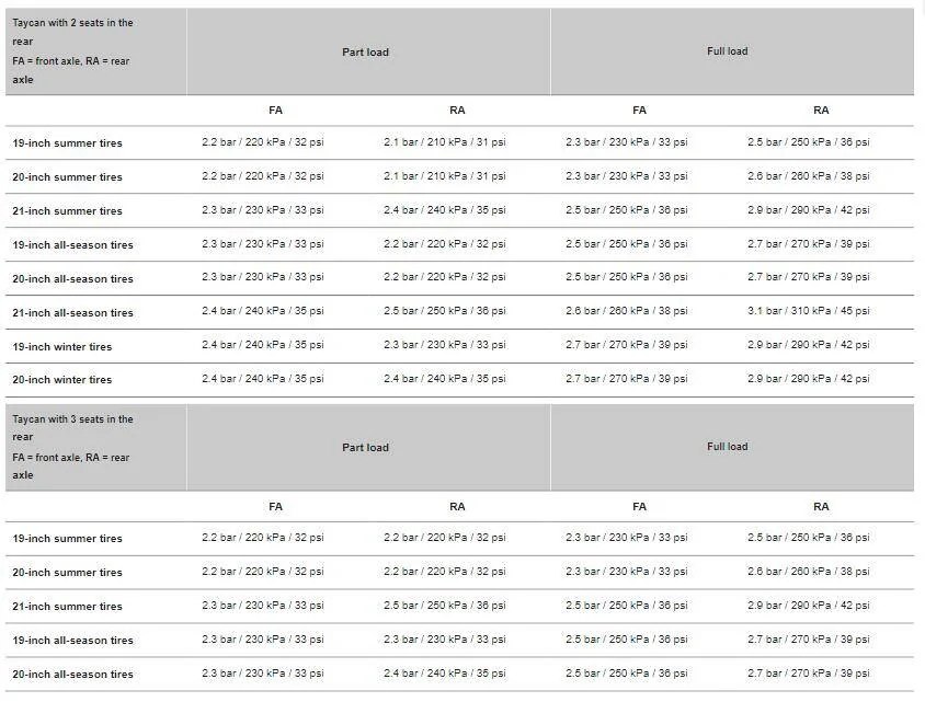

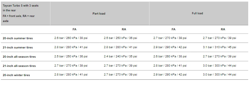

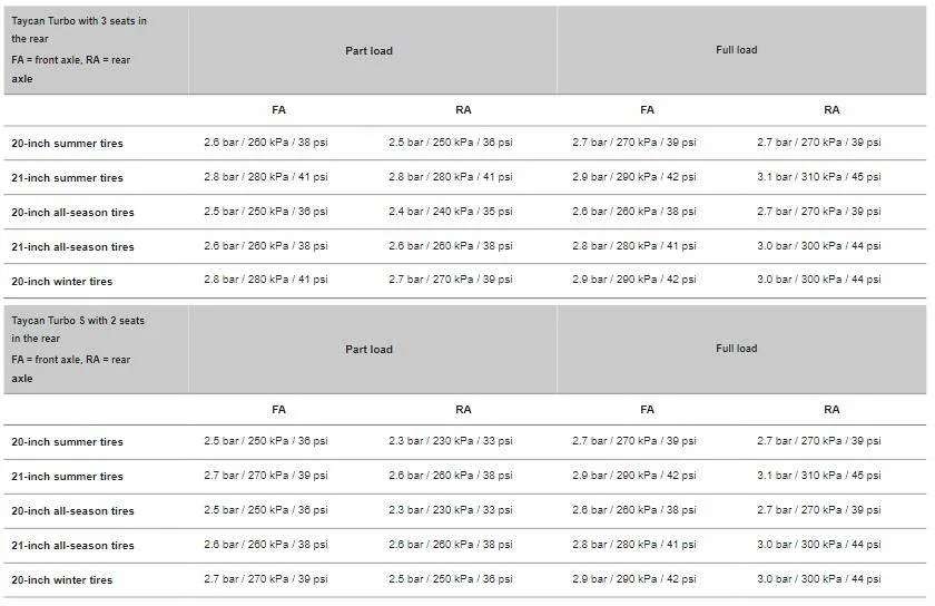

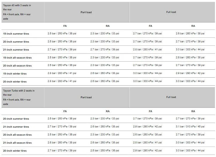

for reference to tire pressure, seems variations depending on spec/tire/load:
Porsche Taycan Owner's Manual (Page 283 of 302)

Was beginning to doubt mine - thanks @CxM for posting the guidance. Air pressure without specifying the wheel size/tire compound is a bit misleading. I'm running 35-36psi cold all around on 20" all seasons. Tire wear is negligible (and even) after 10k miles.
They need to add the #'s for the different tire brands in the manual.
I think your tire info plate should have more specific #'s to the tires your spec came with.
For CT/ST and GTS specs:
