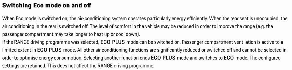

RE: ECO Plus, fully aware of this, nothing new there and not the point. The query was specifically w.r.t. std AC vs ECO and as to whether it operated on as I called it "low power conditioning" BUT still has AC on.
Thus, the only mode that seems to allow for pure air flow with fans with NO AC is in ECO Plus and only in RANGE mode.
IMO there should be a simple climate option described such as " for air flow w/o AC - do this..." - quite odd that we cannot do this other than in ECO Plus in RANGE mode.

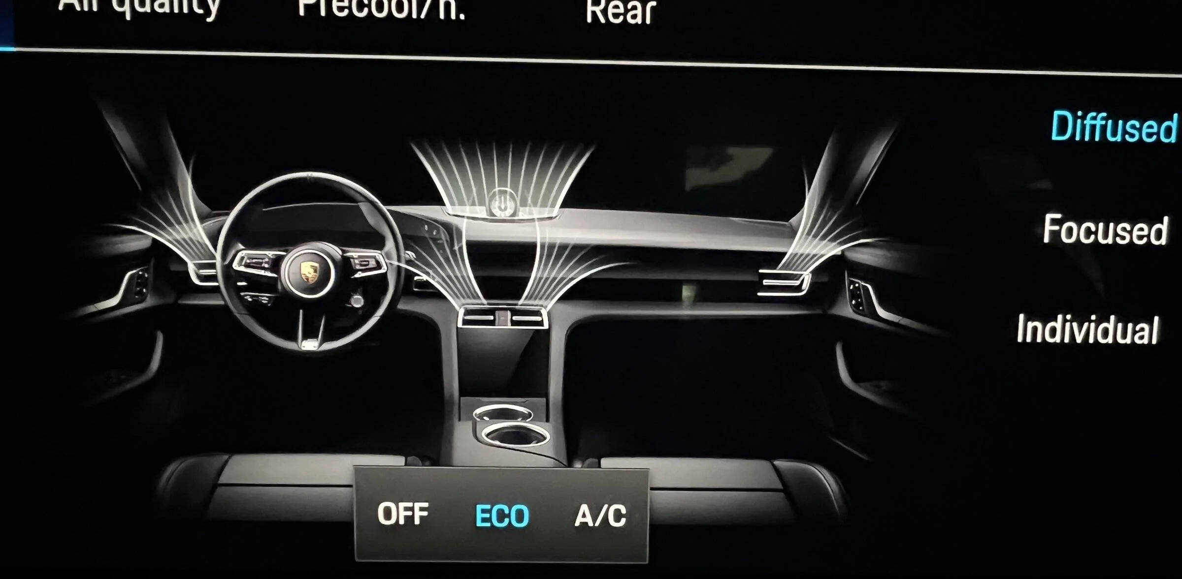

Was just using this ECO option in the car now and here is why I suspect (but stil cannot 100% confirm) the idea that basic ECO mode is not in fact conditioned air but simply unconditioned air flow from exterior to interior and not as has been suggested with some reduced level air conditioning on.
Here is Ventilation with both ECO and AC ON - you can clearly feel the AC effect albeit reduced in this mode:
Porsche Taycan Taycan Secret Tips and Functions IMG_4752
However you can clearly turn AC OFF and leave only ECO on - to any reasonable interpretation this would imply ECO ventilation means simple exterior to interior (or recirculated if chosen) unconditioned airflow.

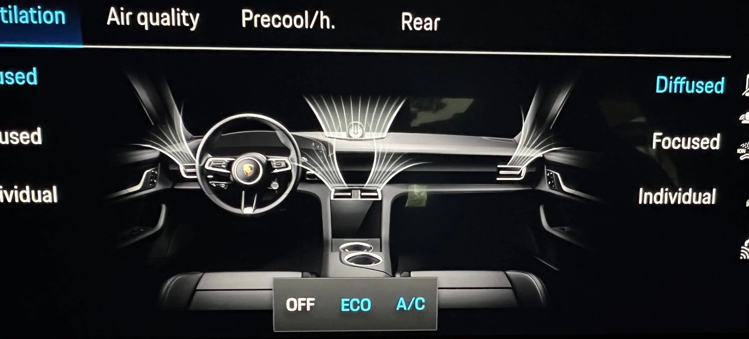

When I had this setup selected today in 72F weather with moderate humidity I could def begin to feel that humidity with AC turned off and ECO on - hence why I suspect ECO may indeed be simple airflow (also different to the ECO Plus management - a diff discussion).
Ventilation with ECO selected and AC OFF - in this setup I could def feel increased humidity and what appears to be no AC as the setting would suggest:
Porsche Taycan Taycan Secret Tips and Functions IMG_4753
Now it may be when you fiddle with temperature settings in the climate panel that this could induce more 'conditioning' but have not messed with it yet to see if by doing that does the AC light turn back on/blue.
Bottomline - if ECO by itself (AC off) does in fact still use the compressor it must be at a truly minuscule level - I guess I need to try and listen to see if I can here it in ECO/No AC setting.

There is a setting when you have AC and ECO off, but have not engaged OFF, there is still air flowing through, which I think is unconditioned. You can press OFF to completely turn off any air flow, or say “turn off ventilation”, assuming we’re mean the same thing.
Ah good one - had not tried this, so - with all three options colored white there is still airflow, correct? Are you saying that you can have ECO & AC white (i.e. disabled) but have OFF highlighted in blue and still have airflow? Too late here to mess with this now but will have a go tomorrow - Cheers, C.
Yes, if you don’t have OFF explicitly enabled, i.e. in blue, and the other two options are in white, then there still is air flow. PCM UI is confusing, but this is how it works at least for me.
Maybe this helps
Porsche Taycan Taycan Secret Tips and Functions 1641816339942
Setting AC (everything) to OFF the outside air supply is interrupted / reduced and the entire air conditioning system is switched off - this will save 100% of energy otherwise consumed but not a practical / wise thing to do.
