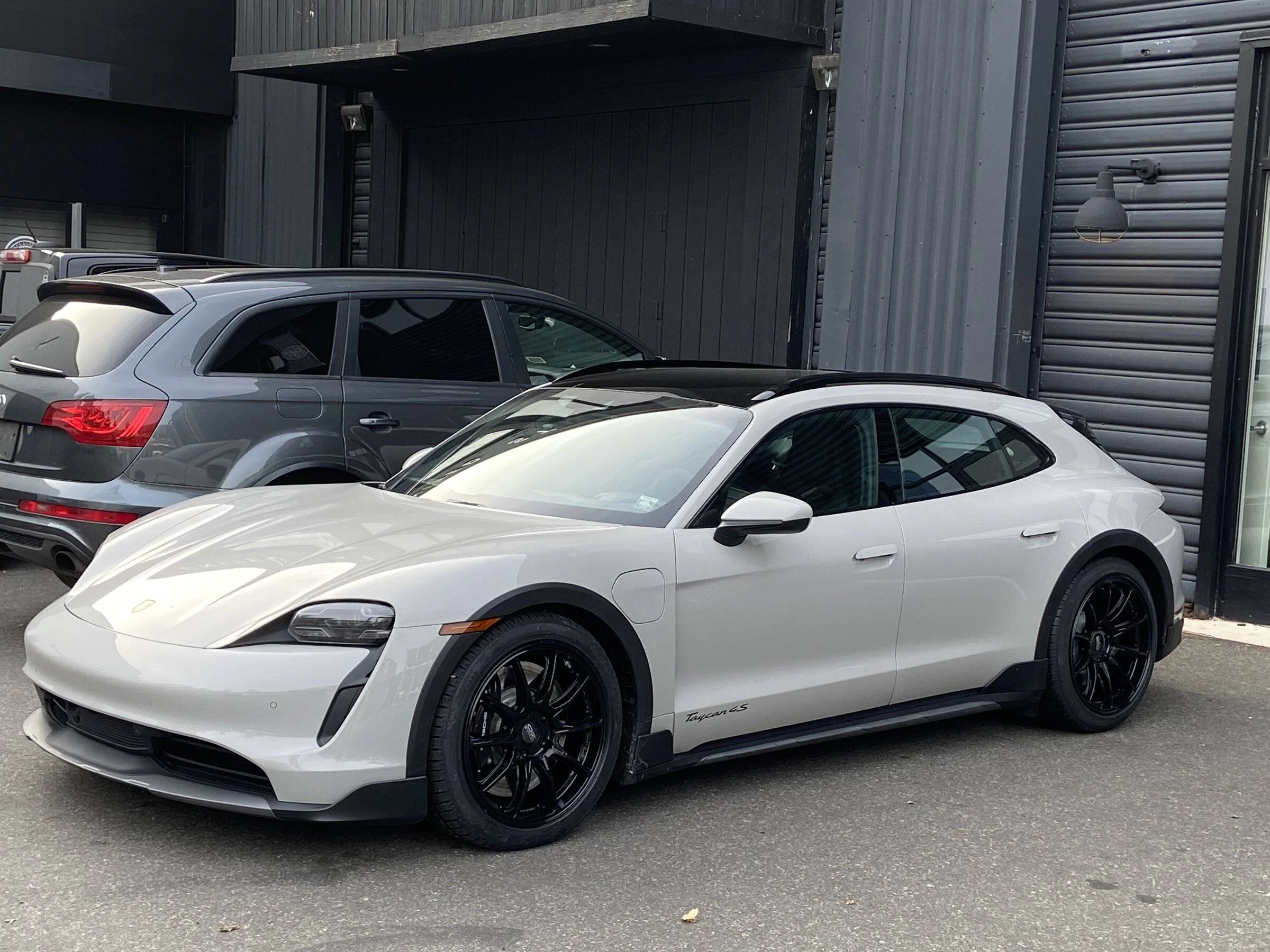

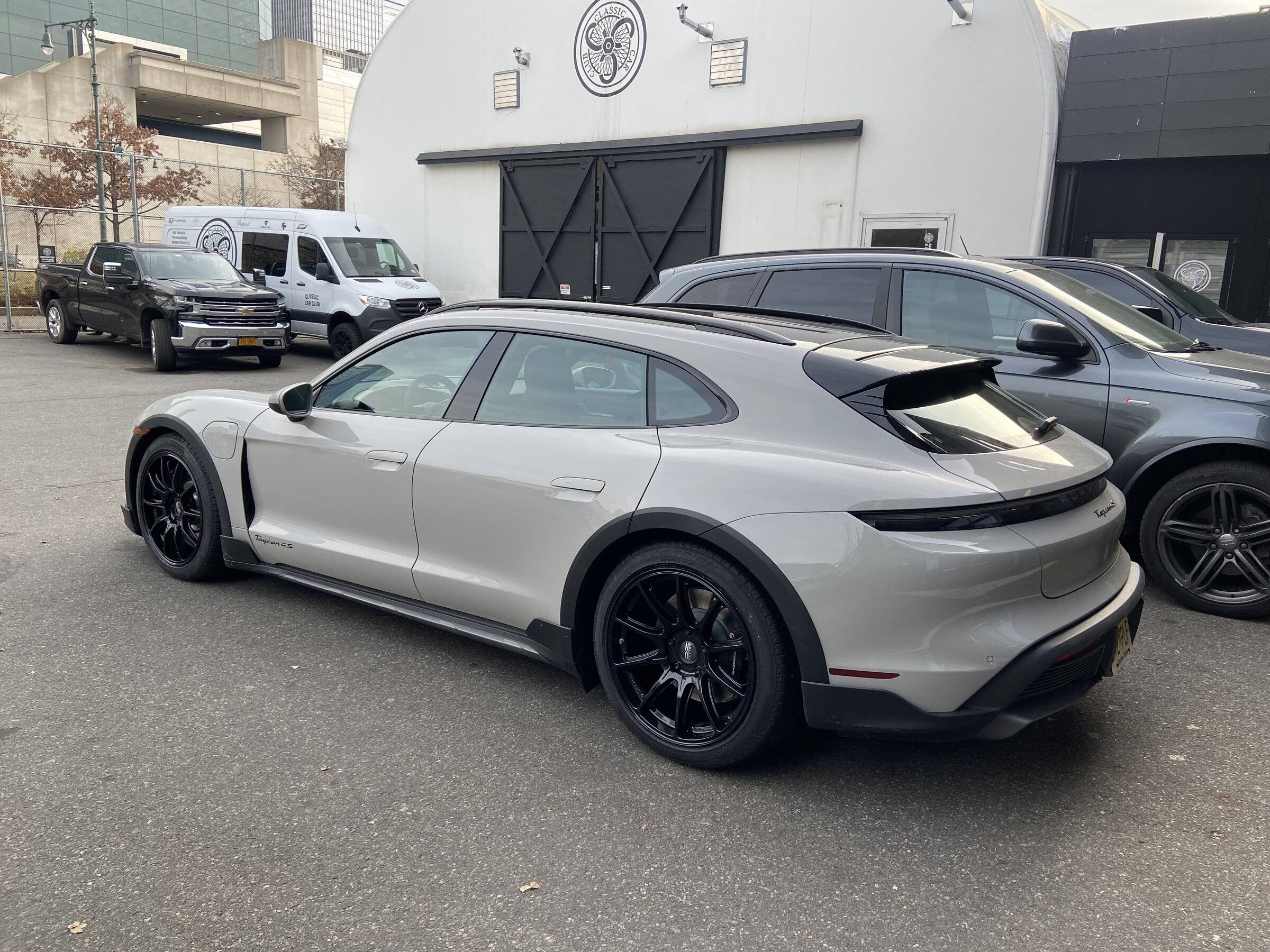

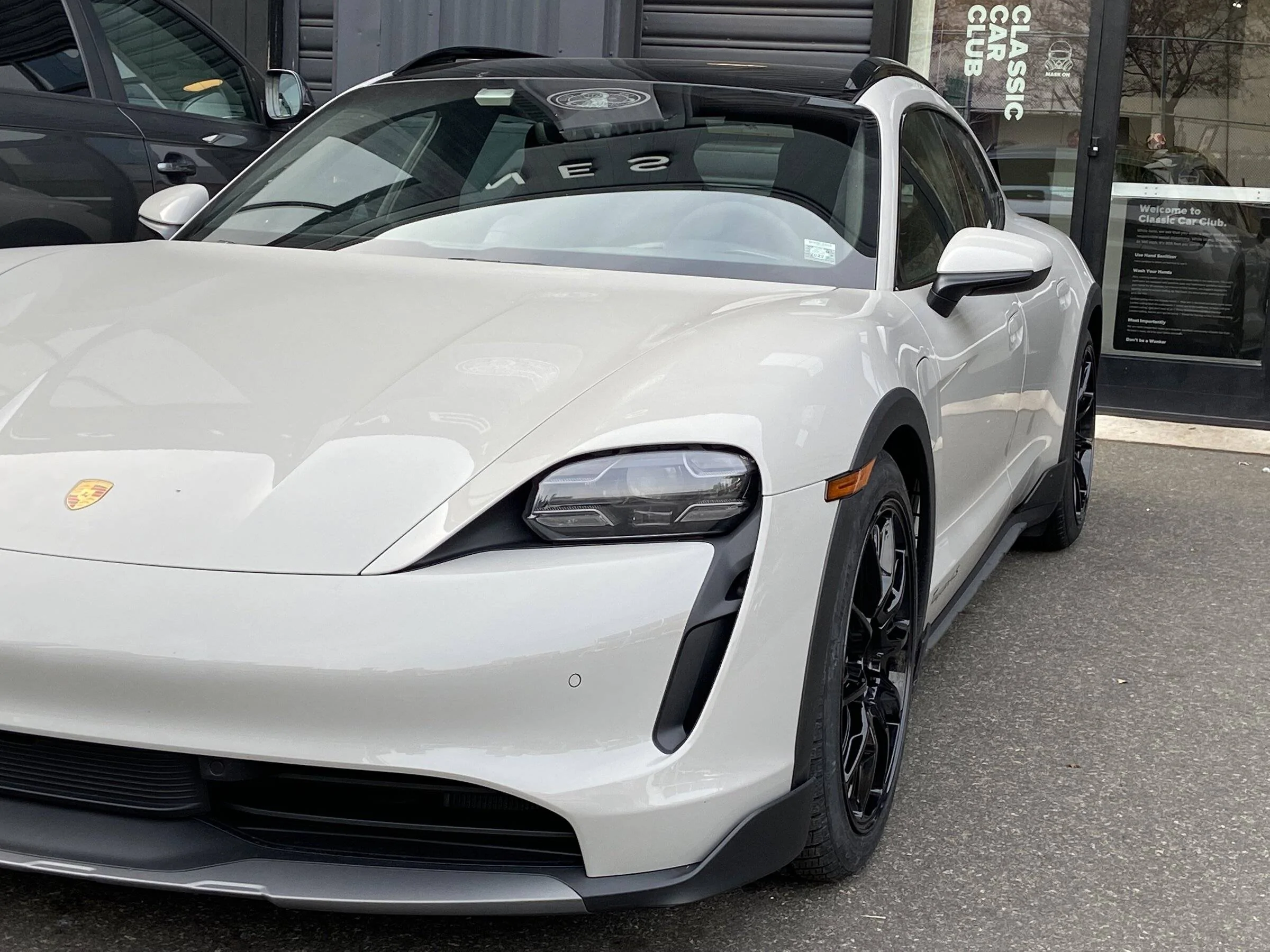

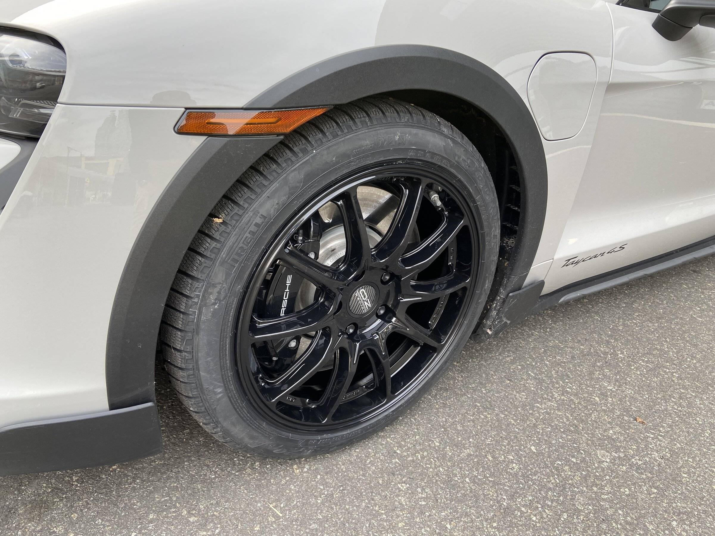

I've tried it now and it works.. answering my own question!
These are
20x9 et 49 O.Z. Hyper XT HLT
20x11 et 55 O.Z. Hyper XT HLT
With
Pirelli Scorpion Winter - 245/45r20 front and 275/40r20 rear
The offset puts them 5mm further out than stock and the rears are .3" shorter than stock, but all seems good with fitment.
While everything is in low supply, I found the 275 rears to give me far more options and the narrow tires probably make more sense in the snow. They're only a sligh stretch on the 11"-wide rims, but totally within the spec of the tire adn they look decent.
I was going to paint the wheels satin platinum, but with cold temps this week decided it was more important to get useable rubber on the car.
My ideal setup would have been 20" Turbo Aero Wheels painted satin black (like the cold weather test mules) with spacers, but I couldn't wait around to find the right deal and locale on used ones. I'll miss the Aurum Cross Turismo Designs, but the O.Z.s look decent and I'm thinking they'll be good for track tires in the summer.
These are
With
How much did it run you to ship to the USA?
