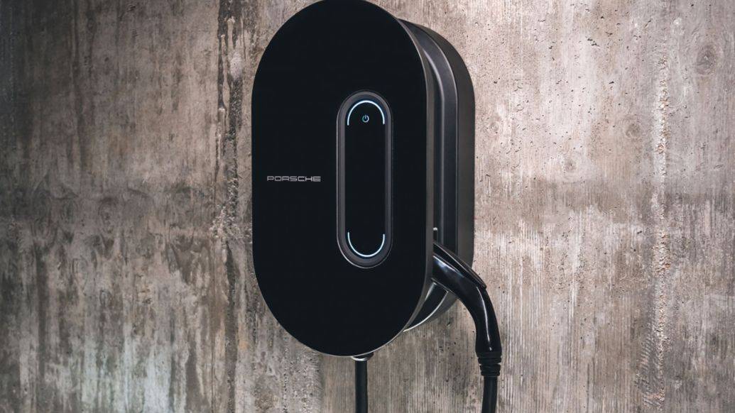

For those wishing to take full advantage of the increased performance of the 19.2 kW on-board charger, a new 19.2 kW Wall Charger Connect is now available via the Porsche Shop (shop.porsche.com).
Porsche Taycan Announcement: Porsche’s new on-board and wall chargers nearly halve Taycan home charge times 192_WallChargerConnect1
Though this charger must be hard wired directly to a 100-amp circuit by a professional electrician for best performance, the unit is adjustable for direct connection with lower capacity circuits. The Wall Charger Connect features a 5-inch touch screen and WiFi connectivity for software updates. Part number for the charger is HCHH0LAA and retails for $1,586.00.
