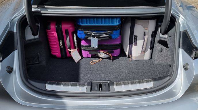

Luggage
This is where I became like Ryanair regarding bag restrictions. I couldn't 'test' the car with bags before the trip so I used the following website to calculate what the boot could hold and to set the initial 'policy' for the trip - https://how-many-bags-fit.com/.
  • The rear boot could easily fit five 'overhead-cabin-bags' (55cm x 40cm x 20cm), plus three rucksacks and two smaller bags (that fit in the two side compartments). The photograph below shows the space available with four of these cabin-bags already packed.
  • I used the front boot mostly for car related stuff like charging cables, passenger high-viz jackets etc., as well as the kids' bulky shoes that they wanted to take off when driving (this kept them easily accessible at stops).
  • I also found extra space for overflow items by lowering the rear seats when the boot was packed - the angle of the seats stop the cases from using all of the available floor space (and there is also extra space between the wheels of the cases that you can get at this way). I kept this area, and the underfloor compartment in the boot, for contingency (that was inevitably required as the trip went on).

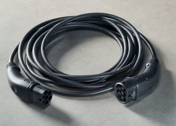

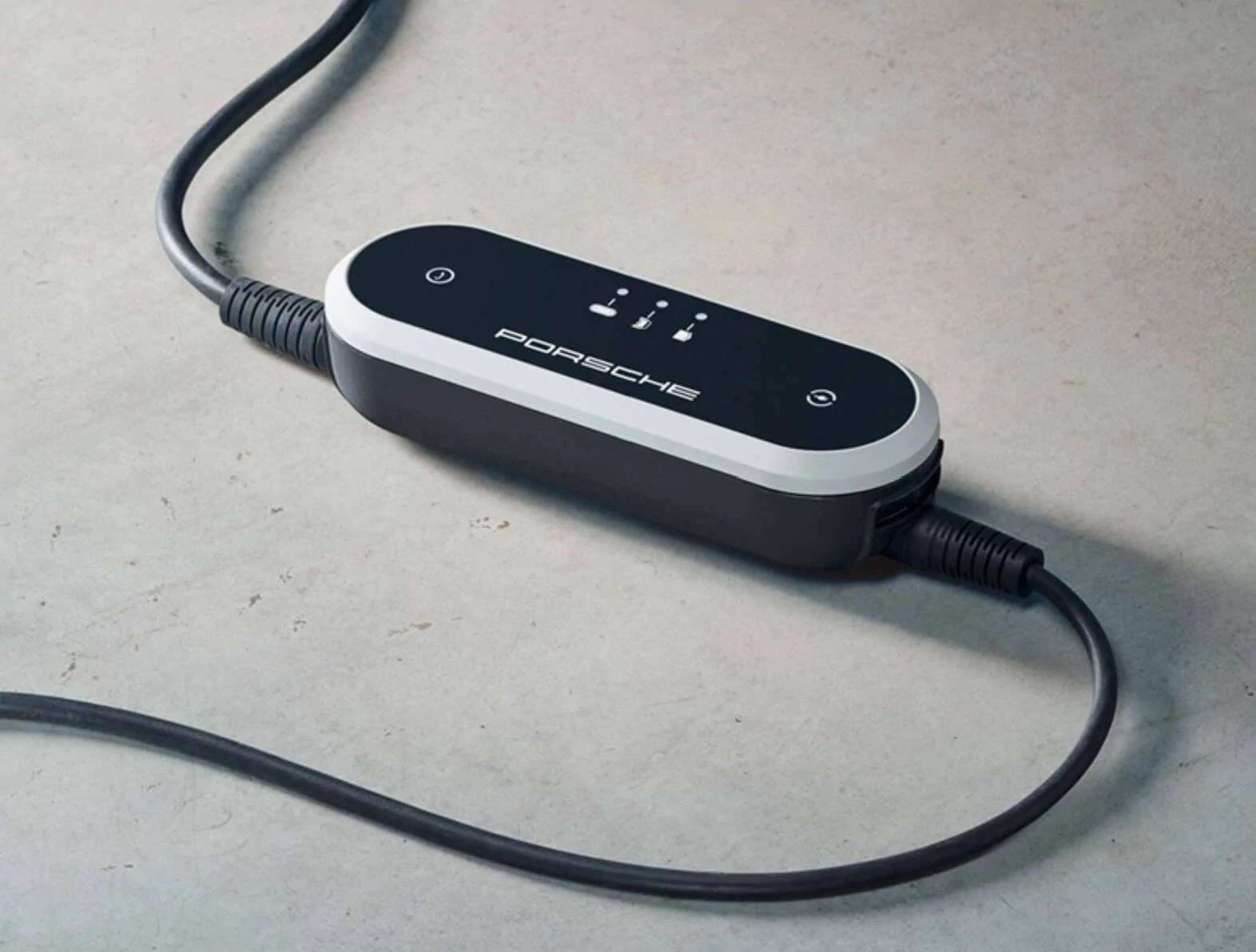

I brought the standard Porsche Type 2 Charging Cable for public charging, and the Porsche Mobile Charger Unit for connecting to domestic supplies.
Type 2 was standard in public charging facilities in each of the countries we visited.
The Mobile Charger Unit only came with a standard UK three-pin plug so I would need an adaptor to use it in Europe - be careful of the load limit of any adaptor if you need to do similarly. I intend to order an original European connector for it, to be safer.
If you haven't already used the Mobile Charger Unit, it needs to be set-up and configured before it can be used! I would recommend doing this before you leave home, when you have good Wi-Fi access for it to connect to.

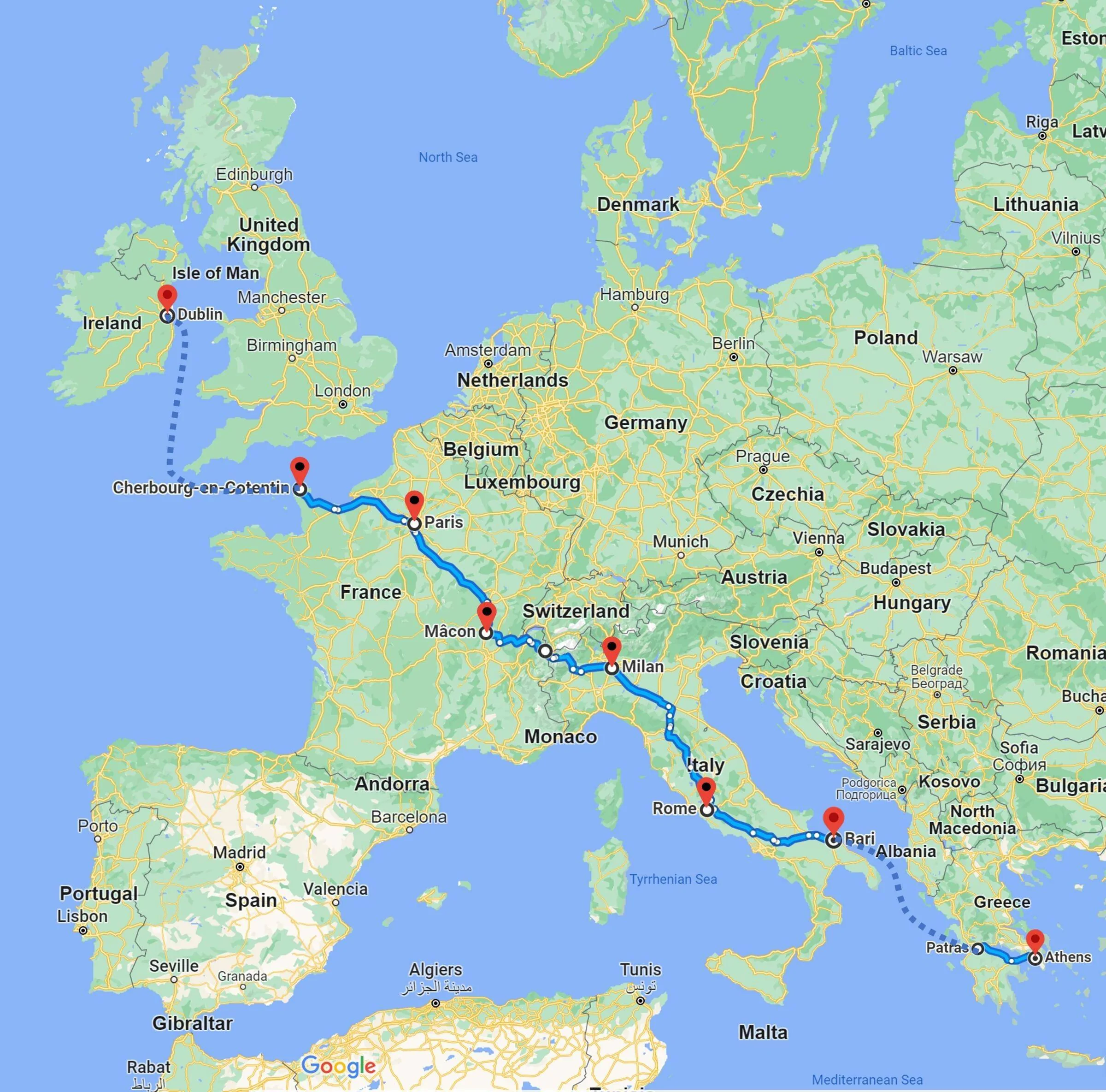

The Route
As a family trip, this was not about getting there as quickly as possible. It was not an endurance test. It was about the experience and experiences along the way. So I planned the route based on circa six hours of travelling each day - between four and five hours of driving with a rest and top-up charge half-way. This allowed us to leave each city after rush hour traffic each morning and arrive in the next city before evening rush hour. It allowed for a more leisurely wake-up each morning and meant that we had time to fit in some sight-seeing in the evening. It also meant that we had plenty of contingency time so we didn't have to be military-like with our schedule.
So our route ended up as a c. 2,500 km trip, which we did over eight days, with the following overnight stays:
  • Dublin, Ireland - Cherbourg, France (overnight ferry)
  • Paris, France (two nights)
  • Macon, France
  • Milan, Italy
  • Rome, Italy (two nights)
  • Bari, Italy to Patras, Greece (overnight ferry)
  • Athens, Greece

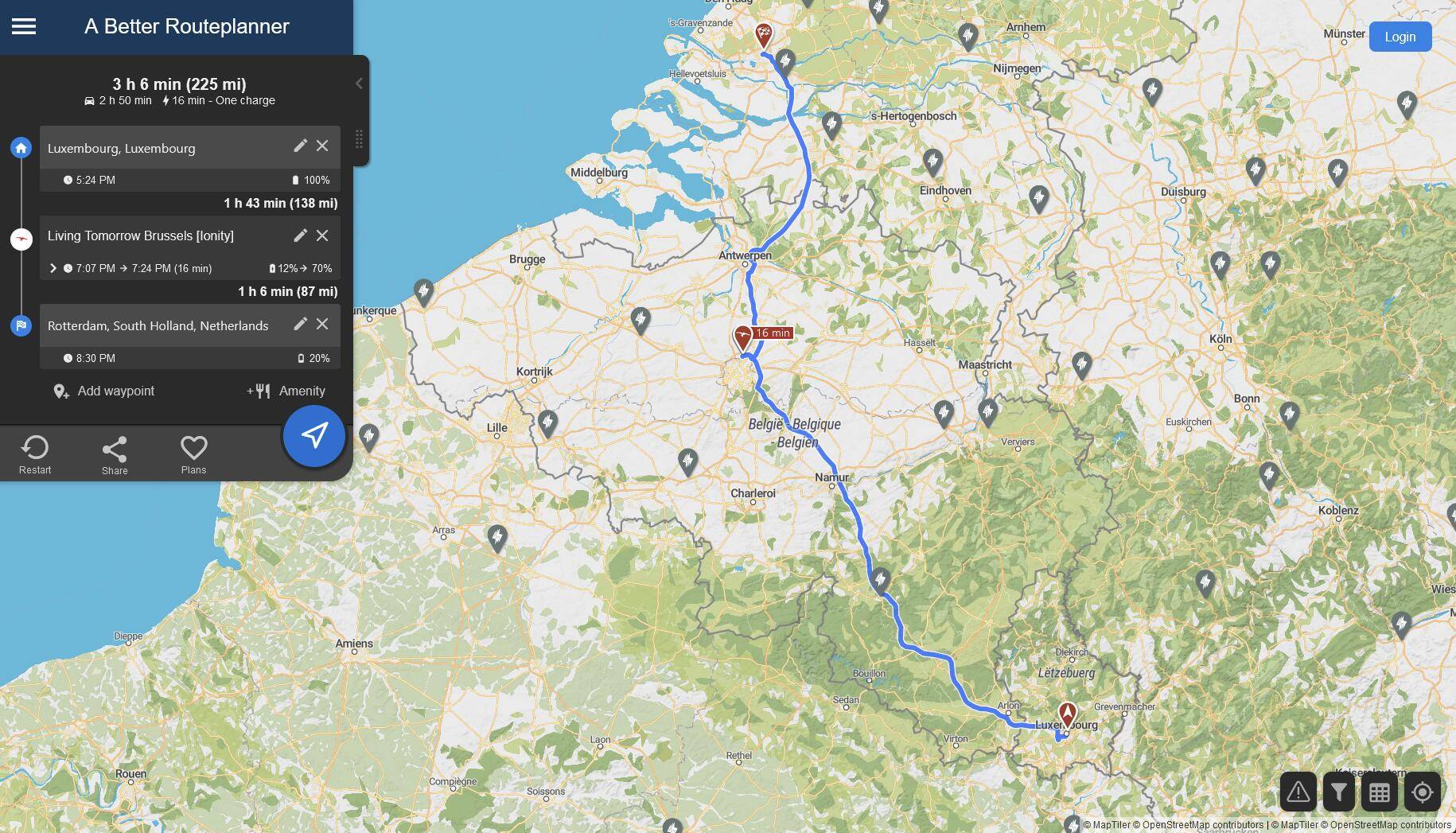

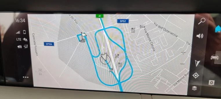

I found Porsche Navigation feature-poor and untrustworthy for charge planning - both in the car, and on the My Porsche App .
On one particular leg of the journey, I knew that there would be almost no charging opportunities for circa 200km. Porsche Navigation recommended a minor additional charge just before that 200km stretch that would then have me arriving at the next charging stop, a Porsche Centre, with just 7% remaining. It failed to recognise that the Porsche Centre would be closed when I got there! It also failed to recognise that the only other fast-charger in the town was out of action. Fortunately, I had ignored its recommendations and made sure I had a full charge starting the leg.
Not being able to specify the State of Charge that you want to arrive with is a major limitation of the app. I wanted c.30% getting on the ferry in Italy to give me enough charge when we docked in Greece, but I had to do the planning separately to make sure this happened.
On another occasion, instead of recommending a motorway services stop, it took me off the motorway, through the toll-booth, to a car park - a car park that wasn't near any facilities, had a single charging pedestal that was already in use and had a queue of cars waiting. So we had to go back onto the motorway (through the toll again), and look for an alternative option.
The final straw for me was when it recommended I come off the motorway again, drive a number of kilometres through rural countryside, to the back of a remote warehouse. I only knew this because I had used Google Maps to explore the proposed stops before I set off. I am sure it was probably safe, but I wasn't taking a chance - with my family (or my car!).
Regardless of how much planning and tweaking I did in the My Porsche App before the journey, when I sent the plan to the car the car did its own route plan. So I quickly gave up relying on Porsche Navigation for charging. Instead;
  • I used A-Better-Route-Planner (https://abetterrouteplanner.com/) to do the outline plan and to identify fast chargers along the route.
  • I also validated and refined my stops using PlugShare (https://www.plugshare.com/).
  • I then manually entered each stop into the car so that I could have the turn by turn directions on the dash and Head-up-display (which was really helpful for adjusting to driving on the 'wrong' side of the road. Although, sometimes, it showed a 'mini map' on the HUD, which was far too detailed to interpret when driving). I took this photo of one of the more 'simpler' maps it showed - try interpreting this tiny image at the front of your car while driving.
  • In Italy, in particular, I found the Porsche Navigation instructions were not clear enough at times, so I had Google Navigation running in parallel on my phone. If there was a difference (and there was on a number of occasions) I always followed Google!
So, in summary, I wouldn't trust Porsche Navigation for planning your charges. It does take some advance planning for each leg of the journey but it soon becomes second-nature when you become accustomed to, and trust, the other apps.

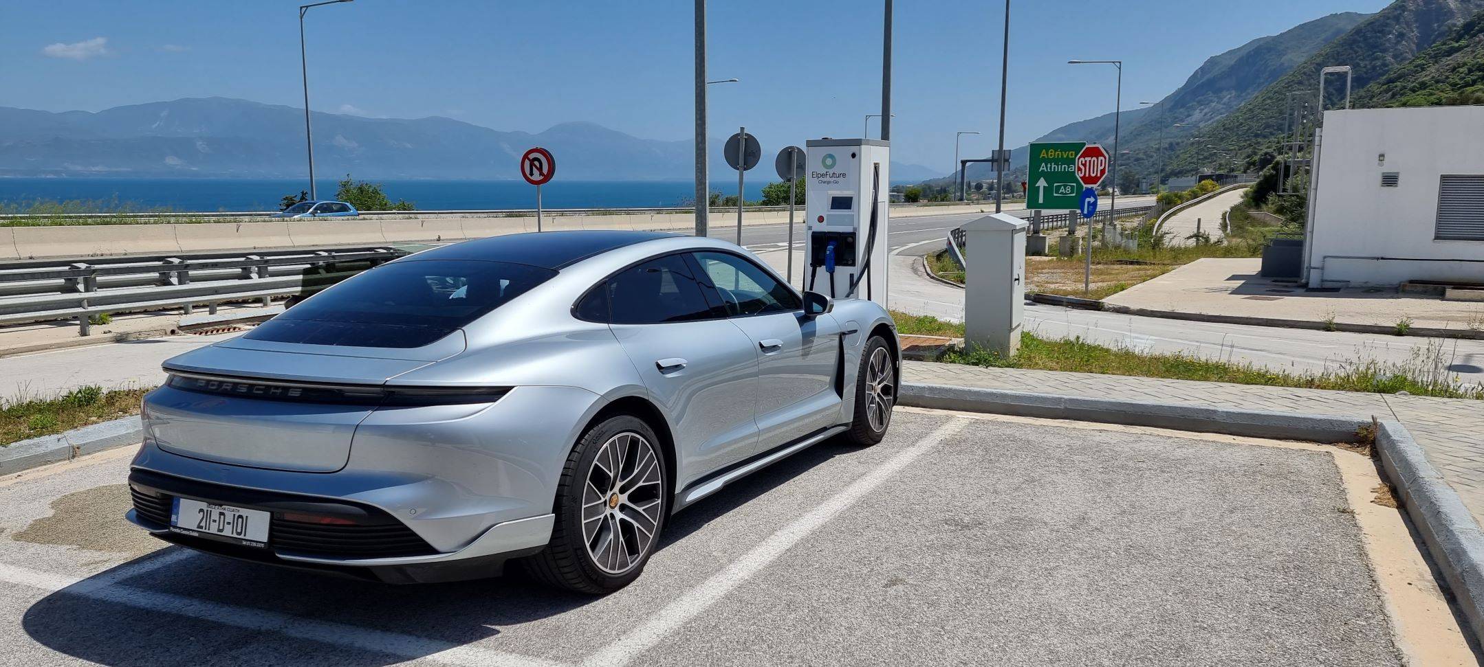

Charging

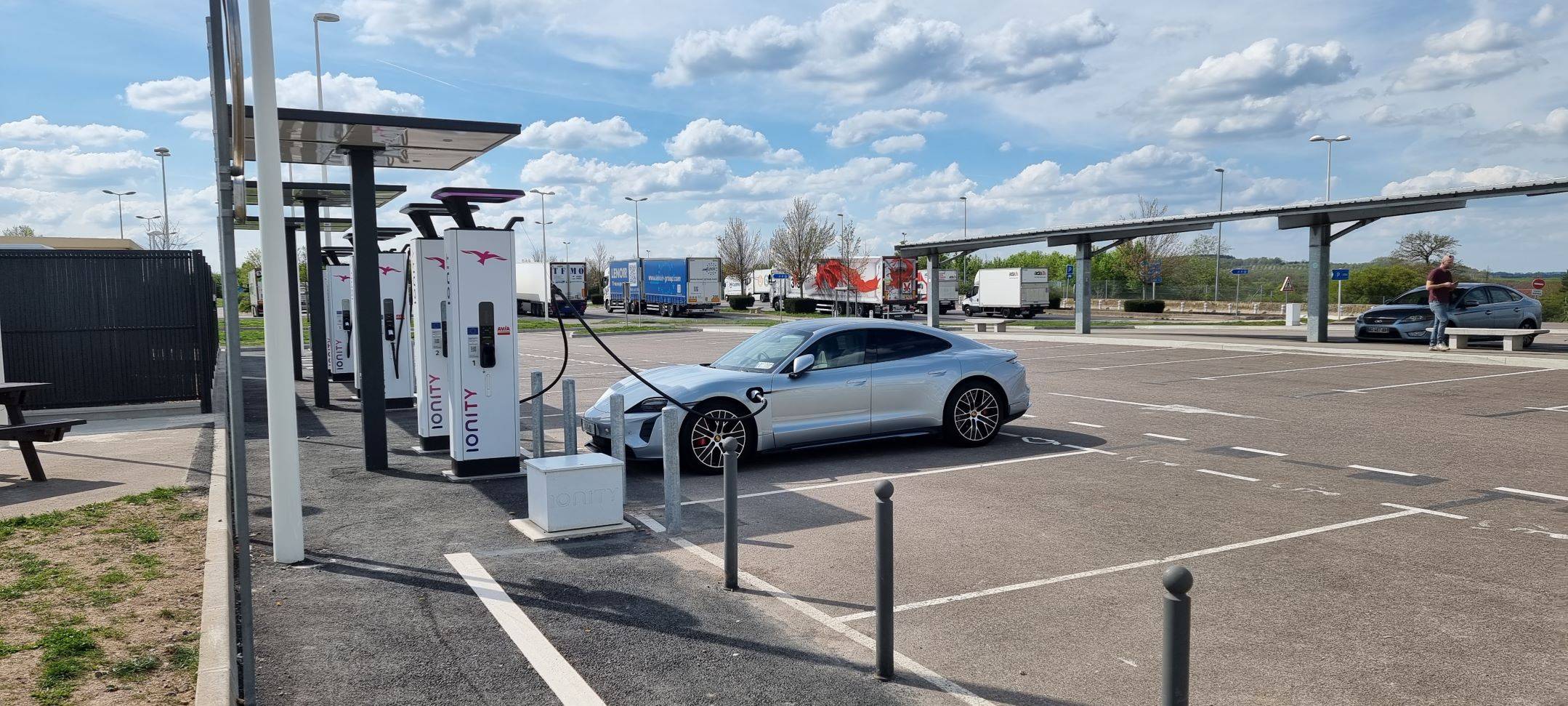

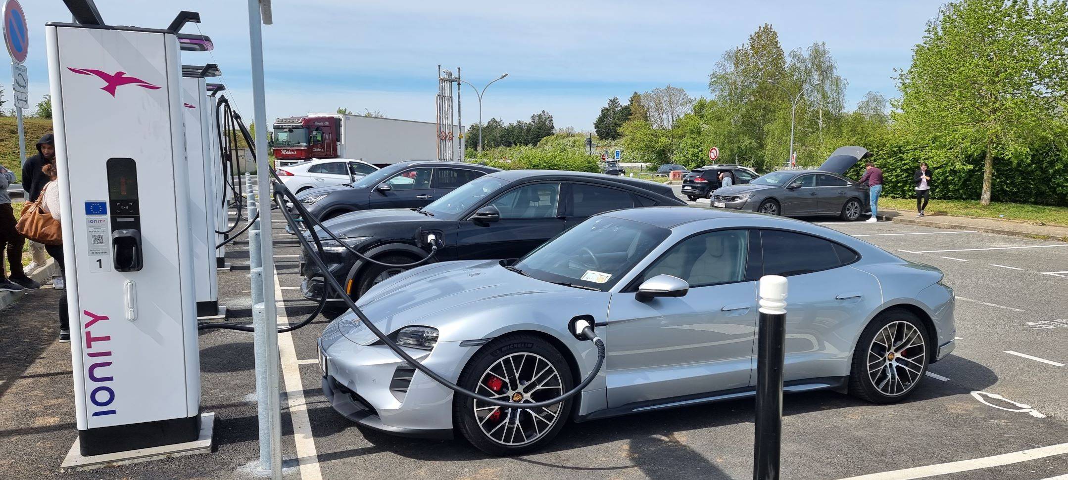

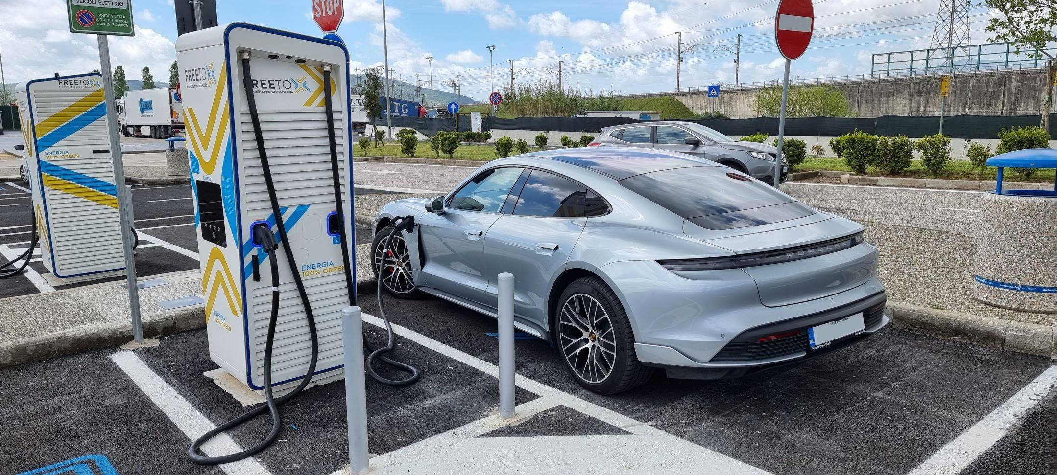

Initially, I was a little apprehensive about how the charging would work in the different countries, but that quickly dissipated with each successful charging stop I did.
When I found a charging station that was compatible with Porsche, it was fantastic - particularly Ionity charging. Only once did the pedestal not read my RFID charging card, but I was able to activate it using the app. Italy and Greece were more fragmented and I had to use multiple charging company apps.
The companies / apps that I used in each country were:

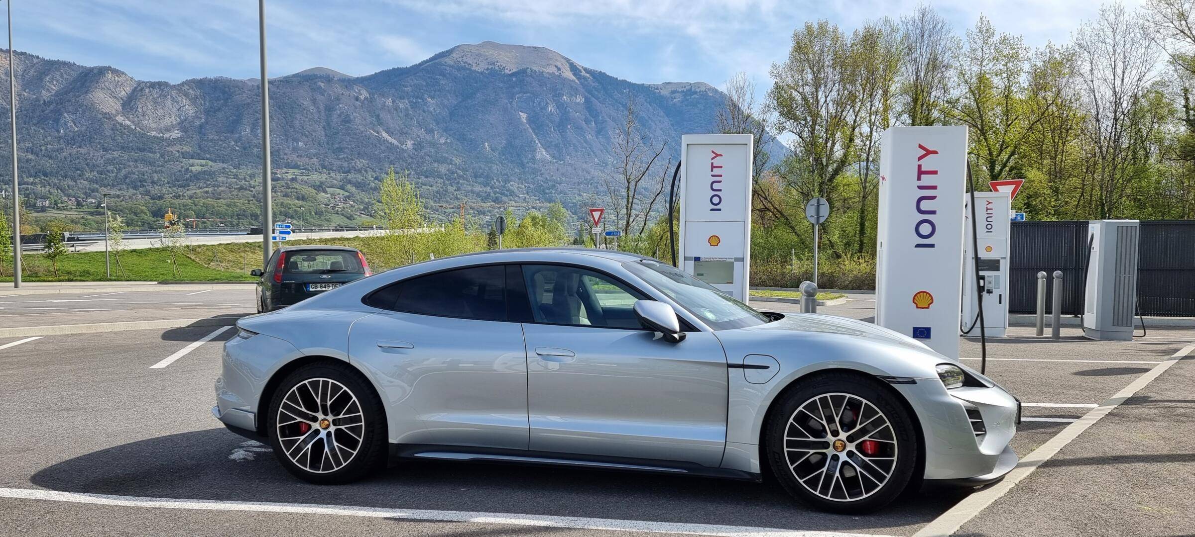

  • France:
    • Ionity (Porsche Charging App)
  • Italy:

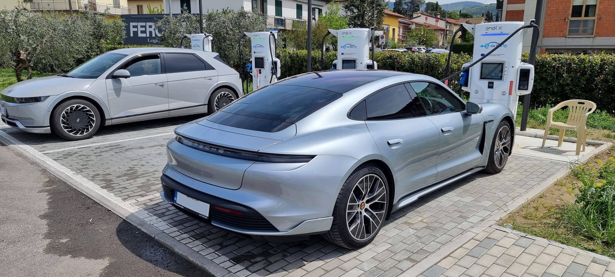

    • Enel X Way Italia (Porsche Charging App)
    • JuicePass (Enel X) - One of the stops had a 'Free to X' charging pedestal that is apparently by Enel X but it wouldn't authenticate with the Porsche card or app. However, I was able to download the app and subscribe to their JuicePass service while we were there. Enel X site link/ JuicePass app link
  • Greece:
Some providers allow you to pay directly using your credit-card (without registering) but the rates are invariably more expensive than if you register through their app and then link your credit-card to your account.
Our total charging cost for the trip was just under €120. As I mentioned above, most hotels didn't charge extra for charging the car, so our hotel top-ups are not included in this total. Had we used public chargers for these, I estimate that we would have paid an additional €80 - €100.
One thing I noticed that the service stations could improve on is providing a windscreen squeegee at the EV pedestals. They usually have them at the pumps but none had them at the charging bays.

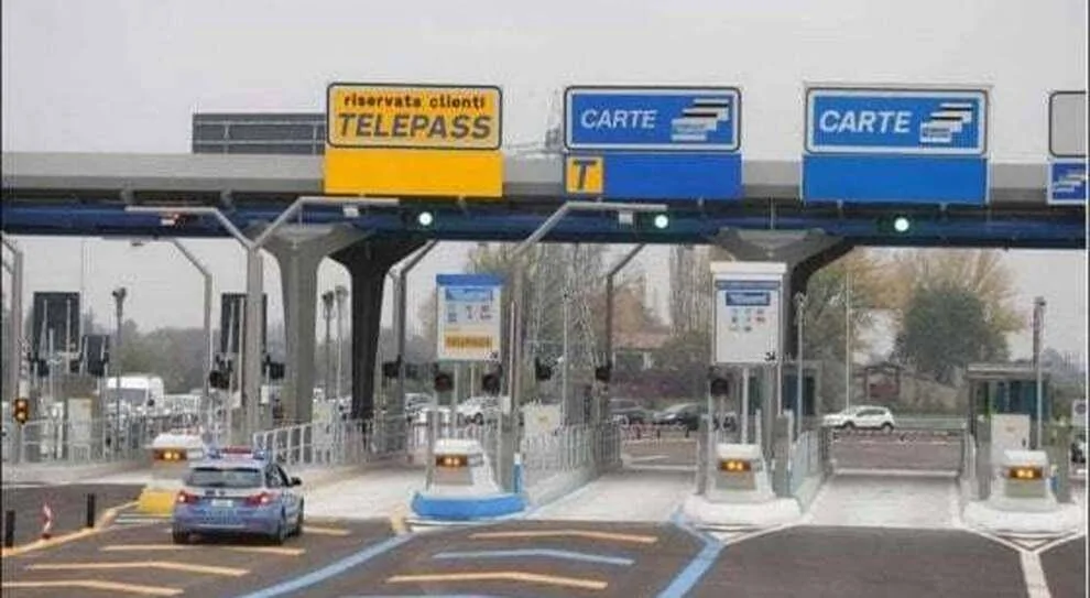

Toll tags
There are a lot of tolls on the route, so to eliminate the queuing I researched getting a toll tag that would work across the countries that we would be visiting. There was none that included Greece but BipandGo (www.bipandgo.com) and Telepass (www.telepass.com) would cover France and Italy for us (as well as other countries).
I chose the 'Telepass Go' service, primarily because it links to your credit-card as opposed to directly into your bank account, and there is no on-going subscription charge, other than for the months that you incur tolls.
I found Telepass to be excellent. I signed-up on-line and the tag was delivered by courier a few days later. I went through a cashier booth at the first toll we encountered in France (just in case the tag wouldn't work!) but it beeped first time and worked flawlessly every time throughout France and Italy.
Seeing the queues for payment, after just two or three tolls, we were soon glad we had the tag.
Unfortunately, there is no European-wide tag that works in Greece. Greece only relatively recently integrated their tolls systems so that one tag could be used across all the different toll-road companies. The tags also work differently, in that you have to add funds to the tag in advance. This can be done at any toll-booth.

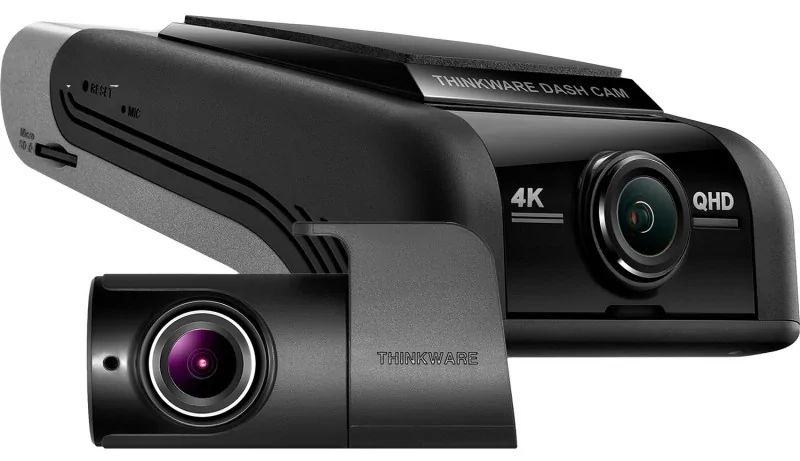

I decided to install front and rear dashcams for extra peace-of-mind on the trip. After researching, I chose to have the Thinkware u1000 cameras professionally installed.
I also added the Thinkware Radar unit, which detects broader activity near the car when parked, to increase the protection and to help reduce the battery drain (by not having the cameras on standby the whole time).
If you are considering installing the same cameras, at 4k video quality, it needs a much bigger memory card than the 64Gb one supplied - I found it only provided a few hours of coverage before being overwritten. Connecting to it through Wi-Fi is also temperamental and unreliable, so I would make sure you get a good installer to train you on it fully. It worked for me at the installer's workshop but I haven't been able to sign into it since!

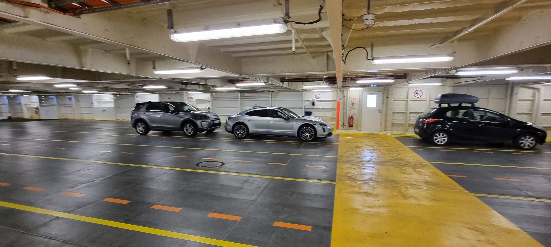

Charging is available on the ship, for an extra fee, but I had already charged the car shortly before boarding so I didn't book it. I opted for 'Speedy Exit' instead. In the photograph below the charging bay is actually on the other side of the car.
We were lucky that the ferry wasn't too busy, so there was plenty of space around the car. If it had been busy, I would have booked the EV charging as there is more space in the charging bay.

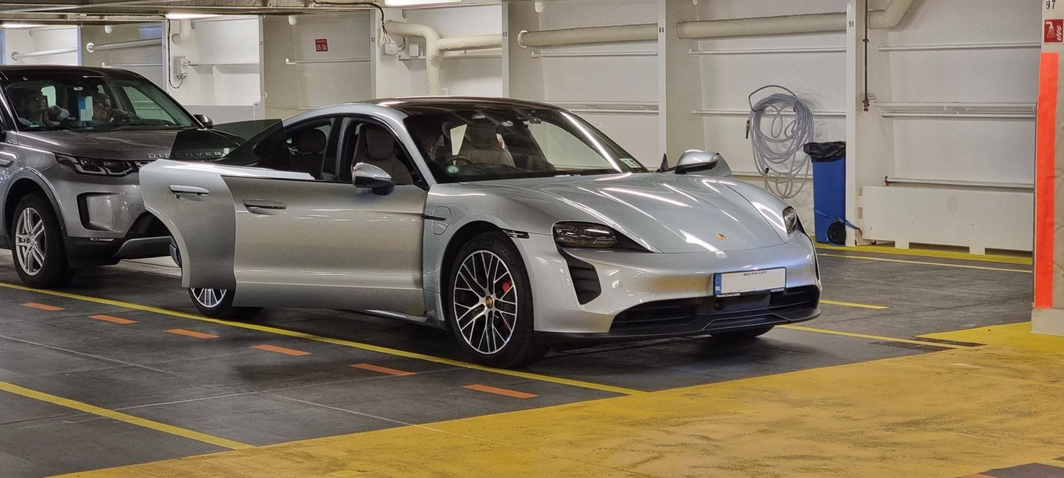

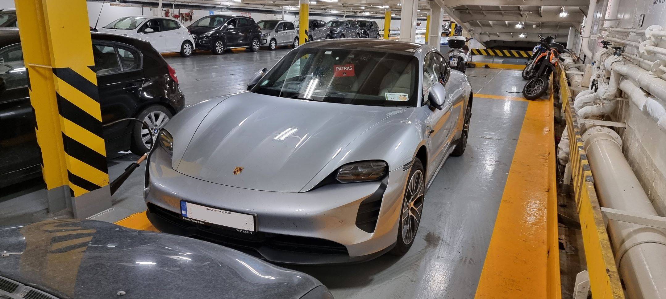

Probably an obvious point, but worth remembering to raise the car when boarding. The Irish Ferries staff were excellent in proactively checking the ground clearance while guiding me up the ramp.
Also worth remembering to turn off motion sensors in the car when locking it (either on the power-off prompt on the PCM, if you still have it active, or by double-pressing the remote).

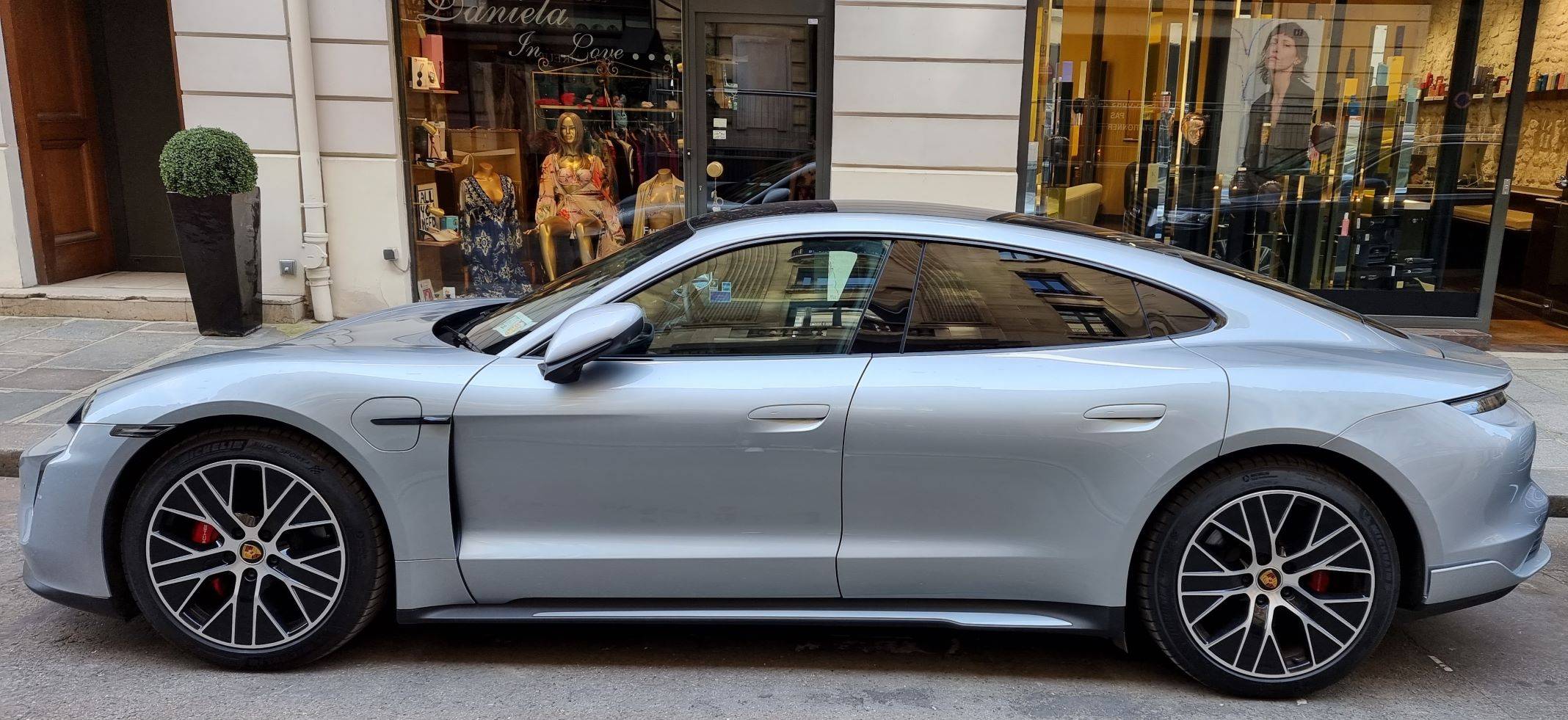

My first challenge was whether the Taycan (Sedan) would comfortably fit everyone, along with their necessities, for an extended trip.
  • We are a family of five - four of whom are full adult size.
  • I'm also 6'4" and one of the kids is 5'10". So I figured it would be tight.
  • Normally, I drive with the seat back to the limit, but I found, with a little compromise, we could all fit quite comfortably.
  • Thankfully, our youngest (11) could fit in the middle seat. However, it is worth noting that it is not a comfortable seat for long journeys - we had to add cushions below and behind to make it tolerable.
  • The panoramic glass roof helped a lot with the kids' sense of space in the rear.
  • Macon, France
  • Milan, Italy
  • Athens, Greece
Charging
  • France:
  • Italy:
  • Greece:
Dashcam

We sailed with Irish Ferries (on their WB Yeats ship). It was excellent - very comfortable, good facilities, helpful staff. The sailing time was also very sociable - it departed Dublin at 16:00 and arrived in Cherbourg at 11:00 the next morning.
