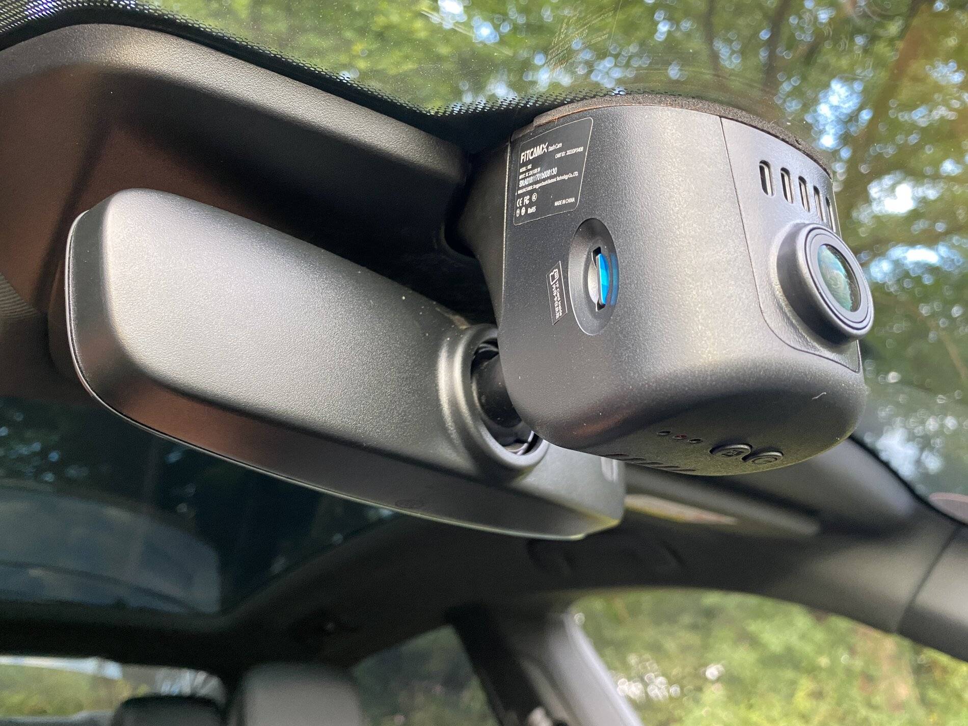

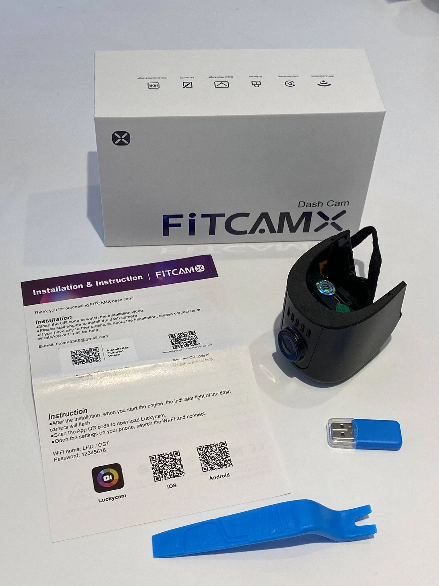

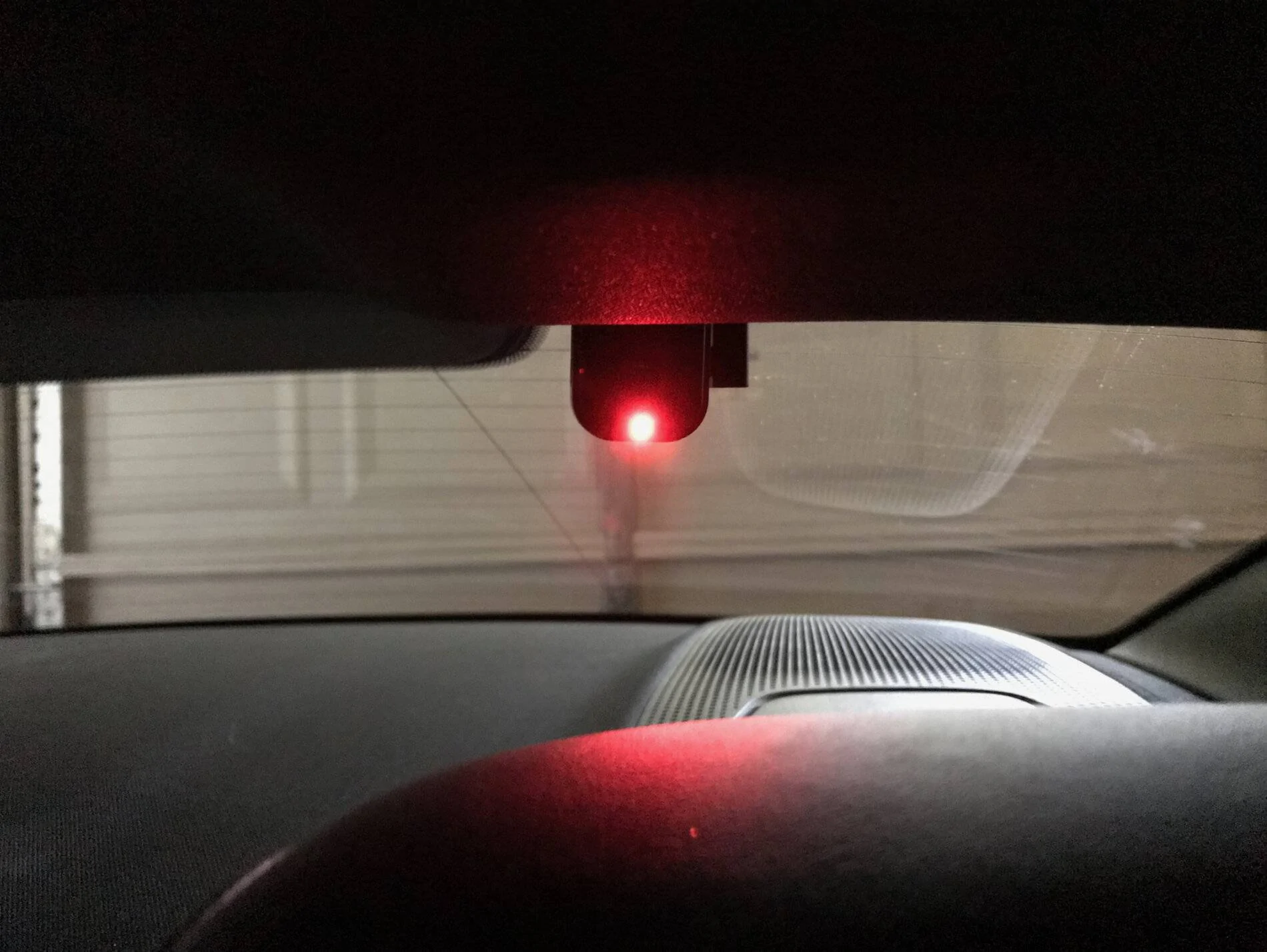

I installed the FITCAMX the other day…
Looks nicely integrated and seems to work well enough.
i don’t have experience of other systems to compare it to.
They have just updated the mobile app, and it’s pretty straight forward.
Camera turnes on with main ignition, and turned off pretty quickly after the car is turned off. It takes its power from the rain sensor.
interestingly, I have noticed the car randomly turns on now and again… random videos when I’m not using the car are a give away!
I didn’t enjoy installation at all, but then I have no experience of removing car trim.
The sales installation video is very misleading and it’s a lot more fiddly in real life. Also the video was not made on a Taycan and you actually need to remove the parts in a different order from that shown in the video linked in the installation kick start.
Trying to follow that was a disaster and caused a lot of
Support via WhatsApp was fantastic, but frankly I could have done with the right video first time before I got in a real mess and also more detail on tool placement.
They said they would do a Taycan video once they got access to one.
There are a few more components in there Taycan and I panicked when it turned out to be a little more tricky.
It makes a huge difference when you know where the various catches are, sadly that information is only available once you have struggled and potentially forced the wrong bit.
Anyways, it’s installed now and I’m happy with it.

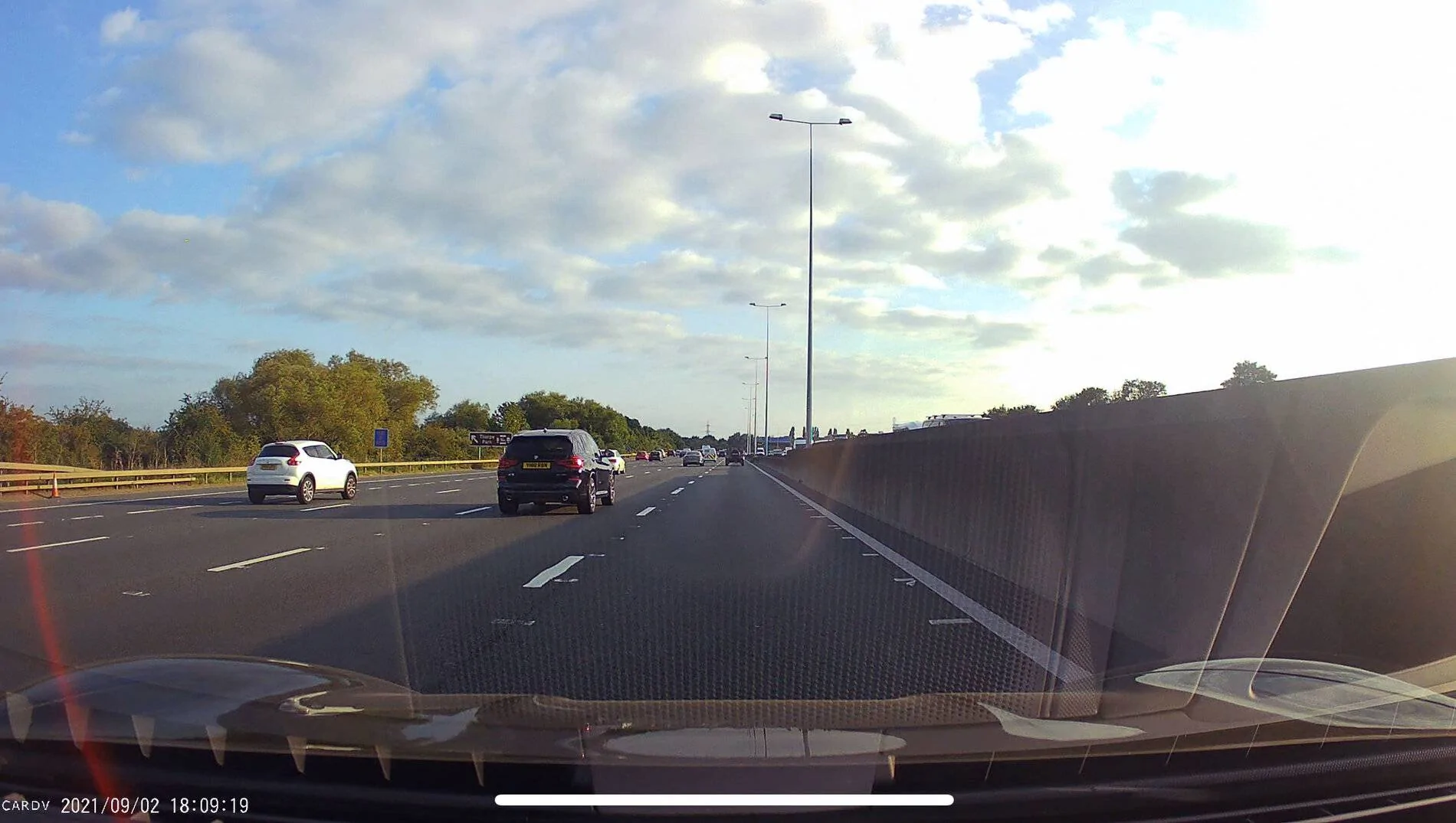

I enclosed a still frame capture from the output of the camera.

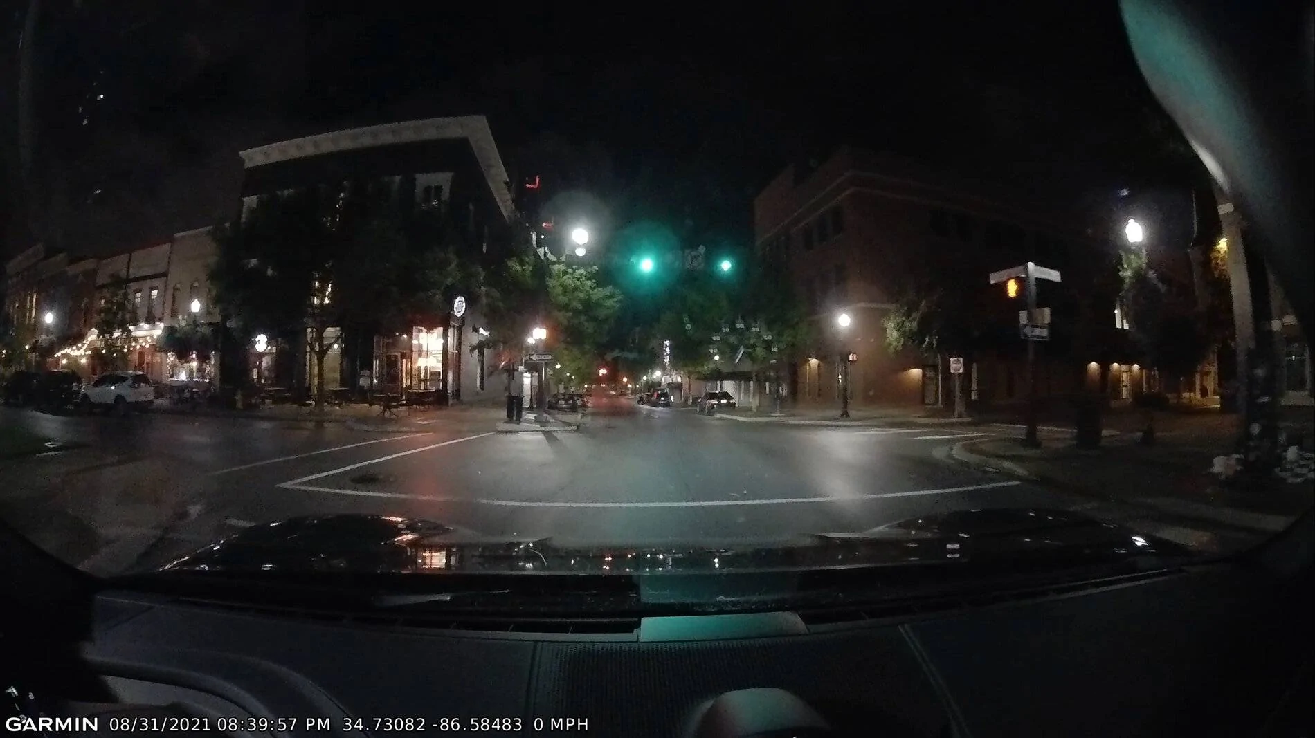

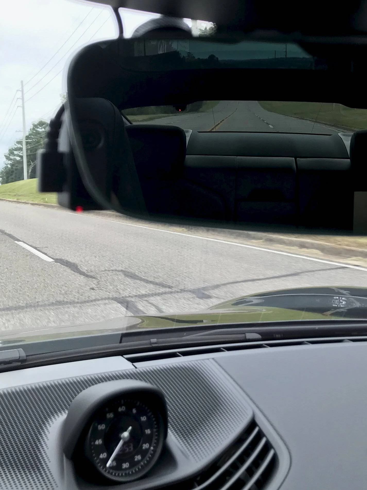

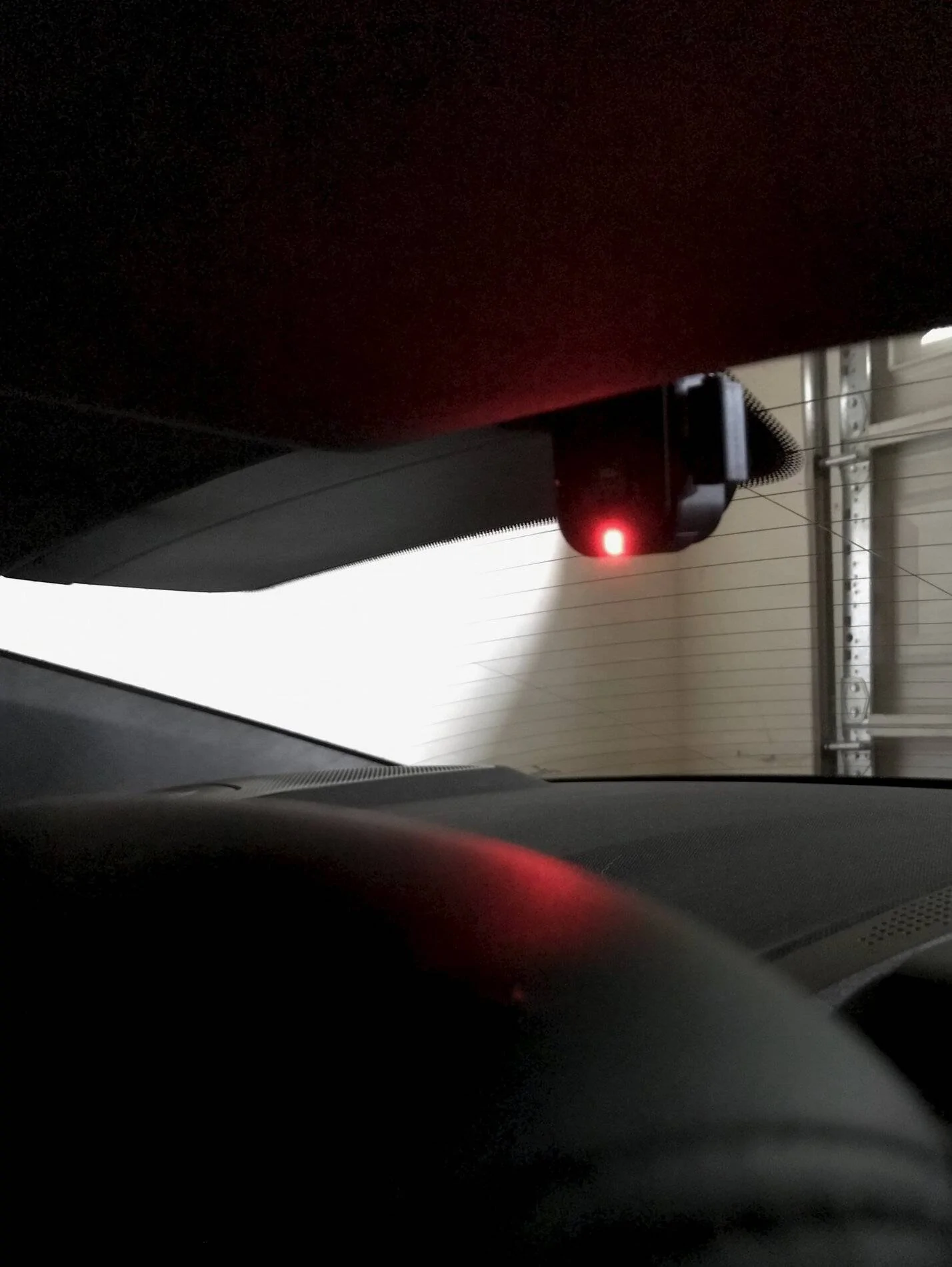

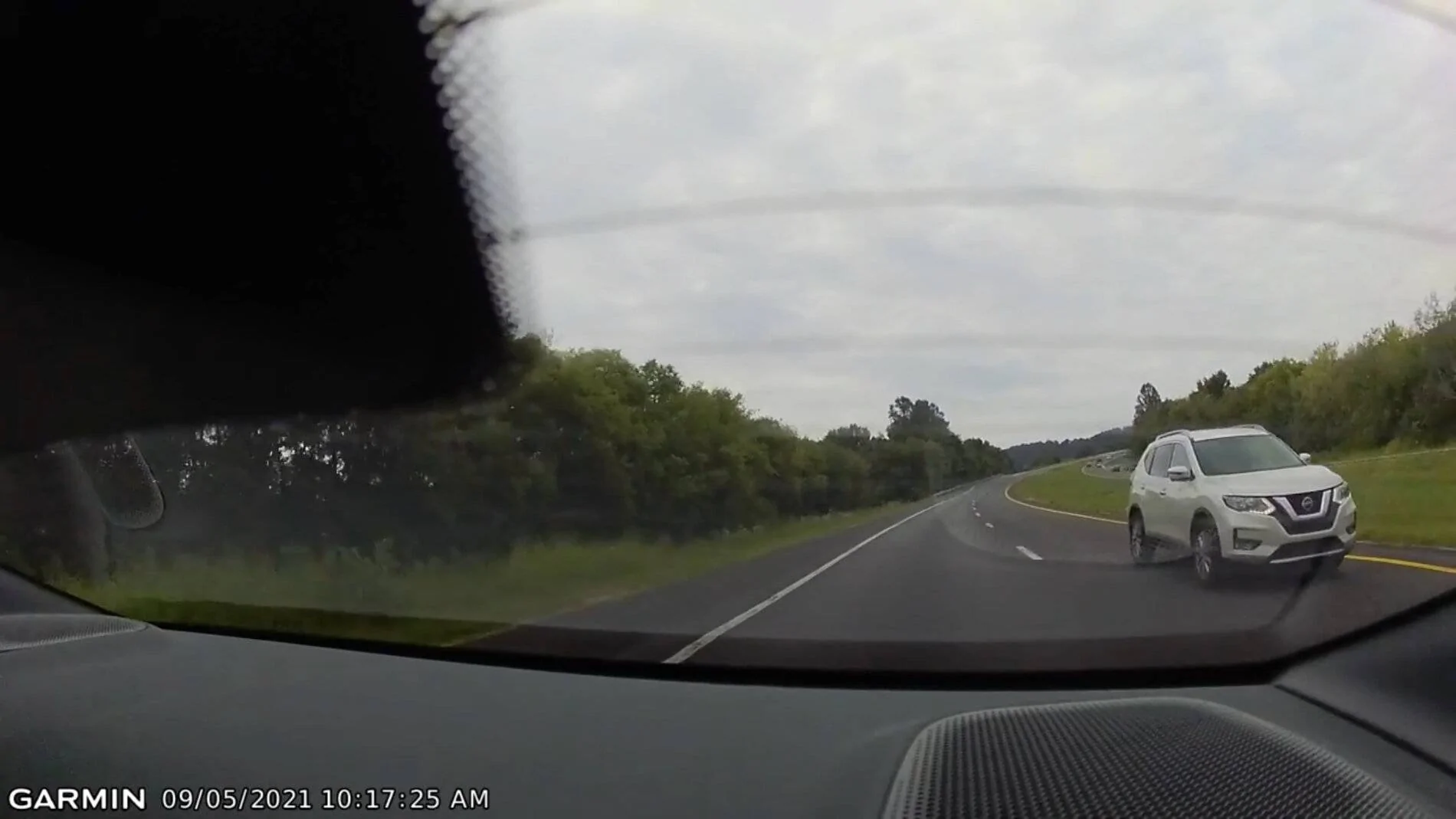

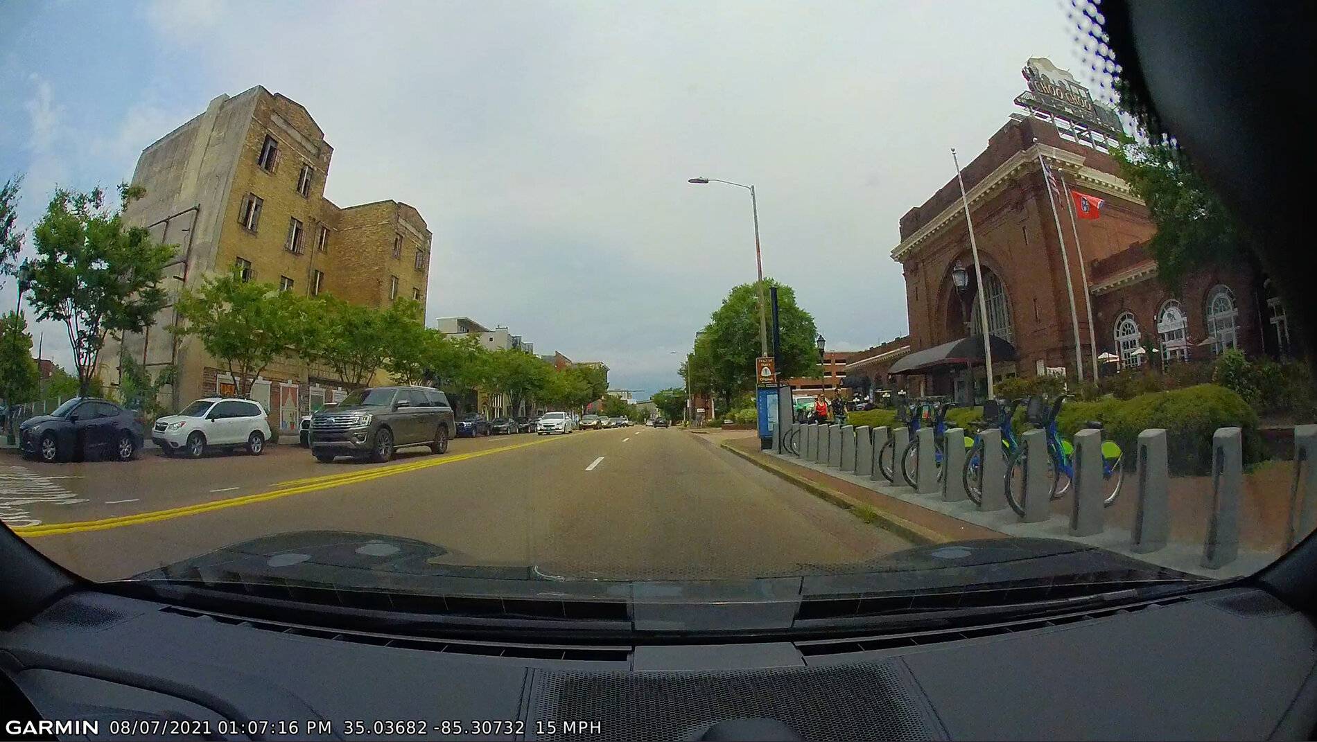

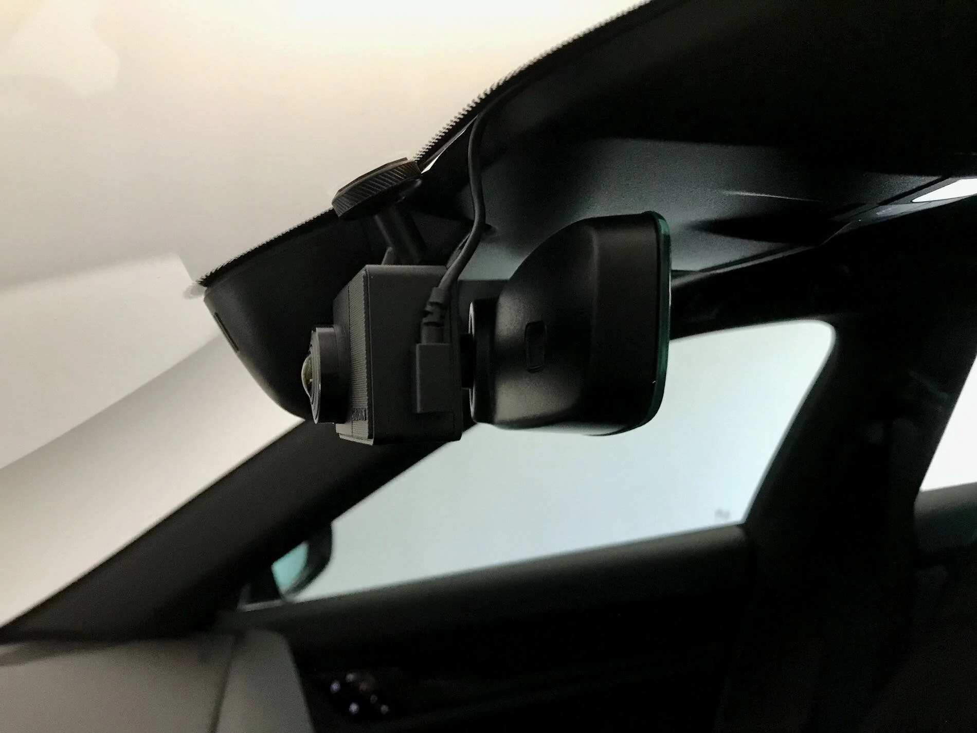

I'm using a Garmin 67W in the front and Mini 2 in the rear of my Porsche Taycan 4S. The only thing I care about is that it has to work reliability and look good. I've had a Garmin Speak Plus for years in my M3 so I'm familiar with the crappy Garmin Drive App. The important part for me is that you can hardly notice it when installed and if you do notice it, it looks pleasant and not out of place/cheap like some of the other solutions I've researched. I've had the 67W for a month and no complaints so far, the Mini 2 is a new addition and so far so good as well.
