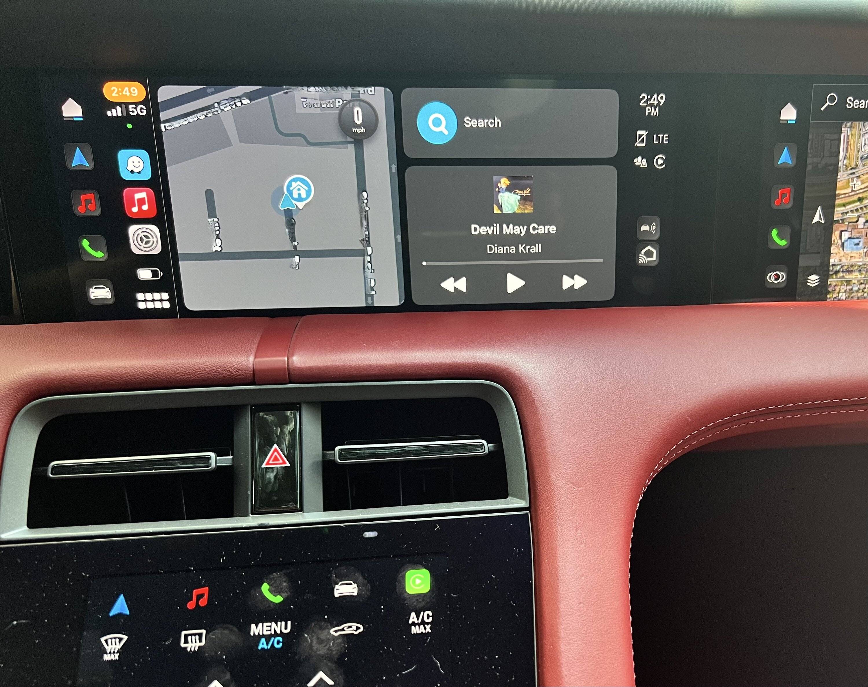

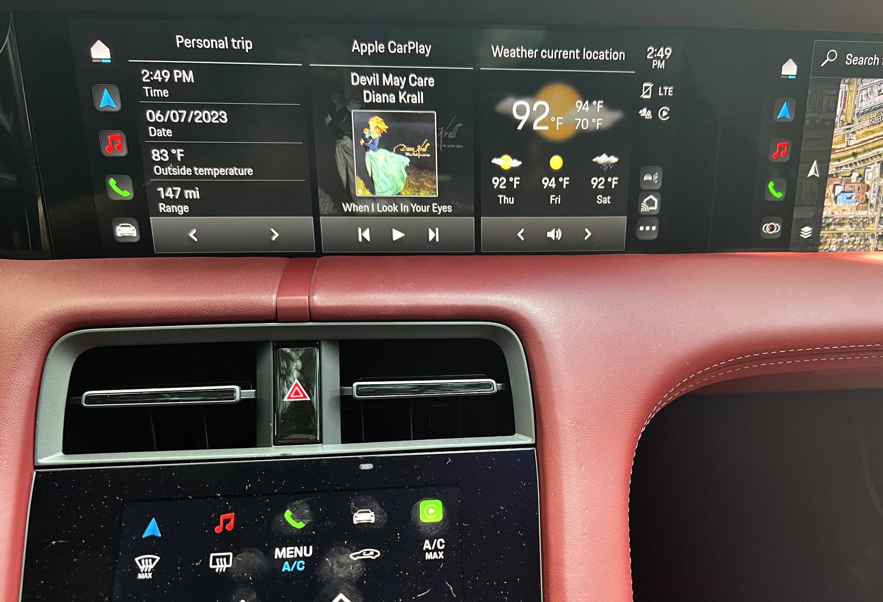

One thing I do like about the multi-screen menu setup (as duplicative as it may be) is that you can quickly (more easily) access a CarPlay layout from a PCM home screen layout using the lower screen - the extra slot by default in my setup is used by CarPlay - prob the only reason I'd use the drop down menu bar in the lower screen:
