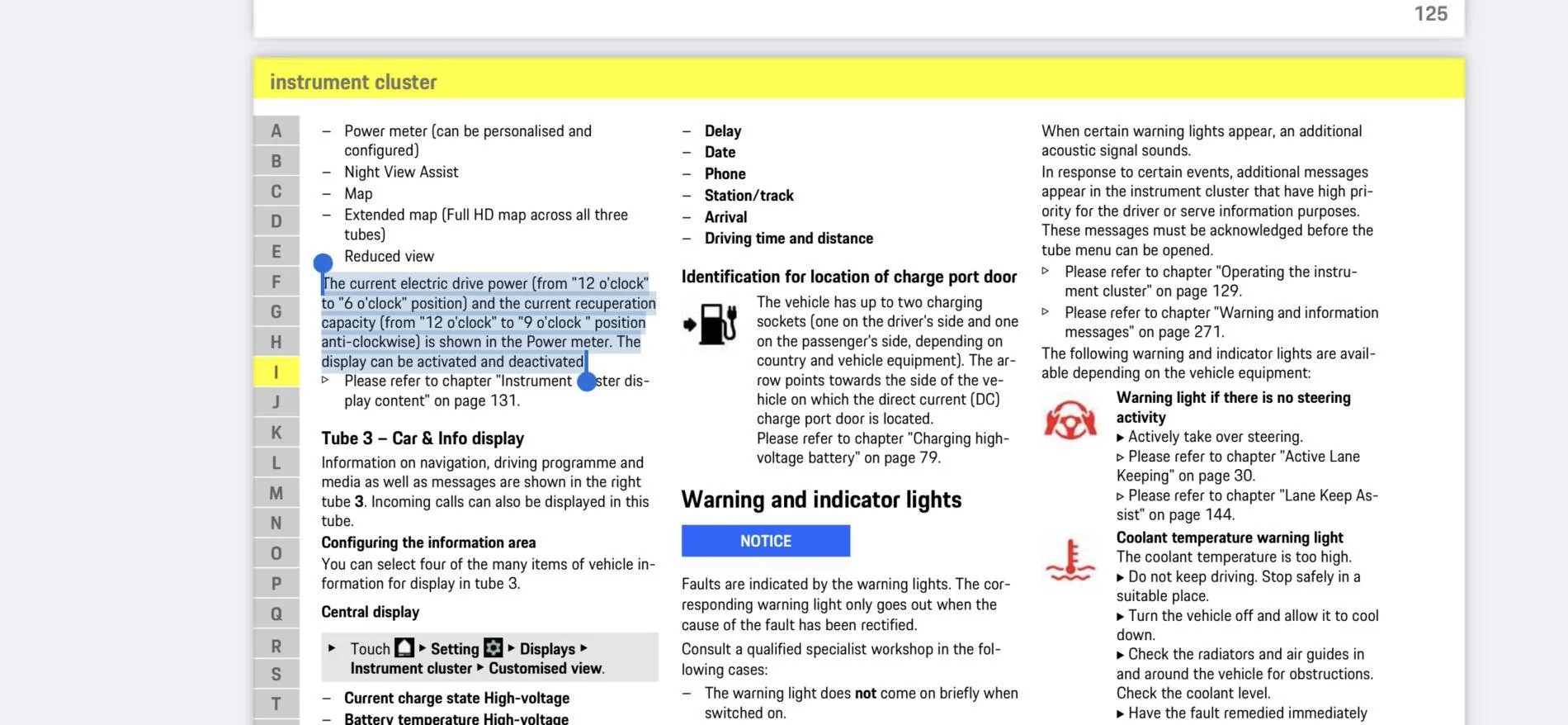

This is a design function and affects everyone. I’m amazed more people haven’t commented on it. An extract from the manual follows:
The current electric drive power (from "12 o'clock" to "6 o'clock" position) and the current recuperation capacity (from "12 o'clock" to "9 o'clock " position anti-clockwise) is shown in the Power meter. The display can be activated and deactivated.
The power meter will show the electric drive power which reduces as your battery charge reduces. By how much and when isn’t documented.

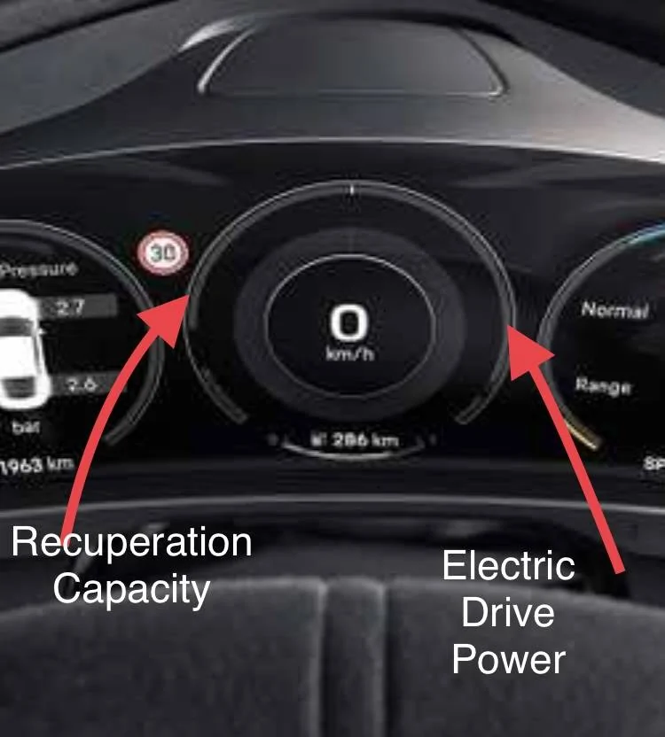

Rob_UK
Sep 16, 2020
44
I couldn’t agree more with the warning light. Everyone has the power meter on the middle dial of the main screen. The power meter also shows the recuperation capacity and electric drive power. It’s not obvious but small dials around the periphery of the main power meter display.

@Rob_UK can you explain more how you would use that dial? AFAIK the blue line just tells you how much power you're currently using. Are you saying there's something else there that indicates the max power you can use?
Rob_UK
Sep 16, 2020
44
Yes blue line tells you how much power you are using but the available power bar varies from 3 o’clock to 6 o’clock depending on your battery charge. Check it out for yourself and see how the outer bar varies depending on how much battery charge you have. It really starts to drop off below 50% charge. Very few people are aware of how the Taycan throttles back the available drive power depending on battery charge and possibly even temperature.
