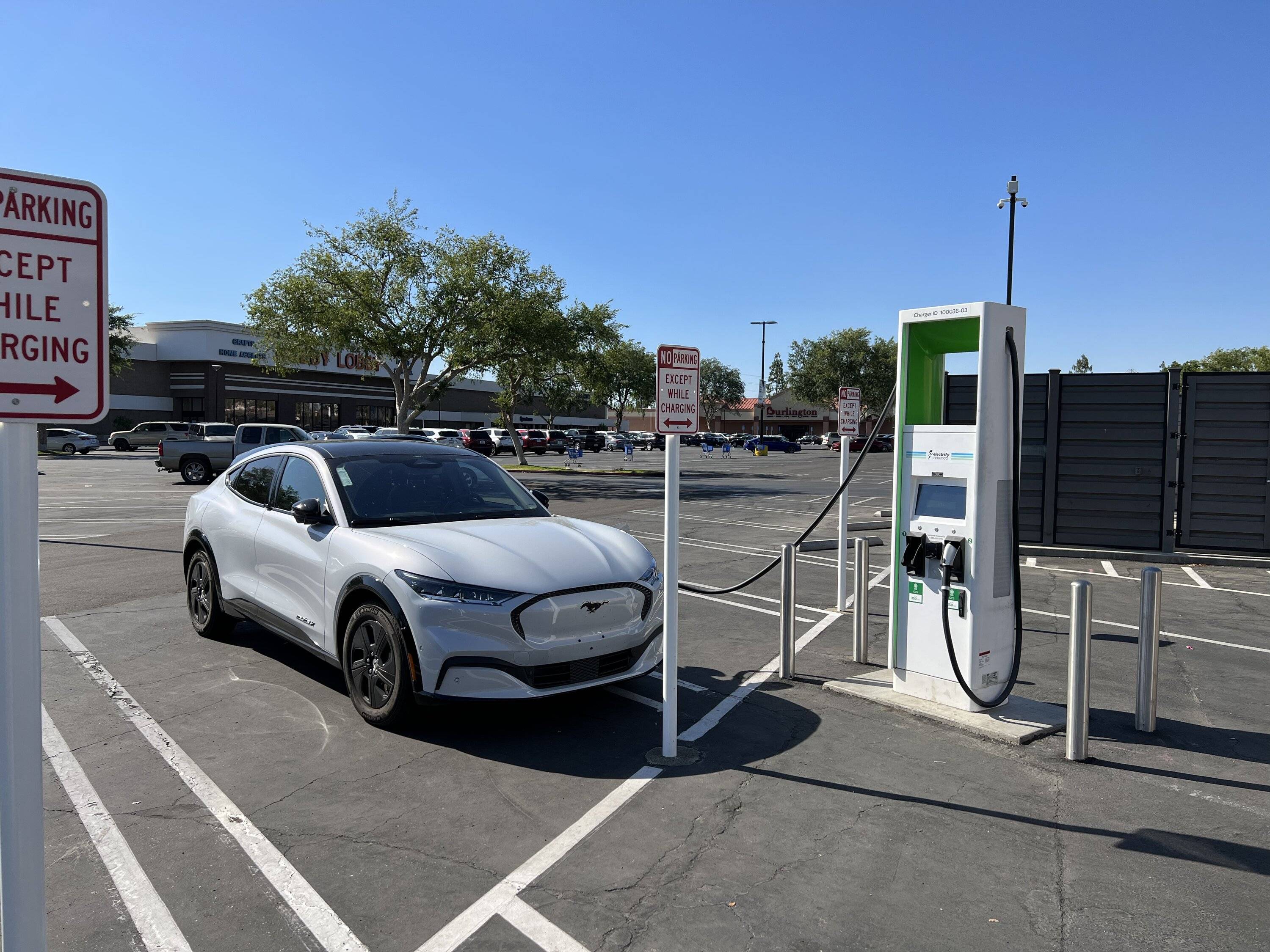

I am really getting sick of these things making my charge stops longer by hogging 350kW pumps!!
It maxes out at 150kW guy!!

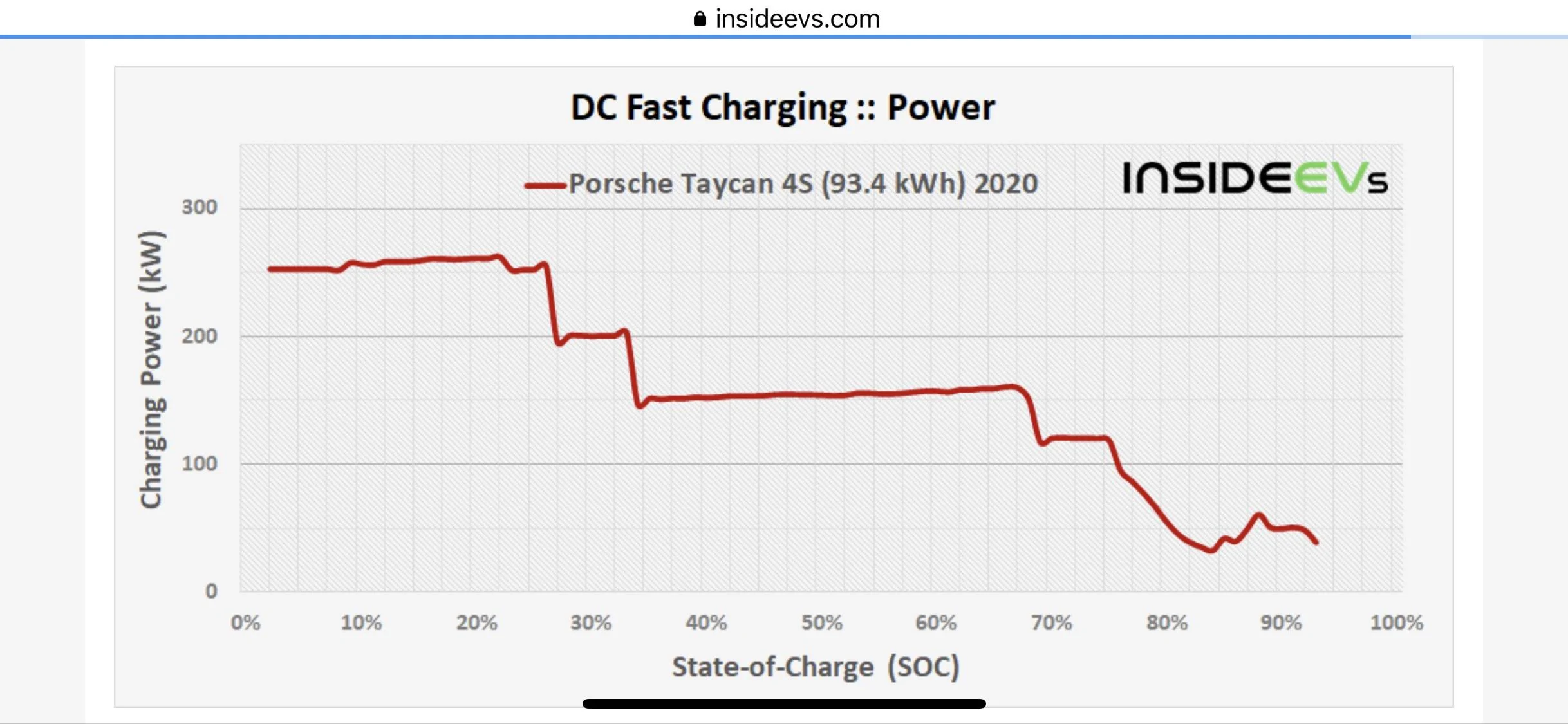

How much time do you figure you lost at each of those charging stations by having to charge at 150 vs 350?
If you go off this graph, the charge time from 5-35% is 7 minutes. The same 30% of charge at 150kW is still only 11 minutes. A difference of only 4 minutes.
Another example is if a Taycan arrived at 25%SOC, the difference in charge time would only be a matter of 75 seconds vs a 150kW charger.
Porsche Taycan Someone Educate Mustang Block E Drivers! 56B7C00D-F4E1-4DA1-83FF-6D81FB2CD36D
I have personally run into this situation as well but knowing the relative insignificant difference, it’s not worth the time to even move vehicles let alone try explaining it to someone. I tried to once as well… End of the day, 350kW is also a bit overrated.
I think some people have a observed higher kW deeper into the SoC than that graph shows, but your main point is still completely valid. My model I use (based on the above graph and adjusted based on user reports) shows 6 or 7 min difference over the entire charge.

Here's the full charge curve on an EA 150 kW unit (CT Turbo). As you can see, basically flat at 150kW to 73%. Only drops below 120 kW at 80%. Unless you want a super quick stop & go lower in the pack, a very good option: No need to precondition, lower charging losses, lower pack temps during the charge, and less energy expended bringing temps down after the charge. Saves energy and the battery.
Porsche Taycan Someone Educate Mustang Block E Drivers! taycan-cross-turismo-charging-curve
Porsche Taycan Someone Educate Mustang Block E Drivers! taycan-cross-turismo-charging-graph
