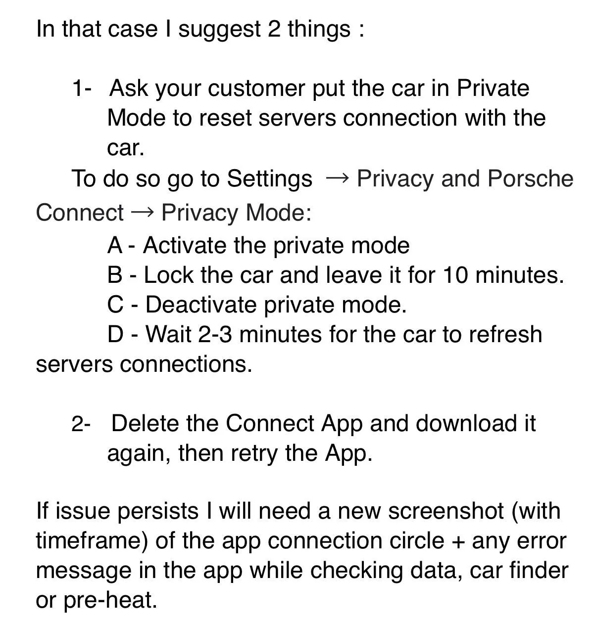

This is so true. I had an issue where my car lost connectivity to the app - everything else worked fine data related. I sent an email to Porsche support on the app. Heard nothing and still waiting since Sunday. Yesterday I texted my sales rep who responded in 5 minutes, sent an email to his in-house guy who called me within 5 minutes. Three hours later I get a text with steps to try and it worked. Very impressed with the service at this dealership.
That's great service. I think my dealer is not so well-informed. What were the steps if you don't mind me asking? Since the big up-date I can now rarely get the car to connect to the app - it worked almost every time pre-up-date.
I did only step 1 in the screenshot below. I didn’t think step 2 was necessary since I wasn’t able to connect on the app, tablet or laptop. It wasn’t an app issue.
Thanks, I’ll try that today
