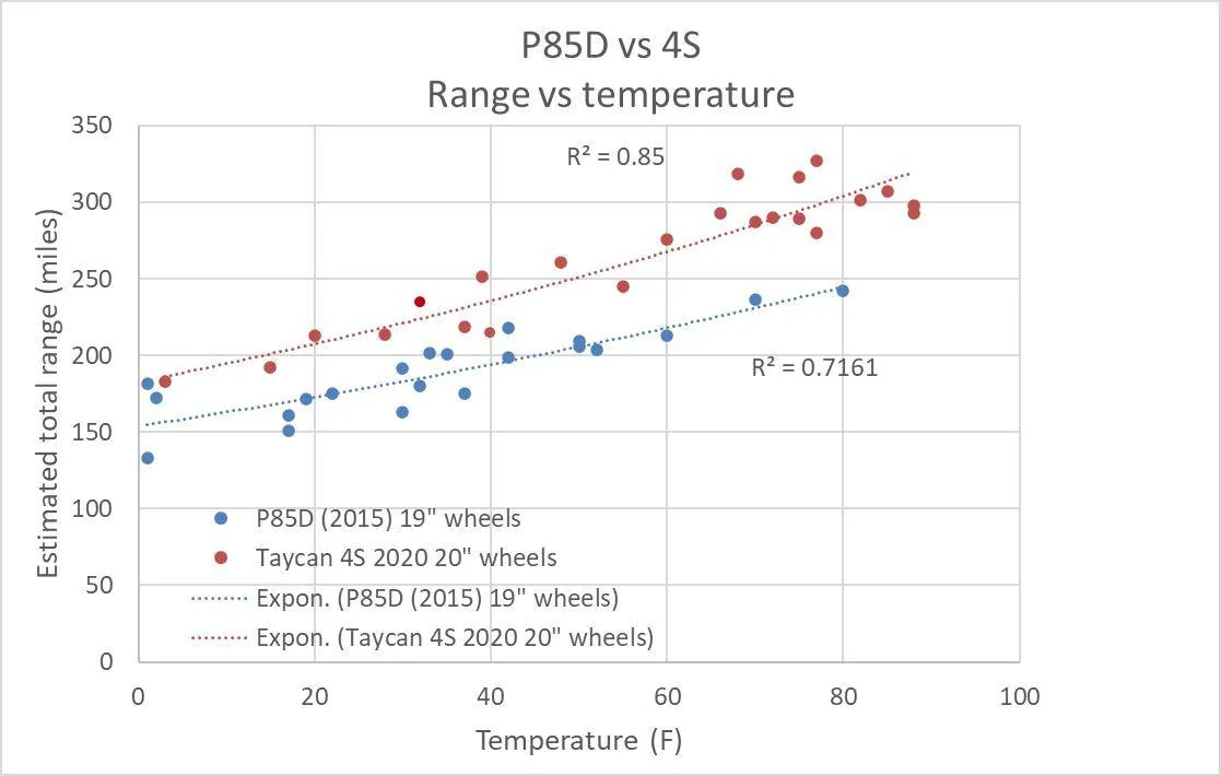

If I charged to 80% in these cold months, I would get about 179 miles of range - MAX

No, that is what your guestimated range is on the display. What you actually get at highway speed on dry pavement is a bit more. See below data from last winter. Aftermarket 20" wheels (losing ~3-5% on that alone), 73 mph, temp set to a comfy 72F, start from 100% in order to estimate capacity. By the time you get close to 0F, your morning estimate will look depressing (mine displayed ~140 at 80%), but as you can see it still manages 180 miles.
Porsche Taycan Does anyone actually charge to only 80%? 1638919936219
Uh, no. I never go by the guesstimate, as it's woefully wrong. I charged to 85% the other evening, 26 degrees outside, I drove some parts of the highway over 90mph, most was city driving and pretty tame. The guesstimate after charging to 85% was 211 miles. I returned home that evening with 10 miles of range left and I had driven 136 miles. That is 146 TOTAL RANGE on 85% charge. Right now I am on pace to 177 miles of range at 85% and that will drop off as I get lower to empty battery, it always does. I don't need to refer to charts, I have experienced the car for 16,000 miles and 20 months.

@John89 : here’s my report.
start: SOC 85%, estimated range: 324km (battery temp. 1C)
complete drive: 115 km, average consumption 26.4kwh/100km
back at home: SOC 52%, estimated range:193km (battery temp: 13).
I was driving in Normal mode all the time.
115+193 = 308km (compared to 324 at start).
btw: i;m impressed That after three nights (parked at less than 0 degrees), SOC was still 85%.
i charged on Wednesday.
edit: i was driving in Normal mode all the time (and AC set to 21.5)
