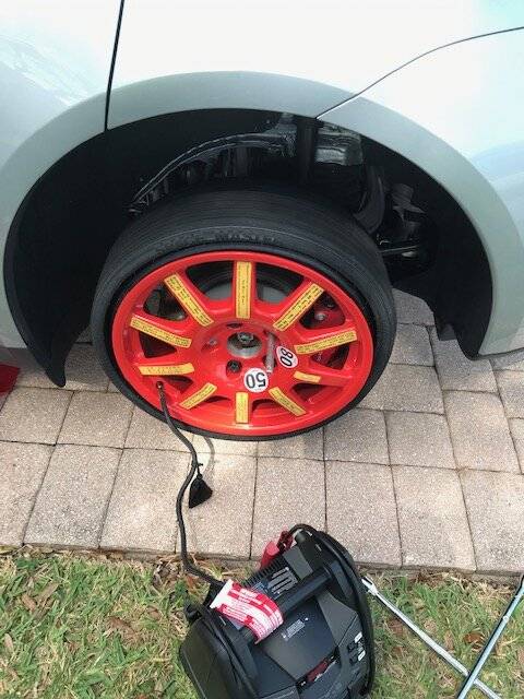

Sorry to hear about your troubles. I stuck with all season 19 inch tires as others have said to get some more sidewall. I've had two flats so far due to nails. The inflatable spare from my Cayenne fits my car with standard brakes so I bought one from a recycler. It eats up some trunk space but I don't care. Got a scissors jack from Amazon.
Porsche Taycan Flat Tire Disaster / Taycan 4S / NY cayenne spare on Taycan.JPG
