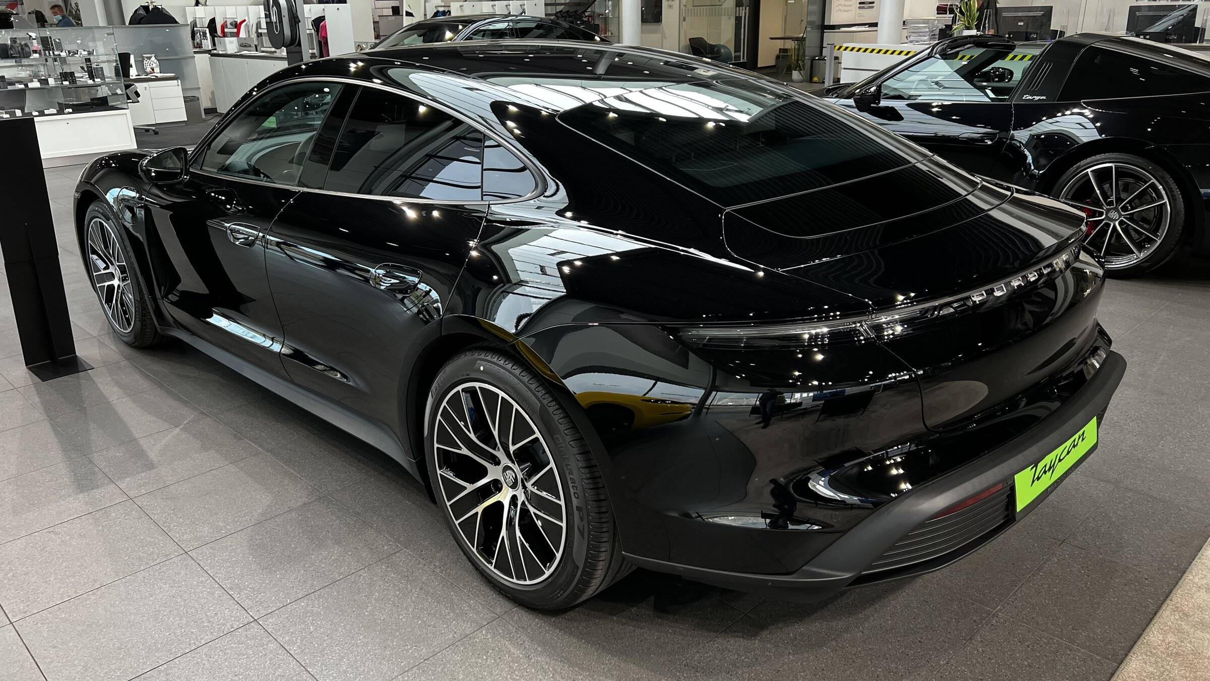

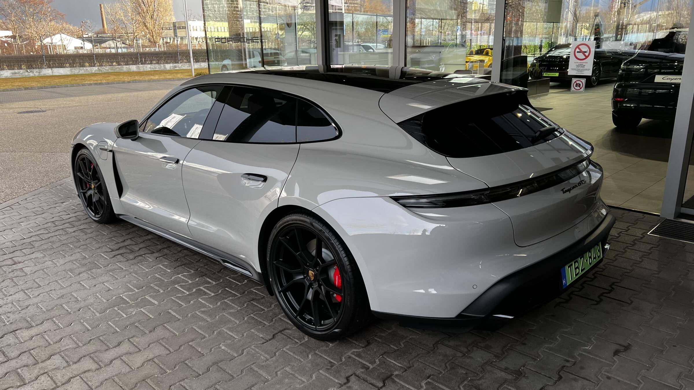

The good news it is not a heavy stuff, on Panamera 2kg less than normal.
Tomorrow afternoon I will have this GTS ST with insulated glass maybe will have time to bring out this black 4S normal glass after each other.

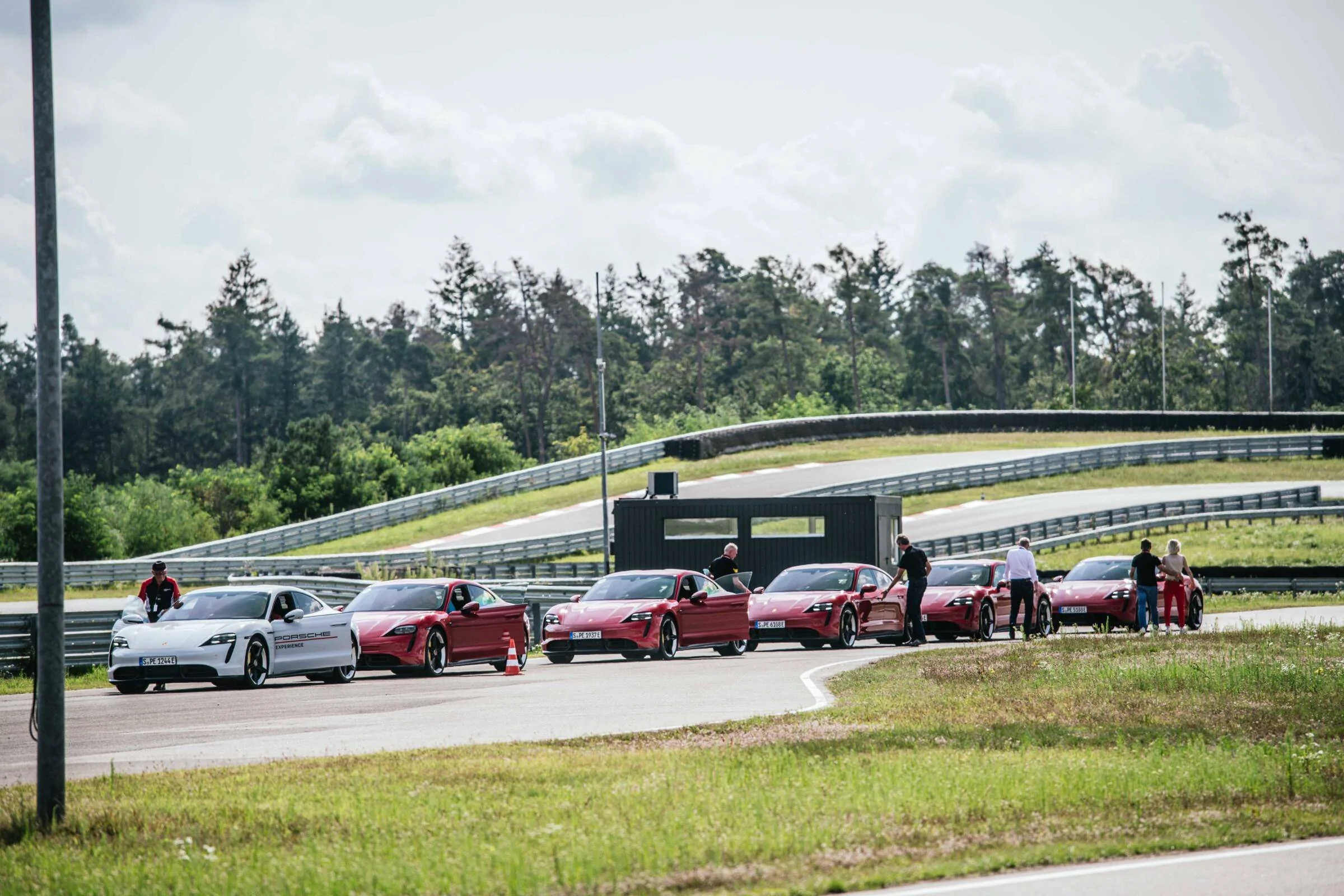

On the other hand as I mentioned (in other same subject threat), I could test it on Hockenheimring back to back on track full day but could not feel any diff honestly (wind or road noise).
Maybe I did too much disco young time, I do not know.
I am neutral, do not have commitment pro/con.
