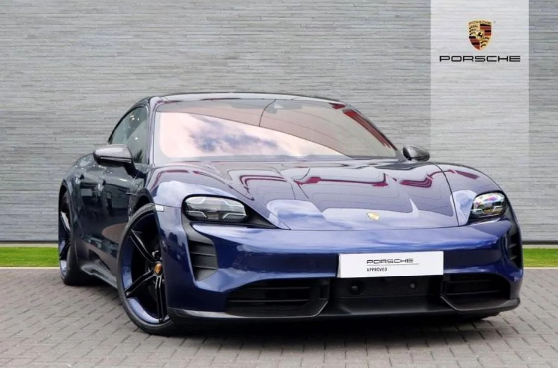

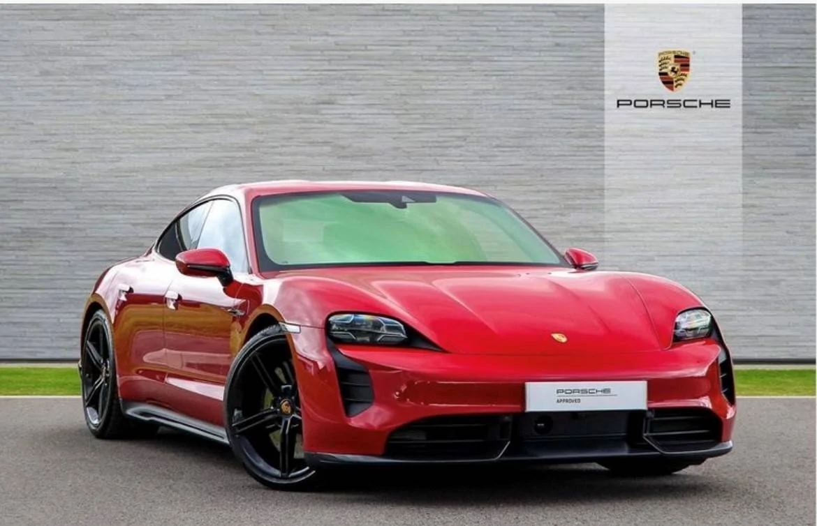

Hi, I’ve not heard about a brown tint. Do you have any pictures. I thought there wasn’t much of a visual difference
Apparently the tint is only noticeable from the outside. Here are a couple of pictures to show it. Different angles highlight it more than others..
Porsche Taycan Insulated glass...? 2
Porsche Taycan Insulated glass...? 1

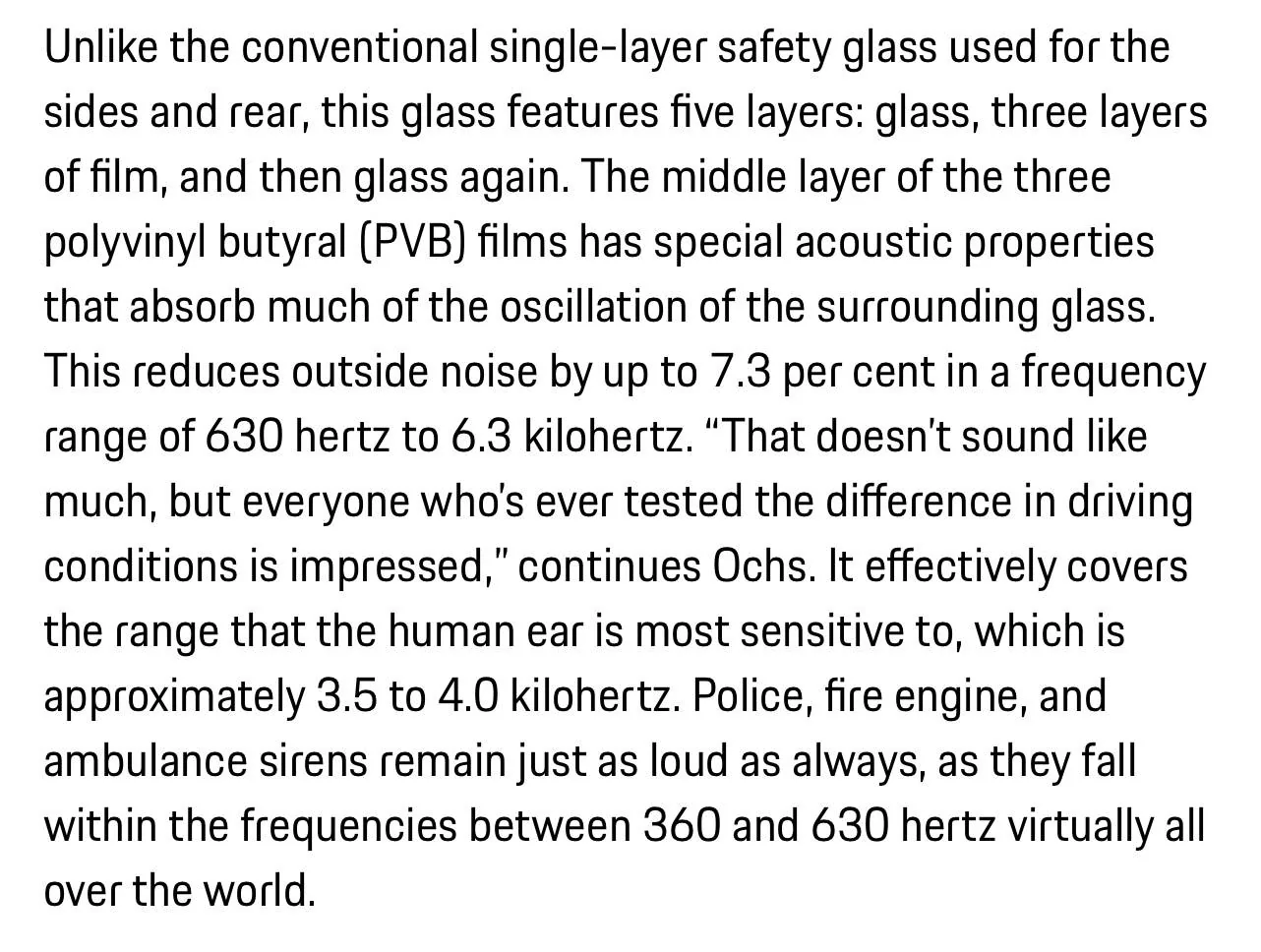

I was adviced against it by the dealer. They said that the glass is effective against wind-noise, but most of the noise in the cabin is from the wheels, where the glass has little effect.
I havent tried both, so have no actual data.
I think Porsche should have data from tests with/without the glass under the same conditions and meassured noise in the cabin in db. The fact that those data are nowhere to be found, suggest, at least to me, that the dealer is right- the dífference is probably limited., so money better spend on other options.
See https://newsroom.porsche.com/en/202...-insulated-glass-christophorus-401-26834.html
